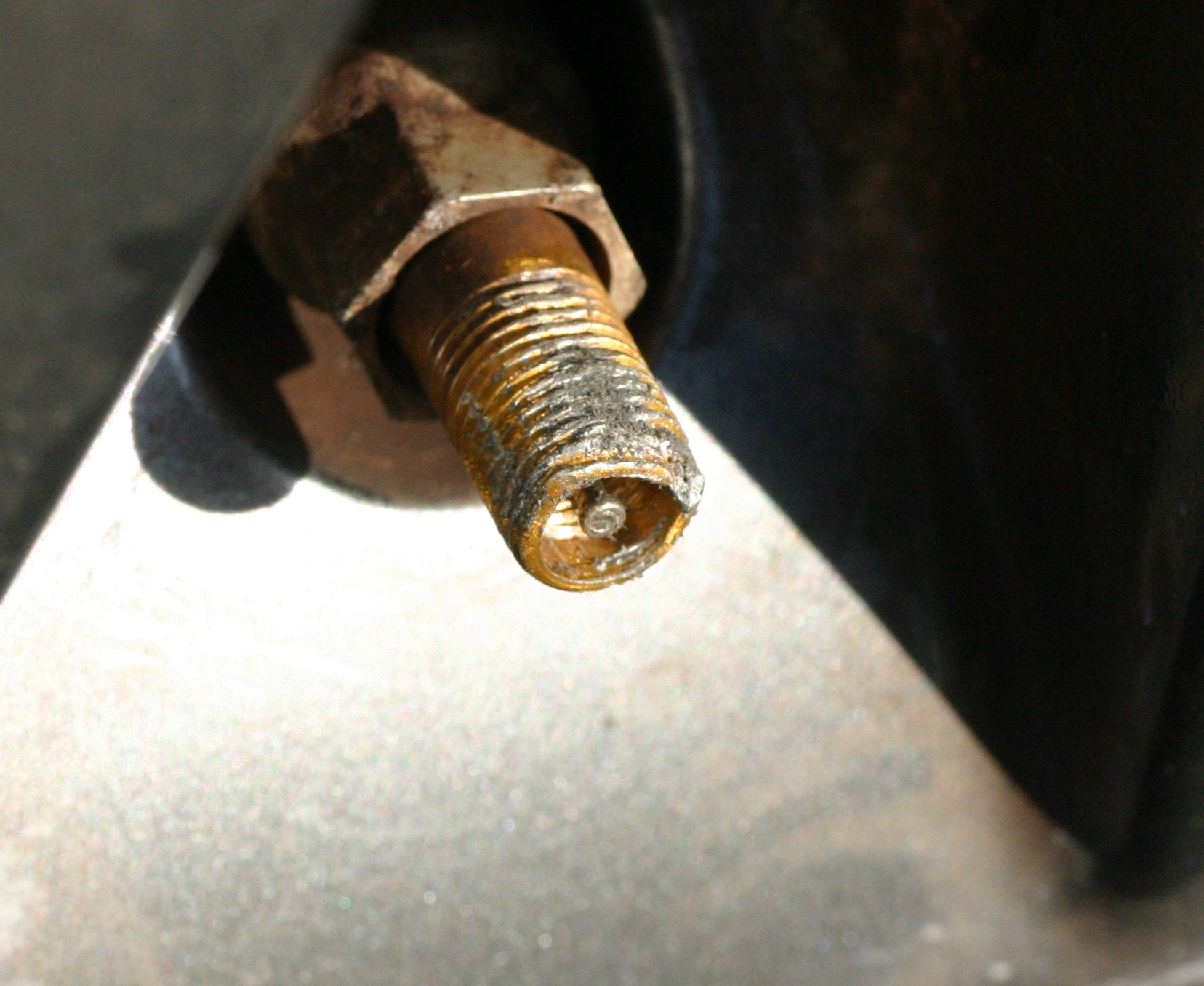

I broke one of the valve of my tyre in which the TPMS is connected. How much is it to replace and is it straight forward changing? in which  I can just go to a tyre garage and have them fitted or does it need to be programmed by Toyota?
the valve broke as I replaced the rubber cap with metal one in which it got rusted and got stuck. Stupidity pays a price I think.
A tyre fitter damaged the thread on the valve of my Auris TPMS  . It wasn't possible to replace just the valve as it is built into the TPMS unit .
A complete TPMS unit was needed and the programming had to be done by a Toyota dealer as only they have the software .

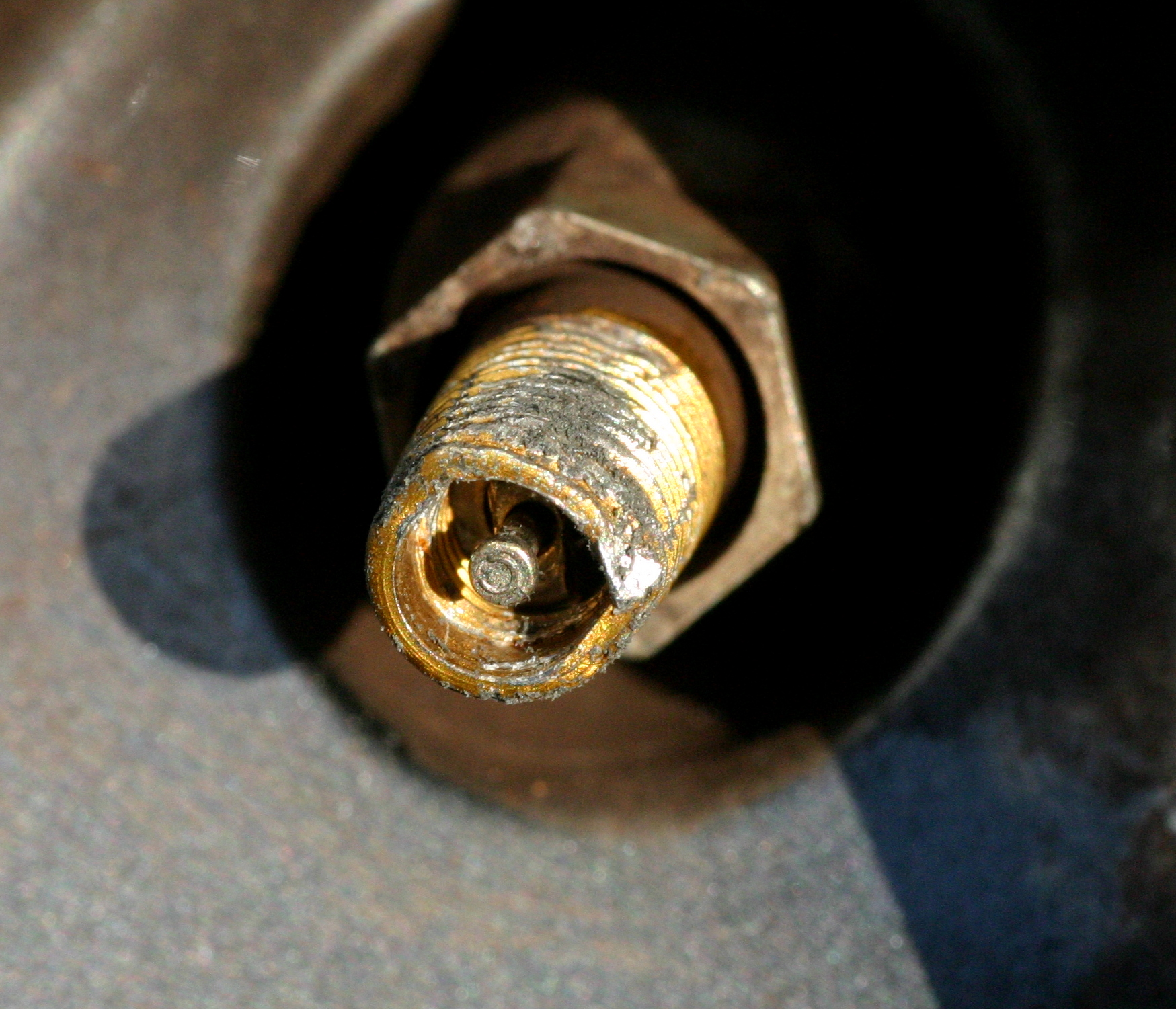

The tyre fiters company paid for the repair and reprogramming but failed to tell me the thread had been damaged at the time .
I only noticed a week or so later when trying to screw on my tyre pump hose .
That  looks terrible for a one year old car, how did they become so corroded ??
Even if the dust cap was missing would not expect it all to look so rusted ... wonder if you have cause for a warranty claim if the other 3 valves are equally corroded ?

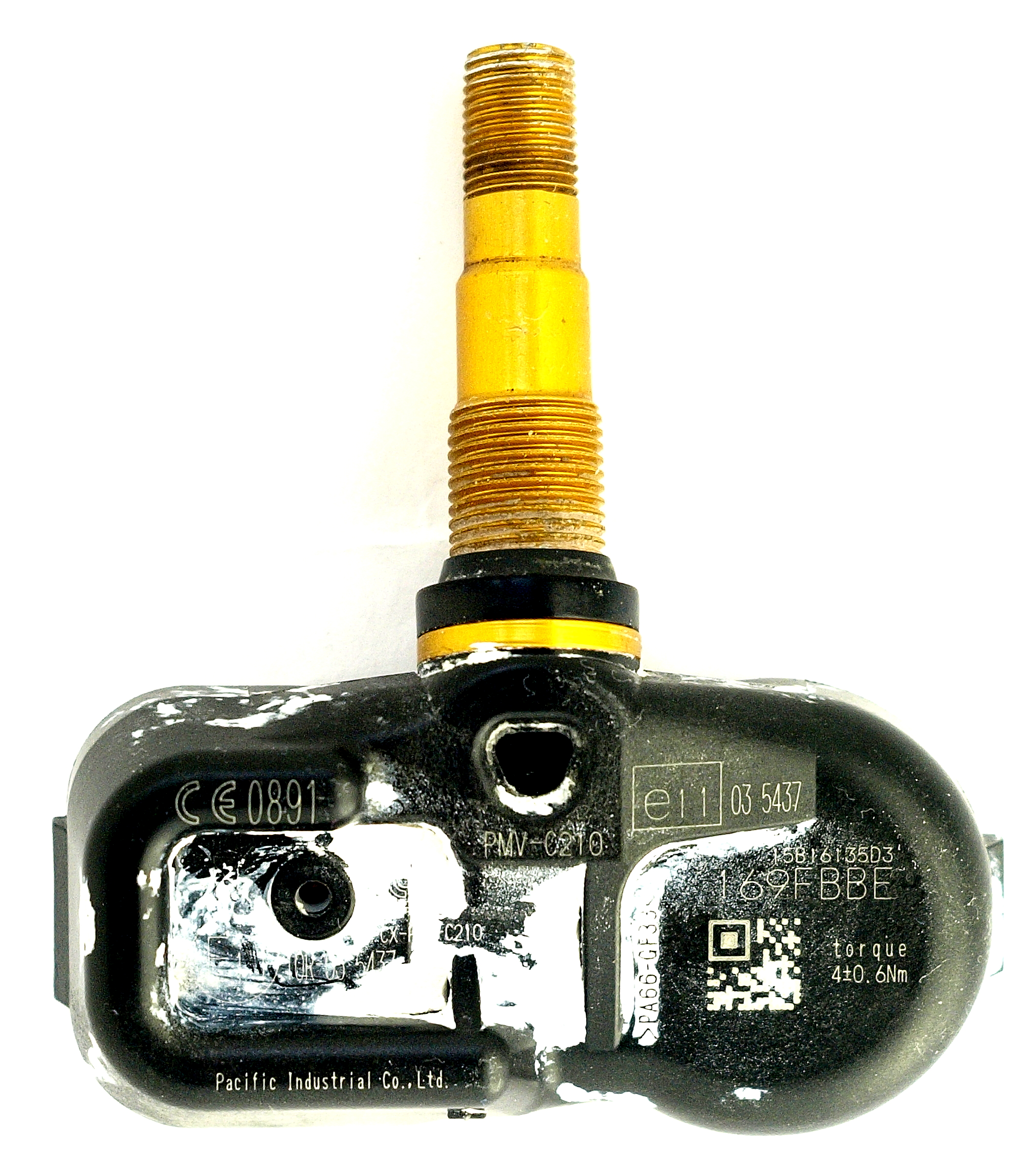

This is the damaged one from my 2016 Auris , it does look as if the valve and TPMS part are one piece .

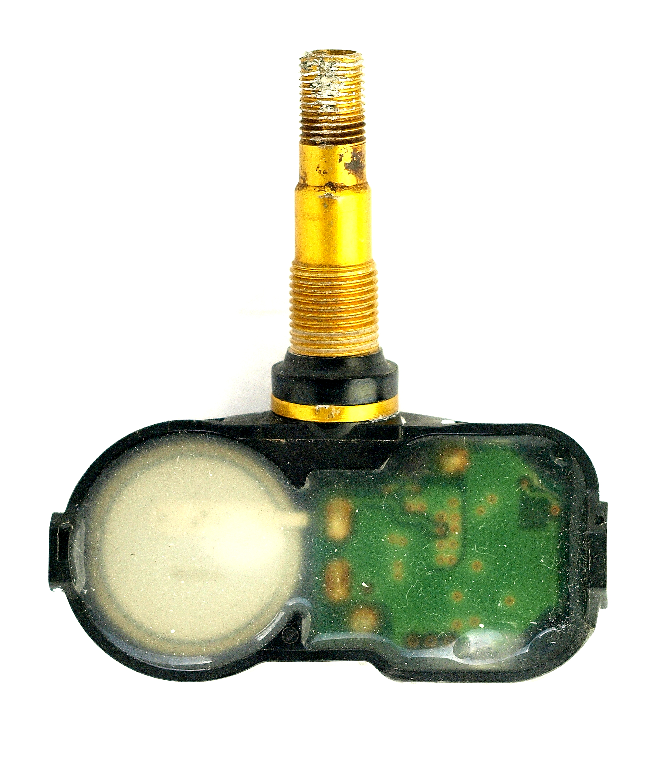

Worth noting that the CR2032 Battery is non replaceable so that when these are low on charge the complete unit will need replacing and reprogramming .
At £92 each + whatever your Toyota dealer charges to reprogram will be expensive for a complete set .
Also beware that if you don't have a spare tyre and use the repair can the TPMS unit will require replacement ( see Corrolla owners handbook )
I'd not really thought about this before and am alarmed at the cost implications. I knew that tyre "repair" aerosols would write them off but assumed that barring mechanical damage and corrosion they would otherwise last indefinitely, with just the Battery and the inner valve core replaced when the tyre was changed. Why can't you replace the Battery? The shelf life of an unused CR2032 is only 8-10 years. How long does the Battery last in service?

The button cell powering this is potted in an epoxy compound - I have an old one in my garage!  The potting compound is not meant to ever come off.

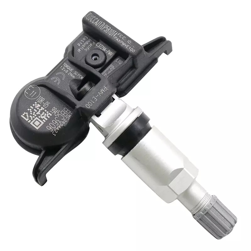

The new Corolla TPMS looks like this. The image above is for an Auris
