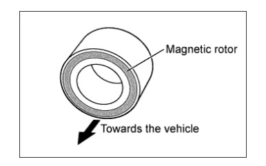

Not quite the ABS ring is integral to the bearing, so the bearing has an inside/outside face, wouldn't be the first time the bearing has been fitted back to front so the speed sensor cannot pickup a signal.
I was thinking of the earlier system, i have seen the magnets shattered due to improper installation tho
there is the chance that it was but it backwards too
As Devon Aygo mentions could the front bearing have been fitted 'inside out'?
If the bearing hasn't been fitted correctly or been damaged when fitting it needs to be replaced - there is a chance that the sensor could have been damaged too
