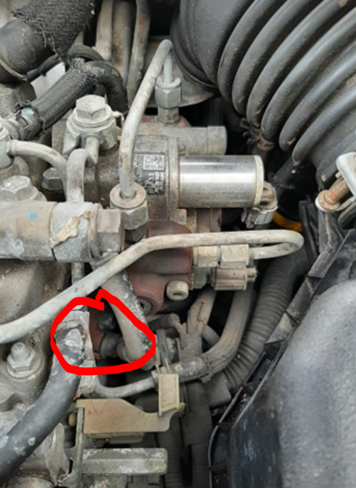

Yes. The 5th injector is smaller and does a different job. You can get it from a lot of places like eBay
It looks like this:
Ingen tilgængelig beskrivelse.
I want to fix it myself but i dont have those advanced tools and my mechanic only has basic tools that cannot reprogram. My only choice is to take it to the dealer but the dealers may charge more than 50% of the car is worth. My cars has driven 330000 km and is not worth much. If i dont need to reprogram the injector i will fix it. But when i took the injector off last week and i just installed it back in without reprogramming and it smoked worse than before for 2 days, but no check engine light. I will see if can find out if it needs to be reprogrammed or not. If it needs to be reprogrammed i might just sell the car to someone that wants to fix it.

Yes. The 5th injector is smaller and does a different job. You can get it from a lot of places like ebay
It looks like this:
Is it easily accessible? Where abouts is it located?

Ok please tell me if your mechanic reprogram it 🙂 . Infiniti it took 3 hours to open it and assembly it again. It was a nightmare to open the bolts and the seals beuase they kept falling in the engine bay so i spent 30 min to find them. It is placed at the right side of the engine and it is in behind the battary. I took the battary out and the air filter tunnel. As you guys can see in the photos it needed to disassembly a lot of stuff. If you guys do this you need a lot of tools to reach those bolts deep in there and please be gentle with all the wiring so they dont break. If you guys want more photos of the process i can send a file with all photos and instruktions of the process. Here is some photos:
