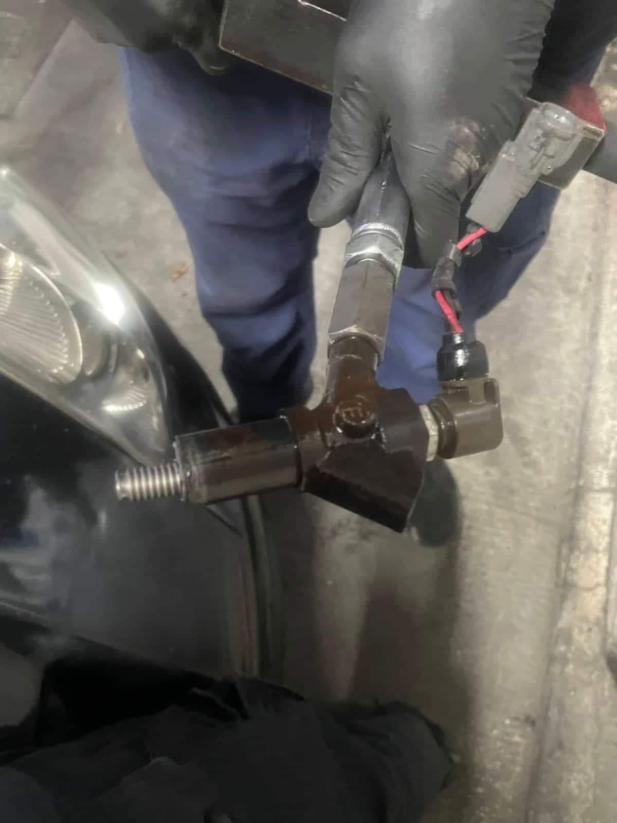

Despite the sensor being bad and the DPF delete being done to the car the car wasn't running right and we pulled the injectors out and found that 2 out of the 4 were bad and one of the two was so bad that it leaking gasses through the copper seal and essentially my car was loosing compression because of it(it formed like a carbon seal and it was stuck and snapped in half when we pulled it out).
Anyhow we changed all seals and 2 injectors and finally it runs like a dream.

Did you by any chance get a photo of the injectors? Did you have to replace them, or did you manage to get them restored?
They told me that they couldn't restore these kind of injectors and instead they had put 2 used ones but in very good condition.
I only have a picture of the snapped one
