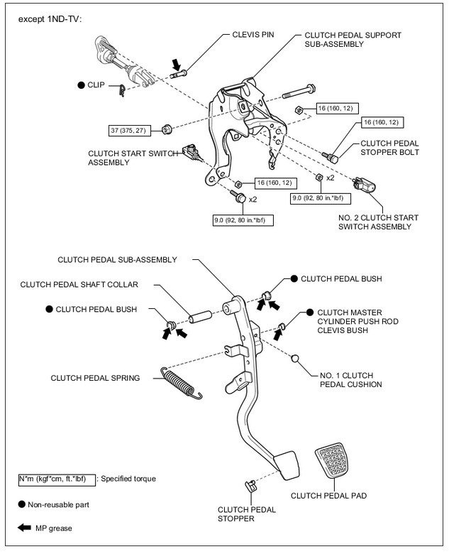

I think you will find that one switch is to allow starting, the other is to restart after stop/start has stopped the engine.
Thanks for the pics Bob, I'd forgotten all about the second switch, dooh!  No stop/start on my 1.33 so the lower switch purely does the 'press the clutch fully down to start' thing and can be easily defeated as happened to the OP.
I still think the ECU uses the other switch to know where the pedal is to improve gearchanges (which it makes a horrible job of).  On VW's, a faulty clutch switch can lead to snatchy gearchanges, and sometimes high idle speed too.  As an experiment, in the past I have tried driving mine with this second switch plunger taped in, and then with the switch removed from the pedal but left connected.  This was all in the past in an effort to improve the well known throttle hanging business.  Oddly enough neither had the desired effect but adding a couple of washers under the switch did as I described here.  It's still not perfect but I'm putting up with it.  One thing I have noticed is that it is tharms.t it improves as the engine which intrigues me.  I still haven't got my Techstream cable working so I can't try and check the coolant sensor or much else.
Note - The second (upper) clutch switch isn't a safety device!  That's the lower one.
