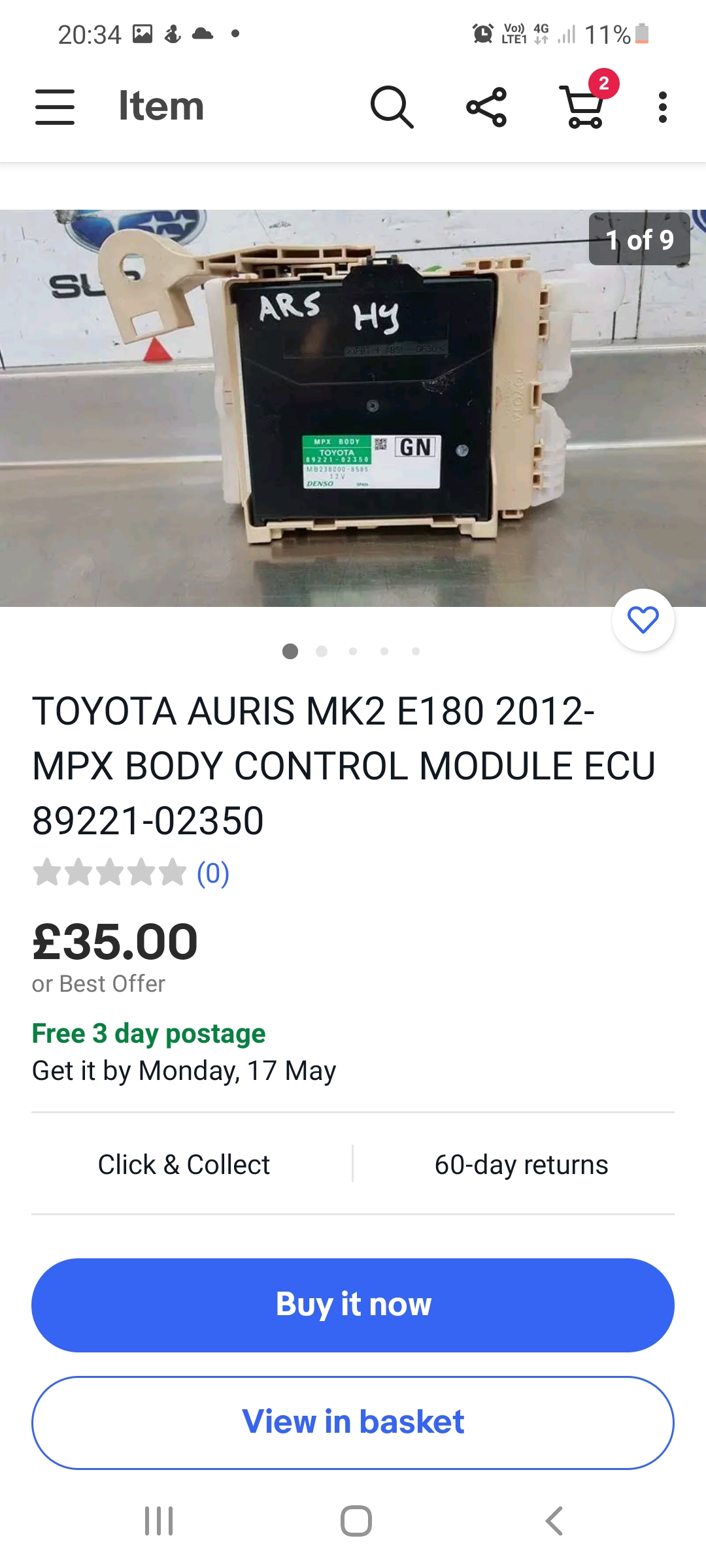

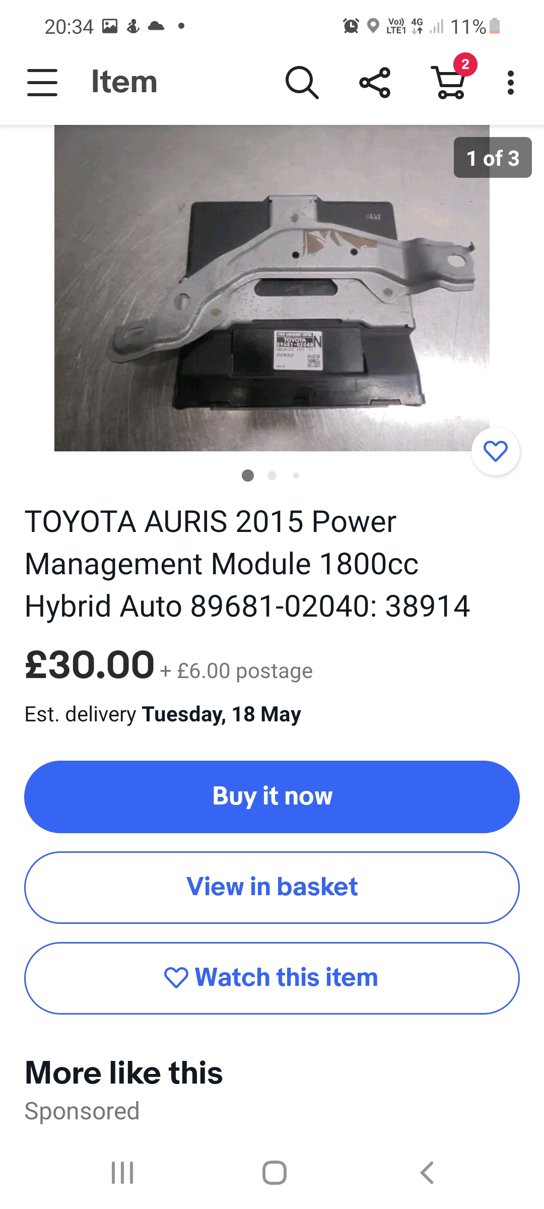

Hoping for some good advice on my 2014 1.8 Auris hybrid. I've had water damage and found some corrosion on my power management ecu and mpx body control. I'm hoping rather than buy new to buy these second hand units off eBay (Same part numbers)
1 - Are these interchangeable as long as same part number?
2 - If you can use used, do they have to be coded in?
Attached pictures are the parts I need
Thanks in advance

Thank you for the response guys. The damage occurred from a dodgy windowscreen being put in. The original faults 11 months ago were immobiliser, mpx body / cream holder, and power management ecu. Since then using the diag tool I've cleaned the connections on the immobiliser and fault code gone although it won't let me programme in the second key.
The car doesn't start at all just says shift to P.. I Opended up the MPX and power management and there's some blue on the connection and also inside the box.

I'll give that a go, thanks. It seems copper corrosion, crash bar / brackets have alot of surface rust so must of got fairly wet. Will be interesting to see if same part number if they are interchangeable. I've ordered the ones stated in first post and will keep everyone updated once they're plugged in and plugged into toyota software.
