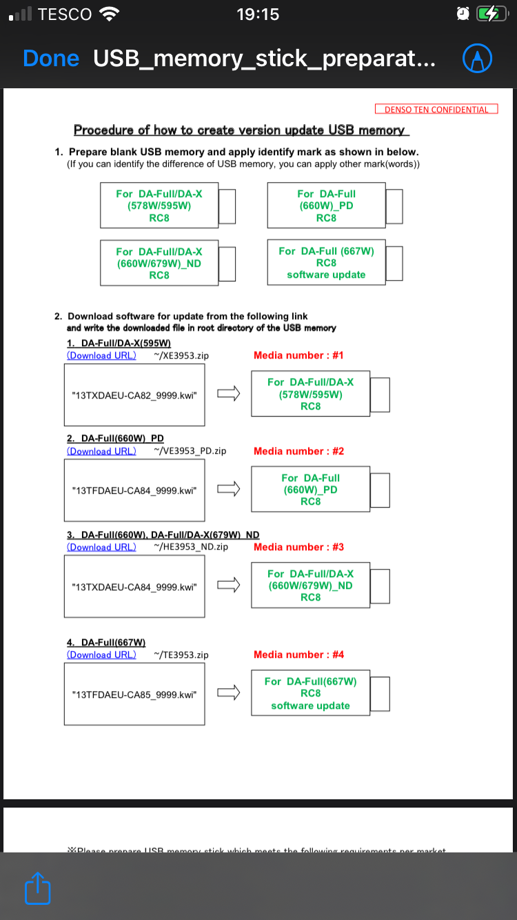

Here’s the problem I’m having flash22
im clicking on number 4 to download but nothing is happening?
If you have downloaded the link i sent, you don't need to click on that link in the pdf as you already have the .kwi file - you need to do this on a pc
format an usb stick (under 16gb in size) in fat32 transfer the 13TXDAEU-CA82_9999.kwi file to the USB stick
put the USB stick in car, start the car or put it in ready mode (hybrid)
the radio should detect the update
How long does it normally take to pick up the update please? I’ve done everything that you said and I’m now sat in the car with it running and usb in ?
