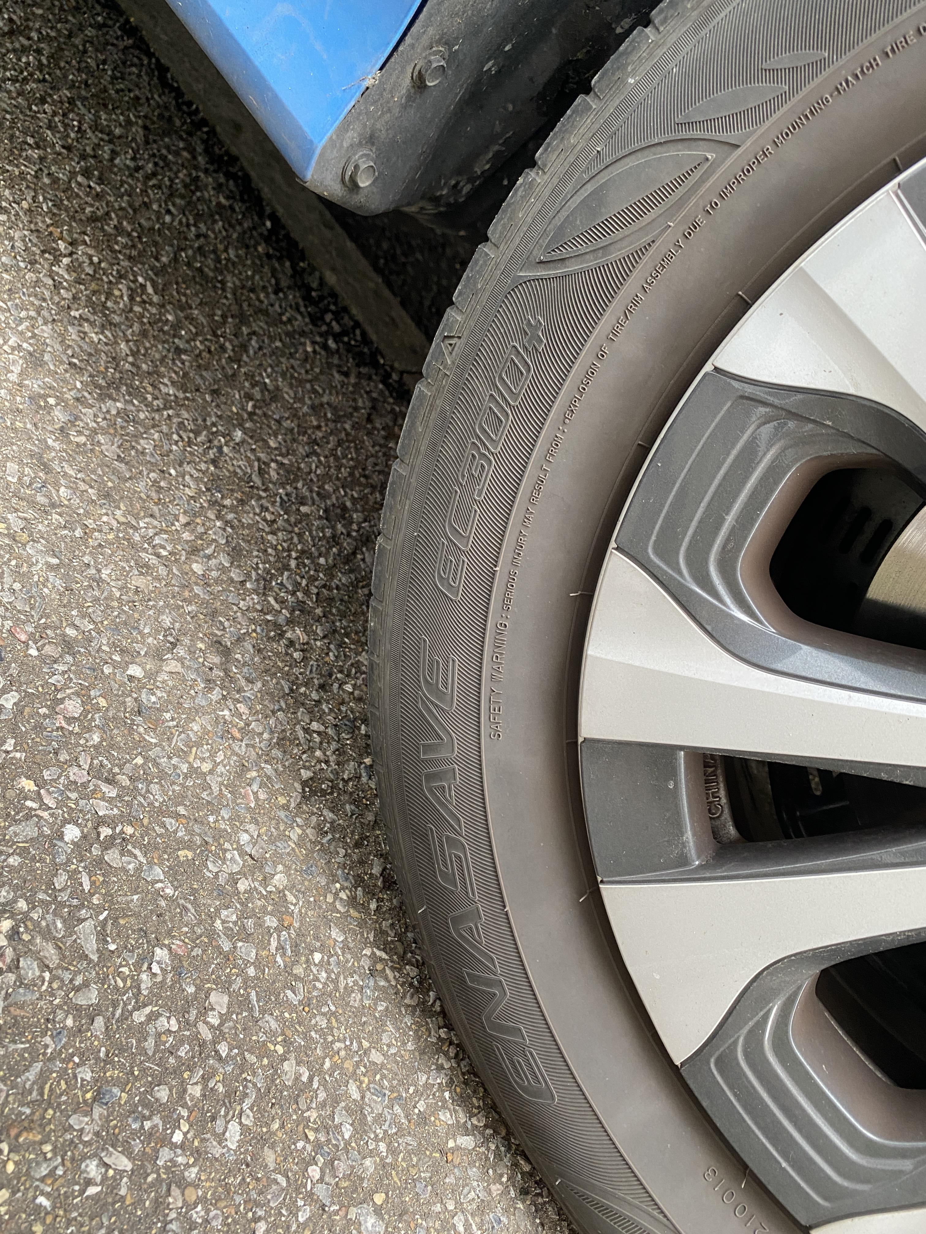

Having had a number of squiriily moments and a lot of wheel spins, I have finally given up on the tyres supplied with my 2019 Prius. The tyres actually feel dangerous at speed on wet roads They have done less than 14k miles and are still at 7mm tread. Before anyone asks , yes they are inflated to the correct pressure.
Has anyone else had bad experiences with the Dunlop Enasave EC300+ 195/65r15 91H ?
I’m swapping these for Dunlop BluResponse in the same size.
These I had on my 2016 Prius for years with no issues.

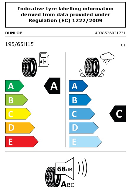

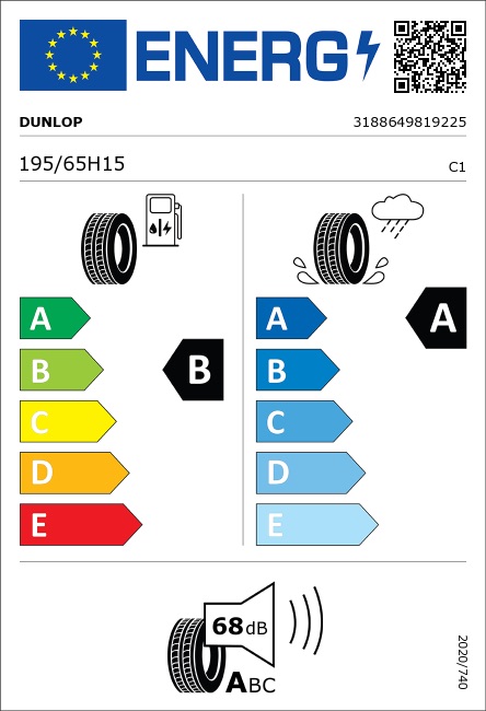

Back to the OP.  Both tyres quoted are rated B economy, A wet weather and 68db noise.
Agreed. But I’m getting great fuel economy anyhoo. And not feeling like I’m going to nerf the car in heavy rain on a busy M25 is more valuable than 2-3 extra mpg
the Enasave is rated C wet weather
BlueResponse is an A
As regards the tyre labelling:
Wet grip - the difference between each rating for wet grip is approx 2.5 metres when braking from 50mph.
Fuel economy - the difference between an A rated tyre and an E rated tyre may be only 7.5%. So the difference between each rating may be 1.5%.
Update:
New boots on. Certainly is more planted and no sway or lumber around roundabouts and the sideways leap on certain bumpy corners has disappeared.
I am seeing no loss in mpg at all and certainly stops more responsively.
as a side effect (and there are scientific articles that back this up) my daughters car sickness has gone away. This is the first car that she has had it in. The Enasave energy retention must have been high.
