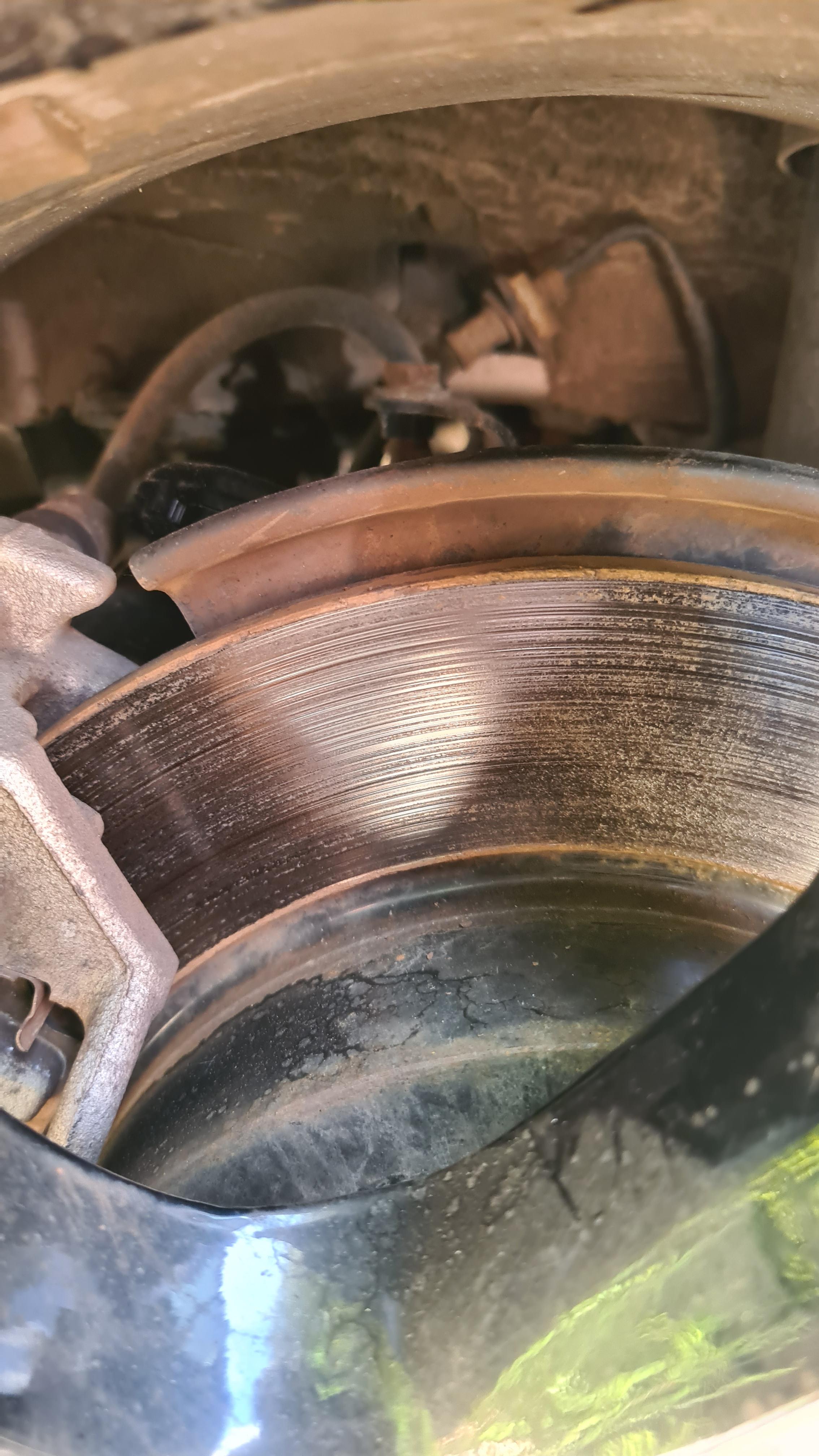

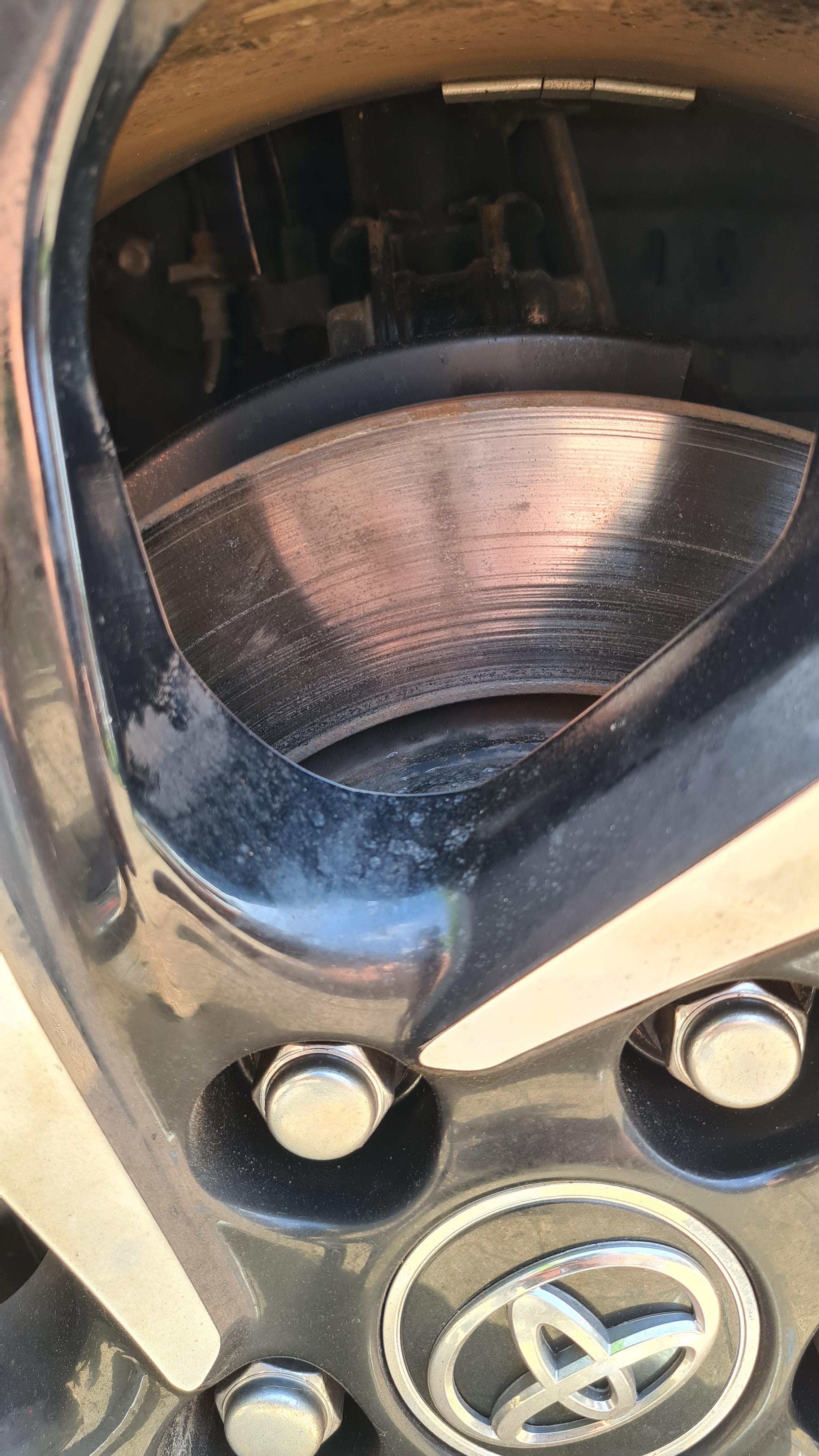

Hi, my c-hr is at 30k miles and I am a bit concerned about the condition of the brake discs. Please see the attached photo. During the vehicle healthy check toyota said they are fine but just rusty. The lines are not scores but rather high ridges. Any advice would be greatly appreciated. Thank you

I should add that the braking performance is not affected and there are no noises etc. Many thanks in advance.
It is common with Toyota hybrids that the brake discs show up rust. Due to the nature of braking on a Toyota hybrid, the actual brakes are used less then in a non hybrid car. The hybrid part of the car uses itself to slow the car down initially, more pressure on the brake pedal will bring the actual disc brakes into operation. This means the pads should last longer, but the actual discs will show rust signs and can actually prematurely end the life of a disc if it gets really bad.   Best thing you can do, but only when its safe and no other vehicles about, is to brake very hard with continued pressure, This will help to keep the discs free of rust.  Likewise, after a downfall of rain and your car been standing for a time, when you drive off you may hear a grinding sound, again this is the light surface rust that has been formed being rubbed off.
That's how the hybrids are, a slight lip on the disk but nothing major, the rears don't get much use - if you're doing local runs and short journeys they never get the heat in to them

Hi,
the rust that accumulates on the outer side of the brake disc is because of the brake pads not able to clamp with enough force to clean the friction surface caused by stuck slider pins and rust.  Hard braking will not help I am afraid and with the time the brake discs will become worse. Best to prevent that from happening is to do a brake clean and lube every 2-3 years or if you drive a lot on yearly basis. If you only do that without changing the brake fluid it’s a simple job and easy done as diy, all you need is to take the pins out clean and lube with silicone grease or Toyota pink grease available from dealers. Since hybrids use most of the braking force provided by the e motors the brakes are cold and can not evaporate moisture and water and these find its way into the pins and they get stuck more than in any other cars. Low mileage cars in general suffer more from that than the cars been used every day. Nothing to worry for now and simply clean and lube service will extend the life of your brakes.
