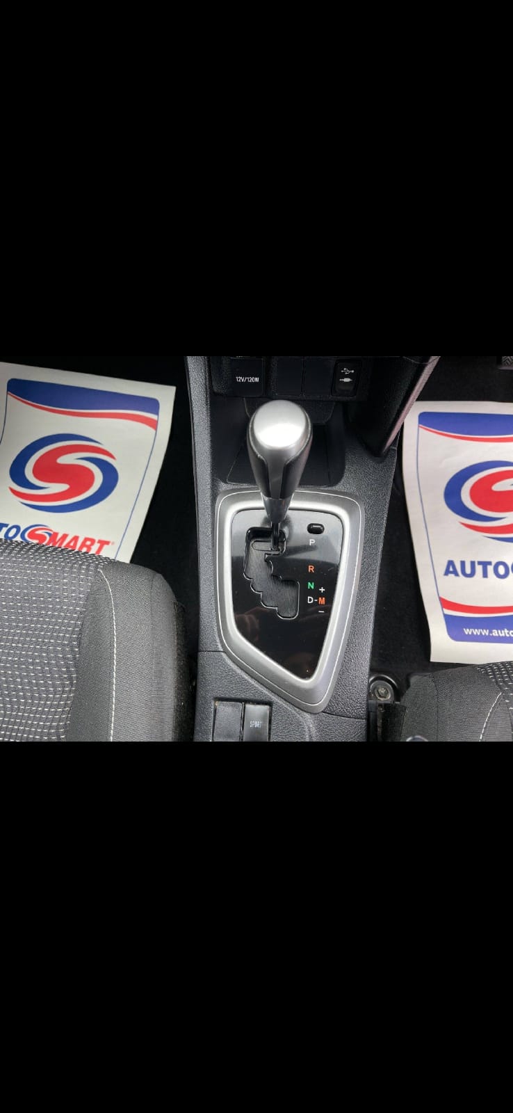

I have checked the manual and couldn't find. The one in the automatic gear box near to parking p Iam talking about. Thank you
Photo, to save confusion, please

I have checked the manual and couldn't find. The one in the automatic gear box near to parking p Iam talking about. Thank youIMG-20210604-WA0020.thumb.jpg.79521f8941965e79f9977eb5b2b6b4bf.jpg
Pretty sure it’s the shift release for the Multi mode transmission. Is there a diagram on page 683 of your manual? If not, check the index under ‘multi mode transmission’. My 2014 model is a pre-facelift one so your manual may be different .

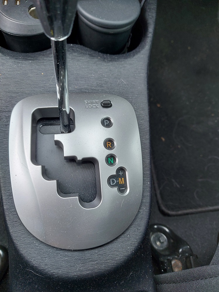

They've been kind enough to identify it on mine.

Actually, looking more closely I think the original author's transmission is a Multidrive - the diagram on page 682 of the manual looks more like his photo! Apologies for any confusion I've caused.

It looks as though the selector arrangement is slightly different for the Auris.
I could be wrong, I usually am, but I don't think, from memory, the MMT (Multimode) has a "P" position.
You’re right, it doesn’t, according to the diagram in the manual.
