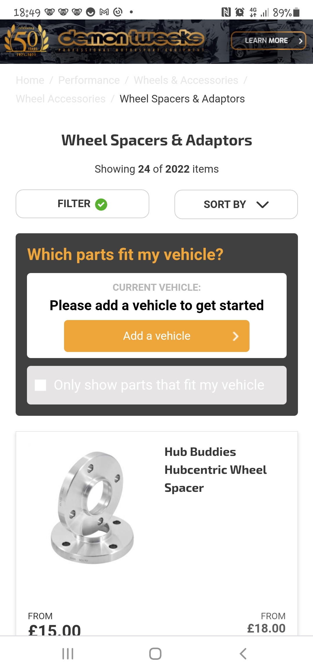

Haven't you asked this already, what is the PCD, E.T., rim width and center bore of the 5 stud rims ? you will have to watch the width of the rim and allow for the e.t of the spacer/adapter
By the time you get the wheels, add the adapters you might as well get the same style of wheels in the correct fitment rather than going through the headache of geometry issues and knocking out bearings, not to mention the tram lining, and tire scrubbing
you never cheap out on adapters, these are the only thing holding your wheels on, you're looking a £100 a pair ish for H&R and the like
