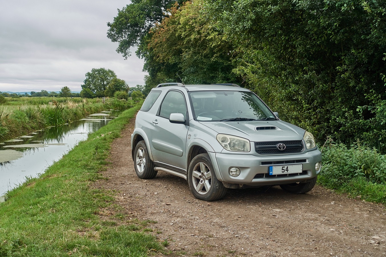

Pic of the offending article, just because!
