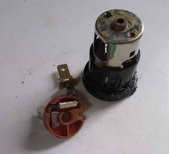

 Finally got the thing out.  Turns out there is a small component within the socket(which is now open circuit)
The voltage measured on the connector which fits the socket is OK.
Some kind of over-current/over-heat fuse . One end is joined to connector, other presses against body of socket to make connection.
