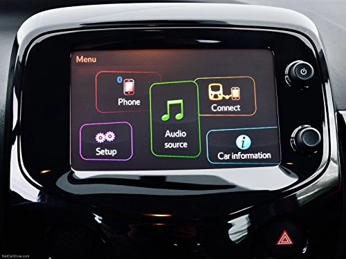

On the pre-facelift models (prior to mid 2018) with touch screen multimedia (X-touch), there was a sat nav module (called X-nav), etc you could install.

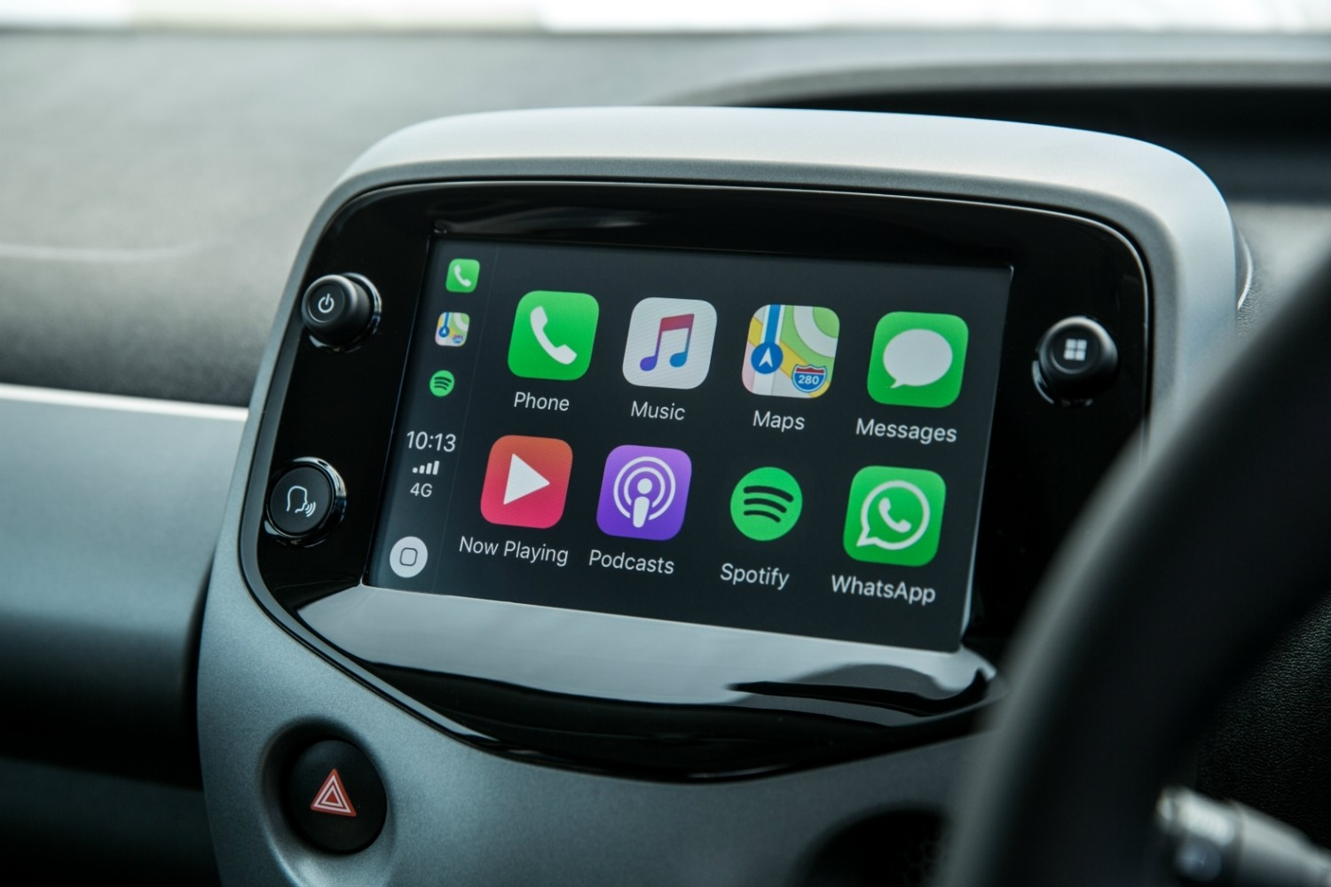

On post-facelift (from mid 2018), the sat nav module was replaced by multimedia units with Apple Carplay and Android Auto.  The older multimedia units had two physical buttons on the fascia, whereas the newer units with Apple Carplay/Android Auto have three buttons.

Old version without Carplay/Android Auto:
Later version with Carplay/Auto:
If you're swapping a touch screen unit for the later unit, should be plug and play.

It is a straight swap.  I took the sat nav 2 button touchscreen out of my daughters 2014 Aygo and replaced it with the 3 button carplay/android auto unit.  Because the previous unit was the sat nav version, you have to unplug the sat nav module behind the unit in the wiring, took me a whole hour to figure that out, as it will not work without doing this.
