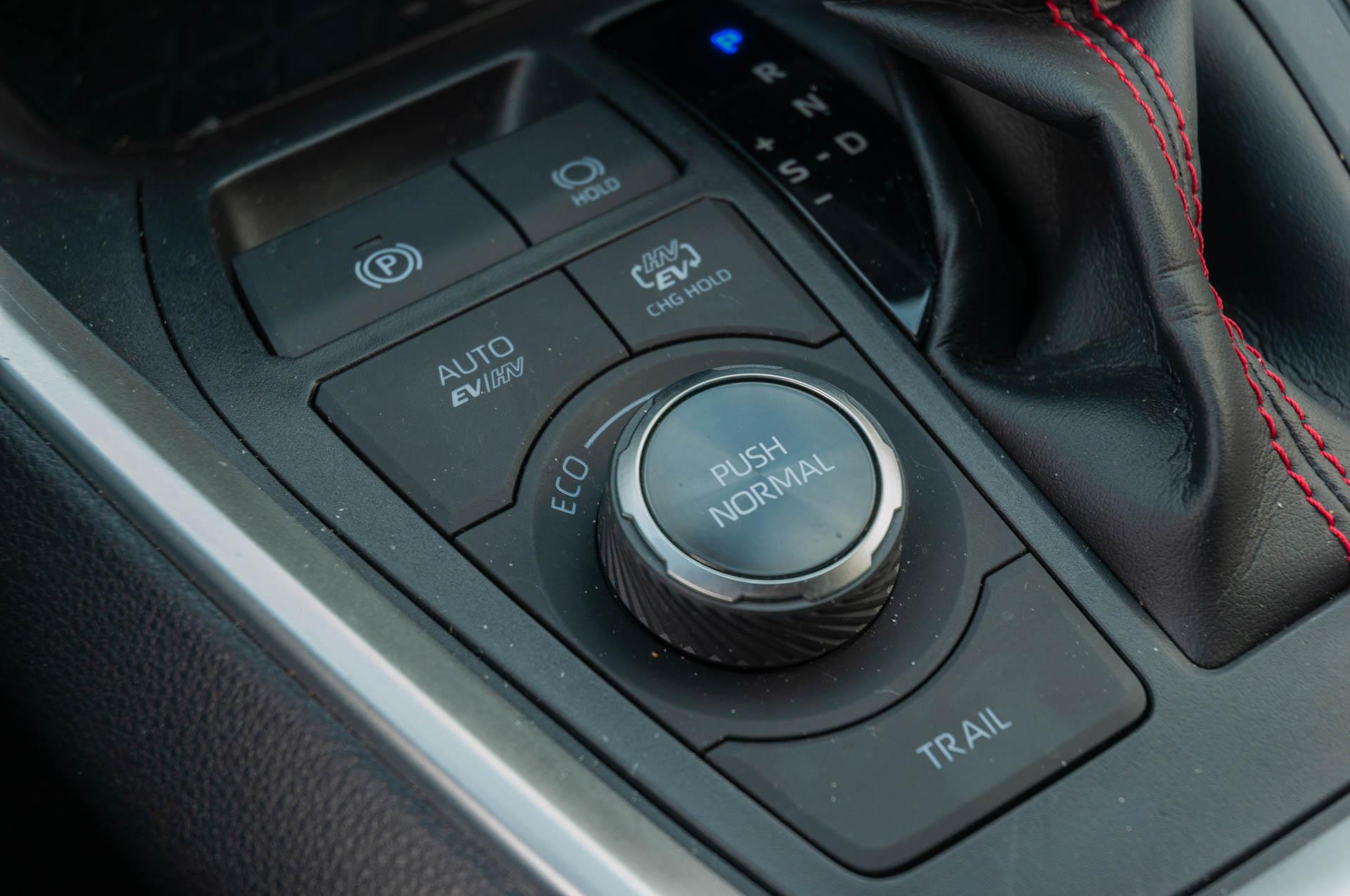

Yes it is, you can 'hold' charge to use it later or allow the car engine to charge the Battery.
Don't forget, unlike most PHEVs, the RAV4 will still act like a HEV when the Battery gets a lower level giving you the advantage of respectable MPG....
A picture of the magic CHG Hold button:
Taken from a US source so a LHD car ...

The charge hold mode will charge the Battery to around 80% full but remember that 30% of the Battery is reserved for the hybrid mode.  I believe that this charge hold mode is not a very efficient.  I’ve used it when the traction Battery is low and I’m just a few miles from home.  I’d rather use the charge hold mode early and have the ICE fully hot than it just come on a few minutes before I stop the car.
