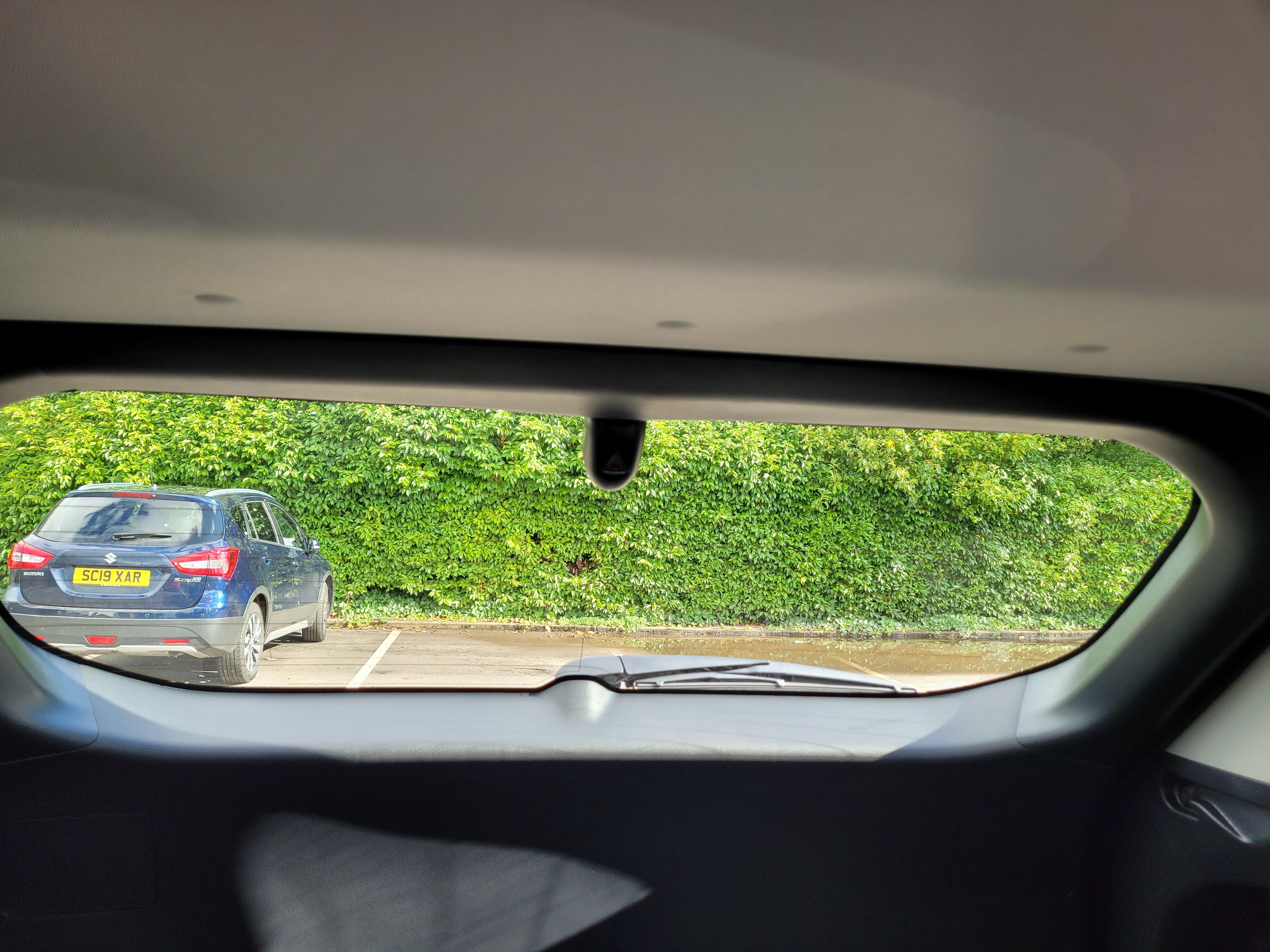

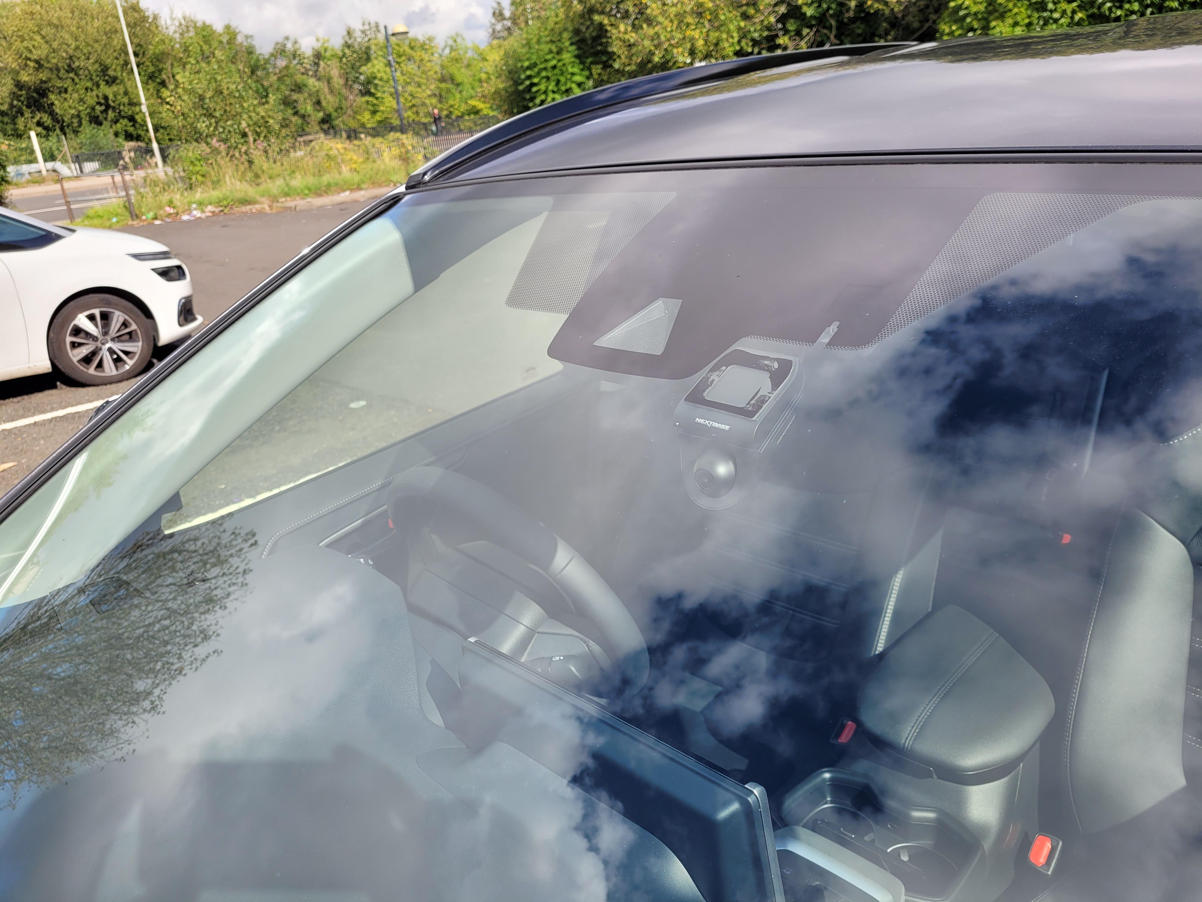

@ernieb  My front and rear dealer fitted dash cams  if helps.
ignore batman! (car seat)... but that's the view I see from driver position.

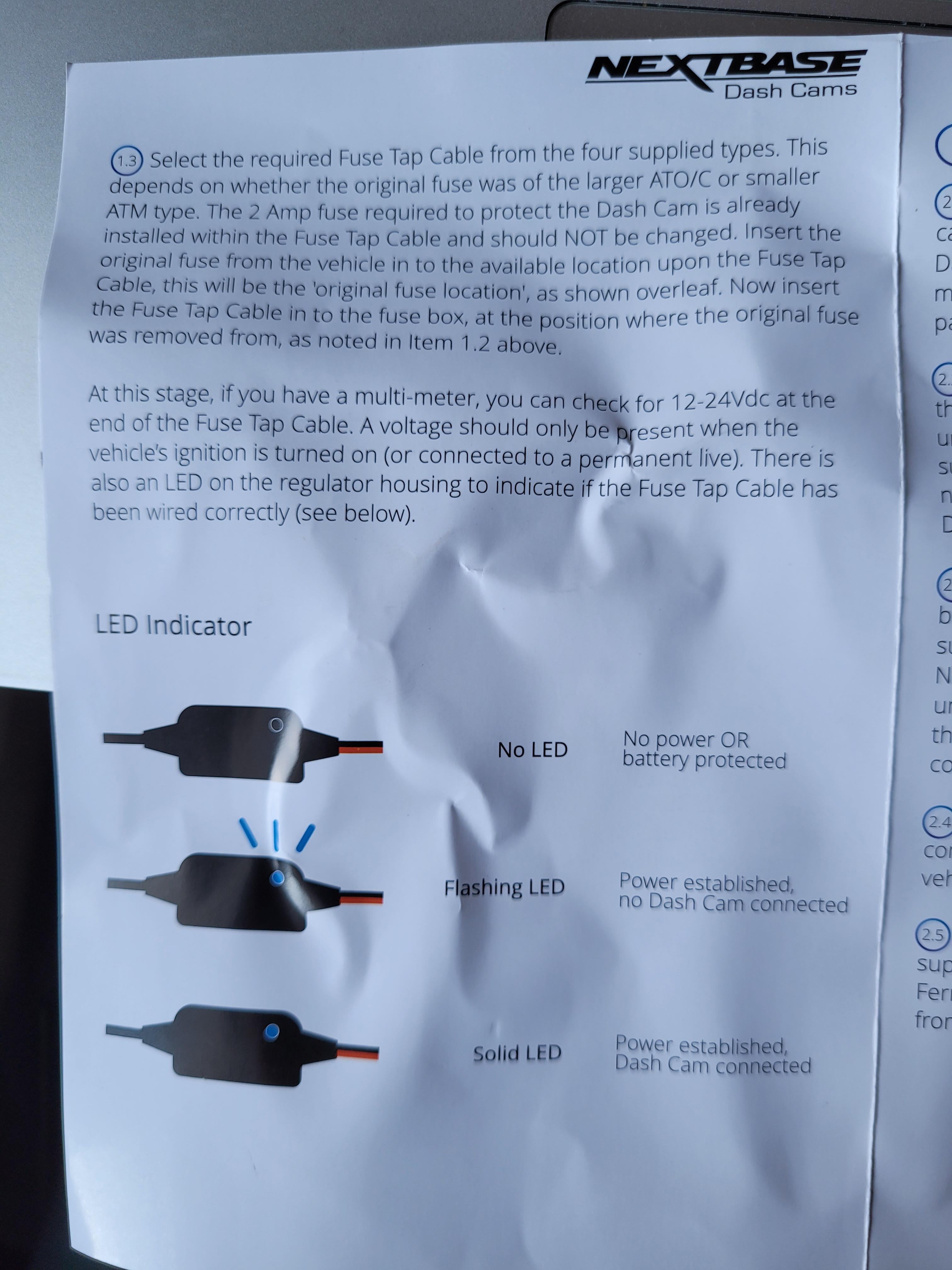

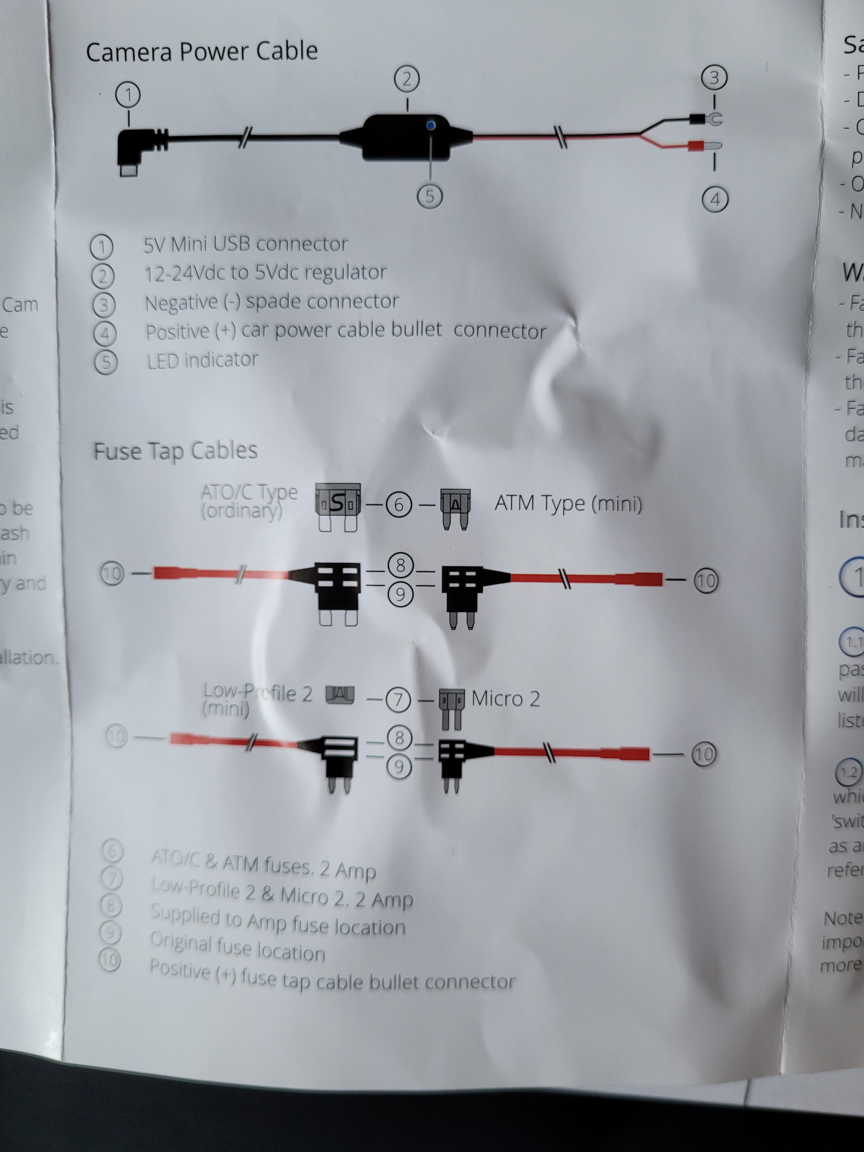

I swithered, a lot, about the Toyota fitted Dashcam. Turned out they were on VERY extended back order anyway(and atributted to Brexit) so I festered some more before ordering the Nextbase 662 c/w the seperate rear screen mounted camera. Ordered direct from Nextbase, since no cheaper elsewhere.
Which kit I fitted myself(sweating blood while prising off the brand new trim panels, especially the airbag marked one down the "A" pillar btw) successfully and safely hiding all cables and powered from the ciggarette lighter socket through the thoughtfully Toyota provided pinky sized access hole. Slightly tricky feeding the cable up through the rubber tube/grommet to the hatchback for the top/centre mounted rear camera, but a sniff of WD40 worked wonders there.
Front camera fitted to the passenger side of the screentop cluster, and totally invisible to the driver, which is a slight(and recognised prior to installation) issue, i.e. "is it on, is it working anxiety"
Zero interference to DAB signal either.
And superb quality with fully functioning bluetooth to our cheapie Motorla Android phones.

Thanks for this, that must be why dealer fitted mine in pics previous posted v where I wanted it (driver side!)
