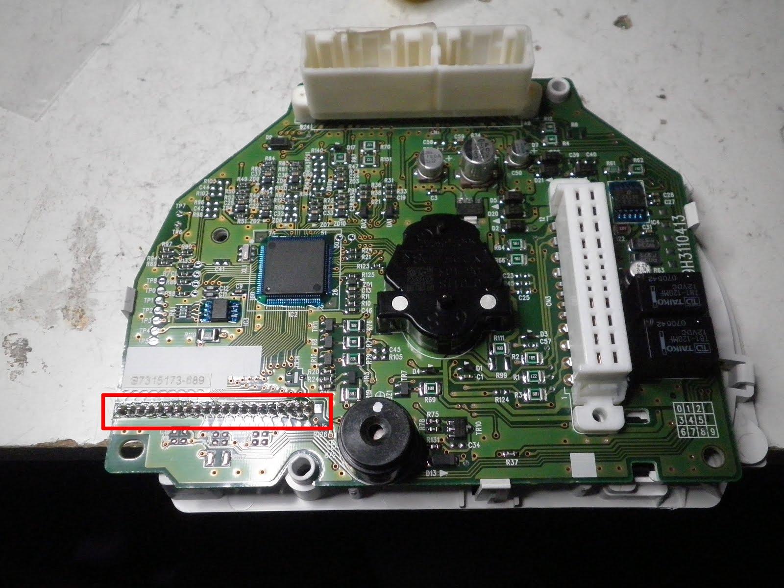

I've just checked the wiring diagrams for a Mark 1 (which will include a 2012 model) and there are NO relays on the indicators - they are driven directly from the combination meter internal circuitry.
That the RHS ones don't flash when the hazards are turned on to me suggests a wiring problem.

The 2 relays are internal to the cluster and are soldered to the pcb
Pic courtesy of Andydoz (relays on the right)

No, see post above by @flash22 the relays are soldered onto the circuit board behind the speedo.
