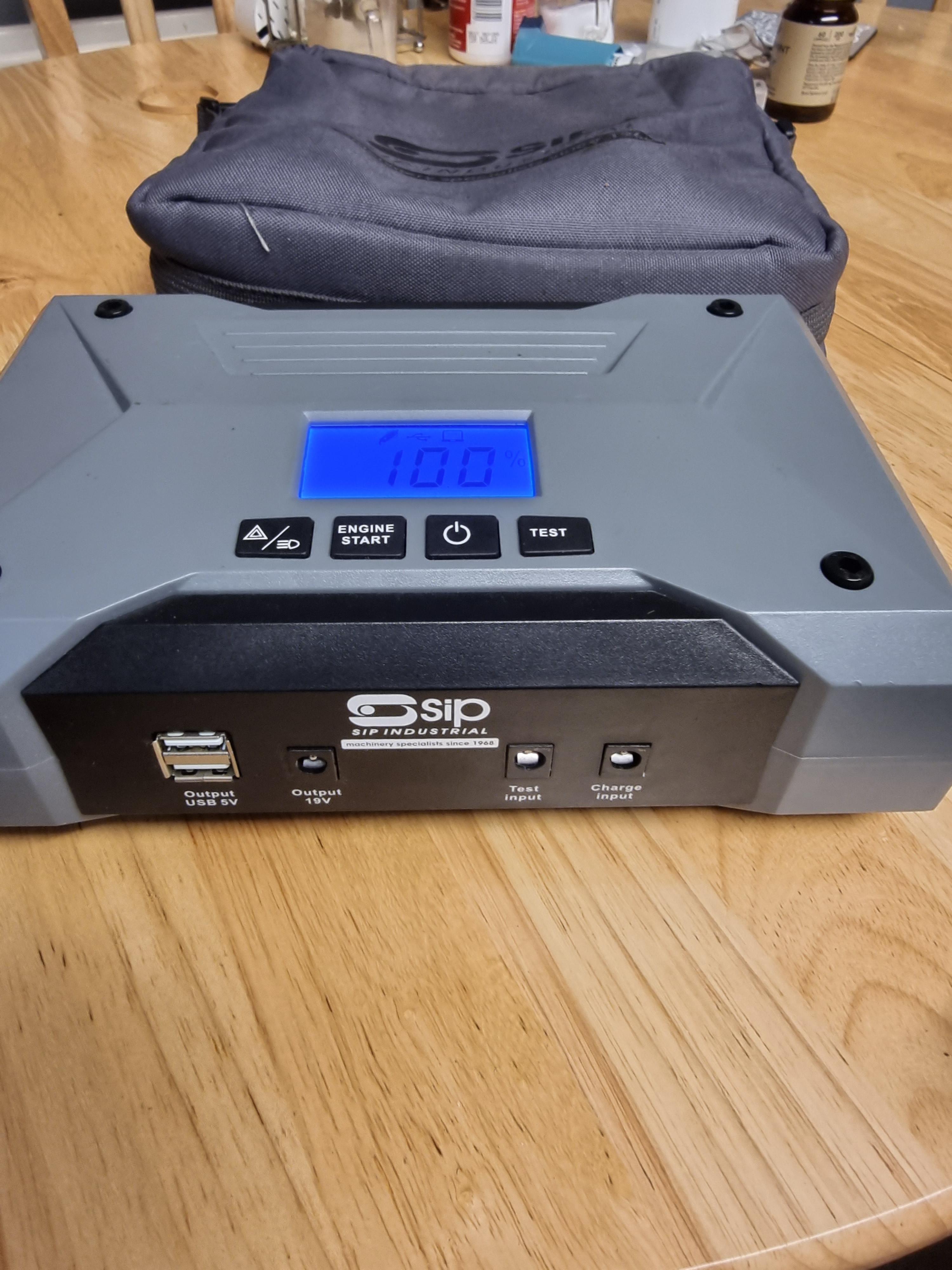

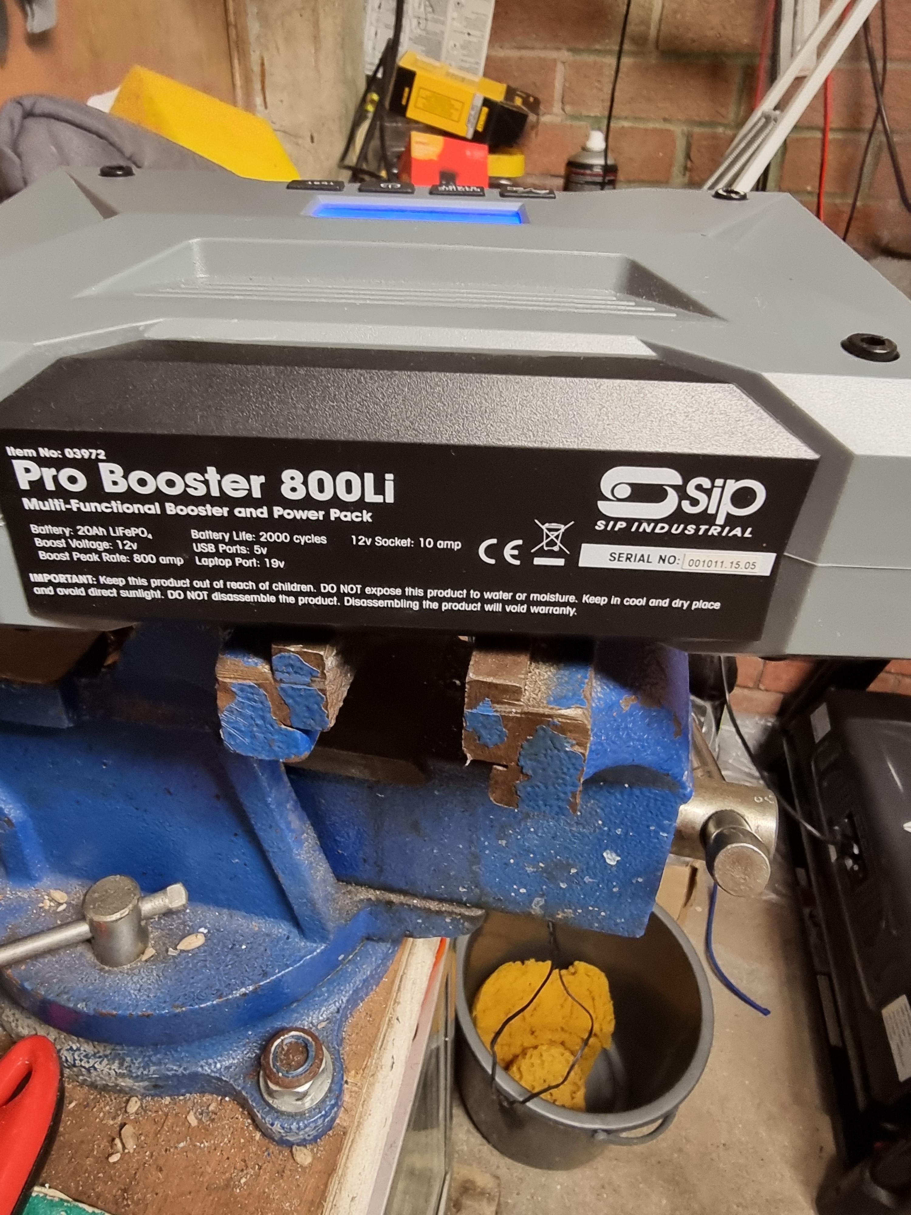

think a a man said only 300 battery in them easy run down20210825_200540.thumb.jpg.e0ce6c778abfea82f89375614ebf7d70.jpg20210825_200649.thumb.jpg.b546a95d85f1f91d4be7d473de1f203a.jpg

going to take this with me from now on hope this will start rav.
