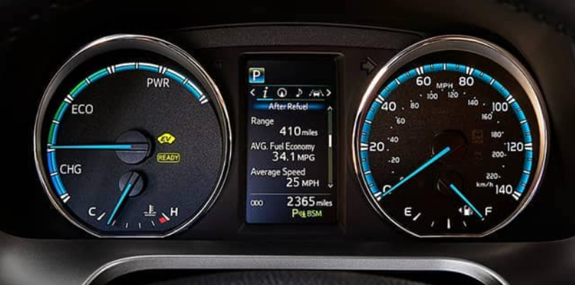

If anyone has a 2018 model in the UK, petrol electric hybrid, automatic, it would be great to see a photo of your dash to see if it matches mine.  That way I might be able to get the right part number to order.

As you suggest, it may help if you post a picture of your dash and the part you want to replace ...

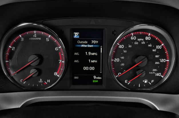

Edit: does your dash not look like this?
I did a little more research, and yes, of course, you meant speedometer rather than odometer, and you stated in your initial post the you needed to convert from KPH to MPH.
The only requirement when importing a car from Ireland to the UK is to ensure that the speedometer gives the car's speed in miles per hour - because the speed limits across the UK are stated in miles per hour. As in the picture above (from the US as it happens) UK speedometers provide a dual readout - MPH in bigger digits; KPH in smaller digits - which is useful when UK cars are driven in the EU etc. If your car's speedometer provided a dual readout you'd be fine - the car is already right hand drive - and there'd be nothing more to be done.
But, for some unfathomable reason, the Irish appear to have elected to have kilometre only speedometers on newer cars - older cars were in MPH with KPH as a dual readout as per the UK. I suspect this is the challenge that you now seek to address.
