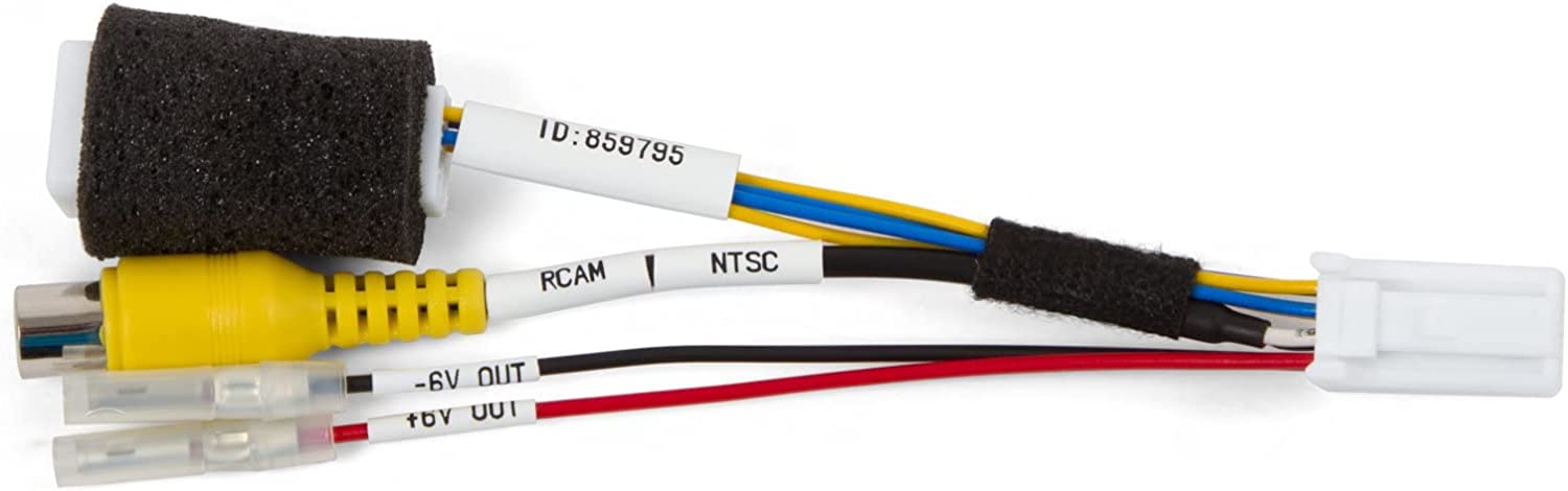

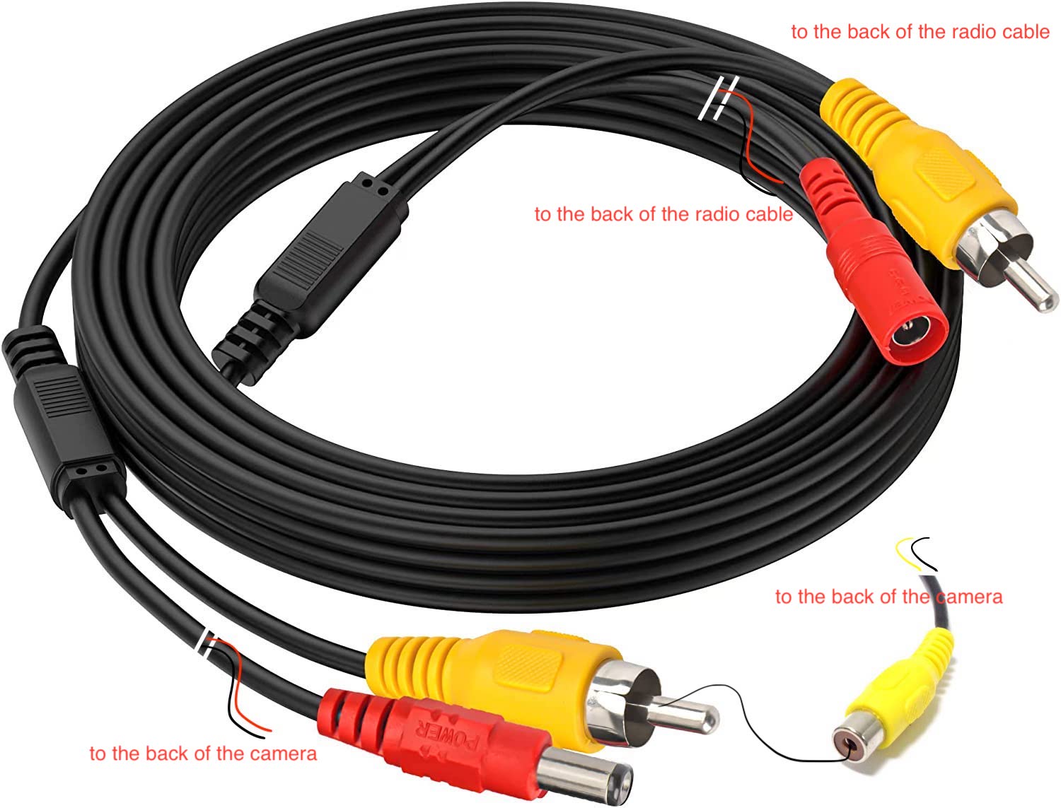

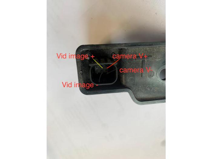

All right so here's the issue, these are the cables im using to connect to my rearview camera. Image two you connect to the back of your radio, image three i stripped the red connecters to attach those to the plus and minus of the frist cable and just plugging in the vid connector. I also got a female video connector and also stripped the wiring of that one. image one you can see the red and black where I connected it and the yellow and black as well. After starting the engine and putting the car in reverse it did not show  anything on the screen. What am I doing wrong? If you have any suggestions please let me know.
pinouts are as per the pdf this is as you look at the camera - Male pins
PIN
2    Video -
3    Video+
5   Ground
6   6v+
this is the plug view (Front on view) this plugs into the camera - Female
PIN
2    Video -
3    Video+
5   Ground
6   6v+
OMG! You're right I see it now can't believe I missed it! 😅 I will now do the walk of shame 🙈 thanks again

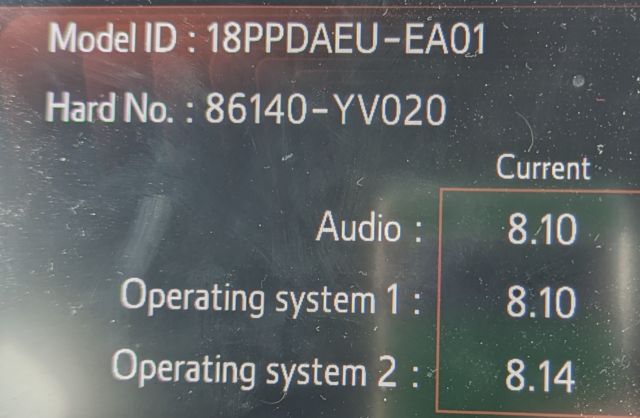

Hi guys, I have the upgraded head unit with Android Auto in my car, but would appreciate the update if someone could send it to me please.
Hard no: 86140-YV020
Audio: 8.10
OS1: 8.10
OS2: 8.14
Just very hit and miss at the moment, sometimes Android Auto will work, then other times, unless I do a phone reboot, and ignition on and off, it will flat out refuse to work. No idea if a firmware update will help, but it couldn't get any worse!

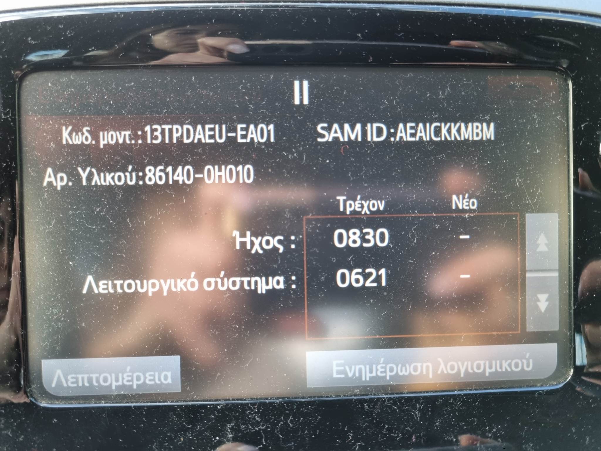

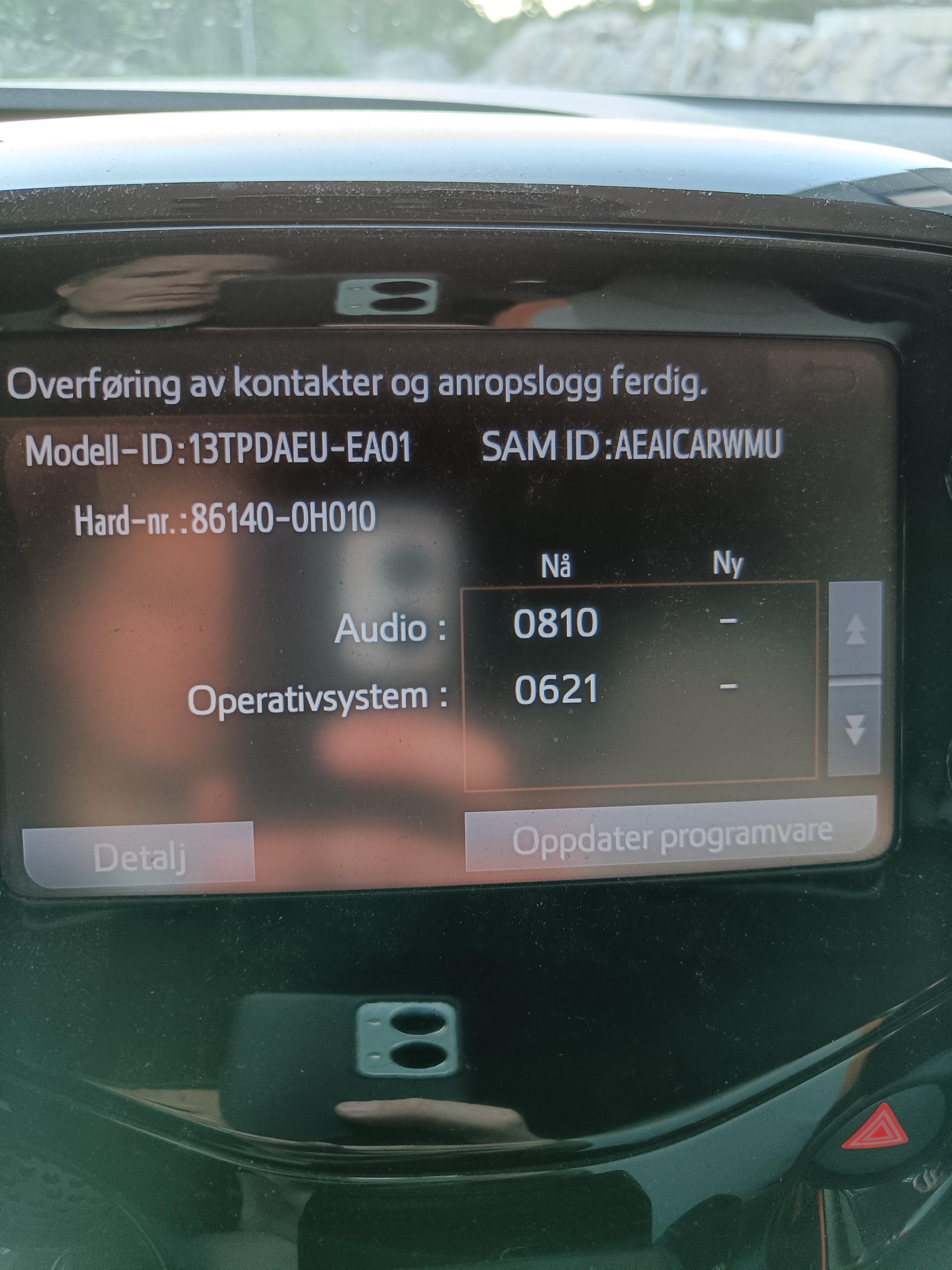

Hi @flash22, I've got a C1 (sorry, maybe wrong chat), but also audio: 0830, system: 0621. Hardware: 86140-0H010. Could you also provide me with 0850?
Hello guys, @flash22 or anyone else that may have it, can I have the firmware for my Aygo as well?
Thank you

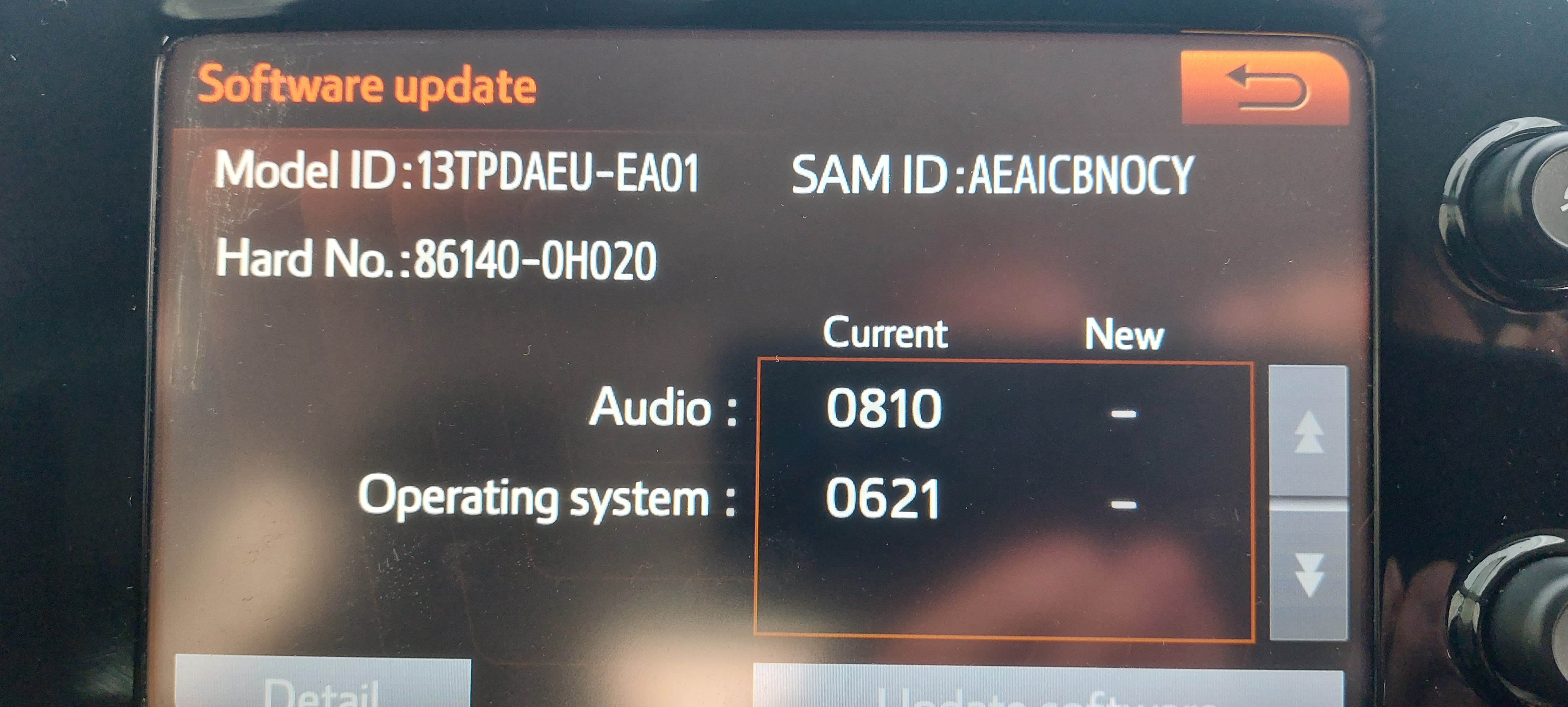

Hi guys, I have a 2014 Aygo that was never updated (Hardware: 86140-0H010 Audio: 0810 Operating System: 0621). From what I can understand, I would need the 0850 update. Could somebody send it to me? Thank you
