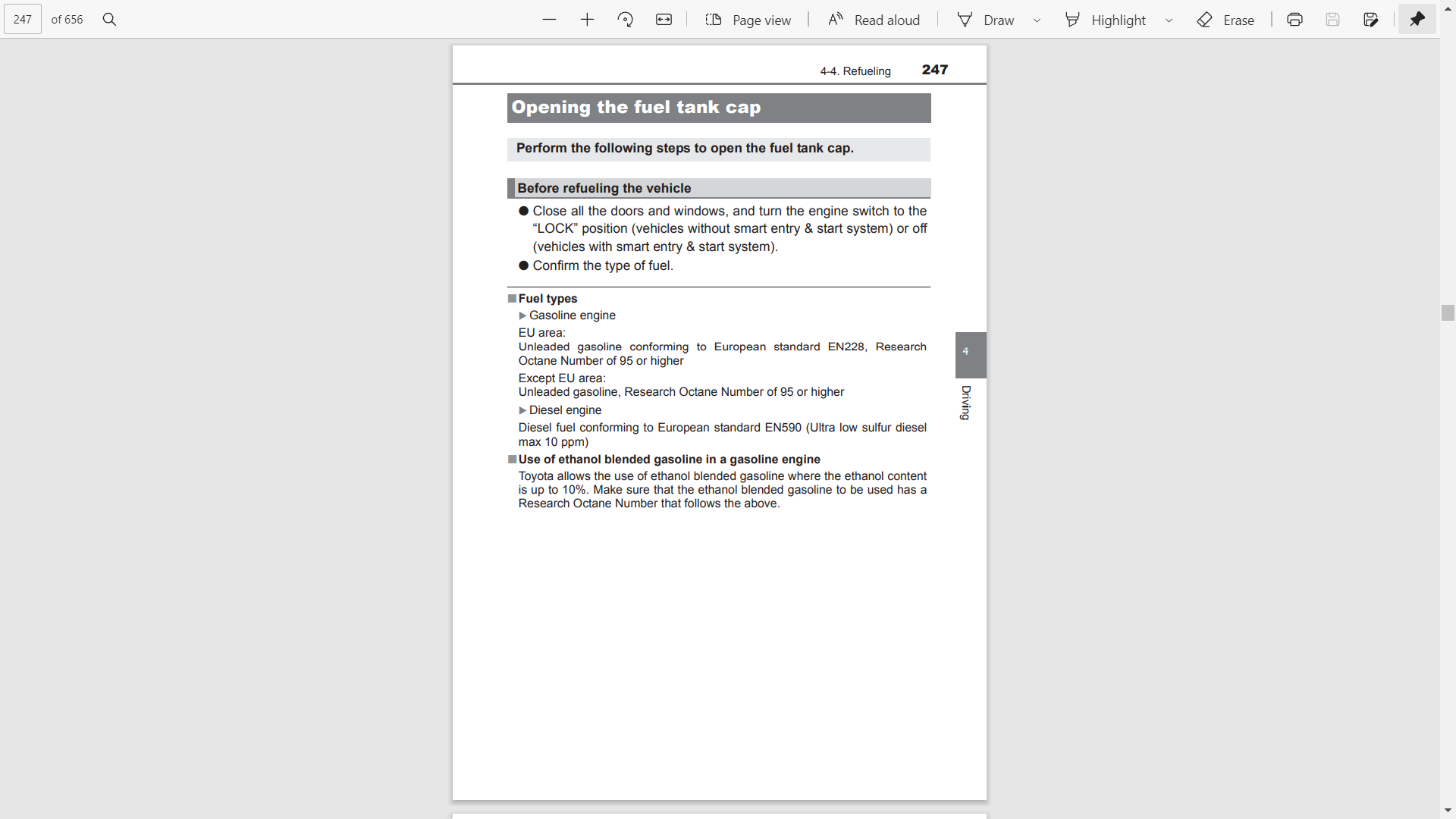

I was looking in the owners manual PDF (T27 Avensis) regarding another subject, and came across this under Refueling - image.thumb.png.19dc00d67e386c65b158dd37a0463044.png
I then checked my actual paper back version, which is the first version for the T27, and found the same info regarding E10 fuel -
X Gasoline engine EU area: Unleaded gasoline conforming to European standard EN228, Research Octane Number of 95 or higher
Except EU area: Unleaded gasoline, Research Octane Number of 95 or higher
■Use of ethanol blended gasoline in a gasoline engine Toyota allows the use of ethanol blended gasoline where the ethanol content is up to 10%. Make sure that the ethanol blended gasoline to be used has a Research Octane Number that follows the above.
So all Valvematic engines should have no issue using E10 fuel, which has been available in other markets outside UK for sometime.
