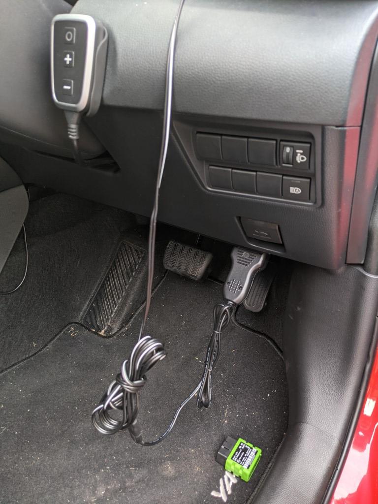

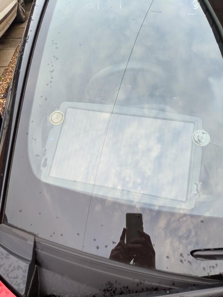

Not true if you buy a Solar Charger that has an OBDII connector option. It then plugs directly into the OBDII connector which gives direct access to the 12V Battery. No need to mess about under the rear seats...
Like this one...
PXL_20210108_133253492.thumb.jpg.fc7abd546a2f428806d28bae98b034b5.jpgPXL_20210108_133342468_MP.thumb.jpg.62fd37db311bdcfe83d6f97a652c0691.jpg
I tried it, but my car also turns off OBDII when the car is off - maybe a bad OBDII connector
I'm not sure if with a 20W solar charger - max. 1.11A for the OBDII port is not much

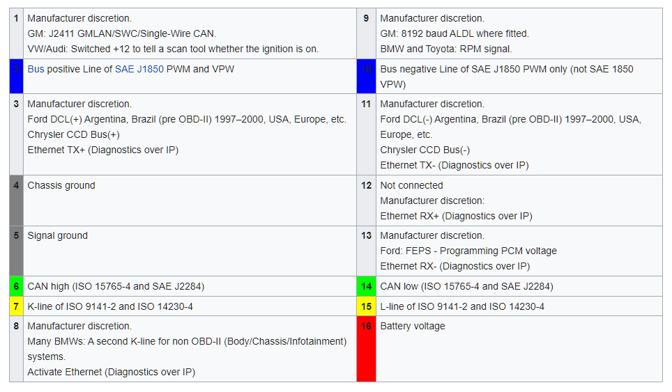

The OBDII connector is never turned "off" in terms of 12V and ground. If yours is going really off, there is a problem with your car. If you are judging its on/off status by using an OBDII dongle, you can't. Most OBDII dongles go to sleep when they realise that the CANBUS has gone to sleep (i.e. car ignition is off) or detection of Pin 1 up/down.

The 12V Battery in our Toyota Hybrids is meant to be charged low and slow. The solar panel in my pictures works perfectly for that.
Note that pin 16 and pin 4 are always connected.
"If you are judging its on/off status by using an OBDII dongle, you can't. Most OBDII dongles go to sleep when they realise that the CANBUS has gone to sleep"  - there was a problem here, I thought exactly
