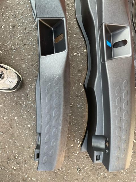

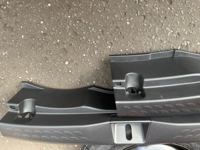

On 4/28/2022 at 5:36 PM, Spo2 said:
Alan, where does #8 go? It is already fitted in the 2-litre vehicle? Right? Or do you remove the original one and replace it with the new one?
Here are a couple of pics where you can see the curve cut out.  The trim with the blue tape is the new one.
Can't see the pics !!
Thanks Alan. What sort of tool did it need to remove and fix this trim. Sorry, I will have to buy that as well.

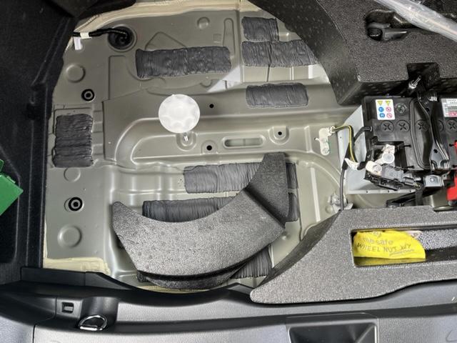

Lee, if you are able to fit, then would you be able to post a pic of the assembled unit without the space saver tyre in place? Just want to see where you fit the wheel cushion. My order got messed up and would need to reorder!
Bear in mind that I had no instructions to go by, but the underside of the wheel cushion follows the contour of the boot floor if sat as per the pic, and the upper right corner sits tightly against the vertical lip.  It doesn’t look like it would hold the wheel tightly and level but it does.  You can also maybe see better in this pic why the cut out of the rear trim is needed.
