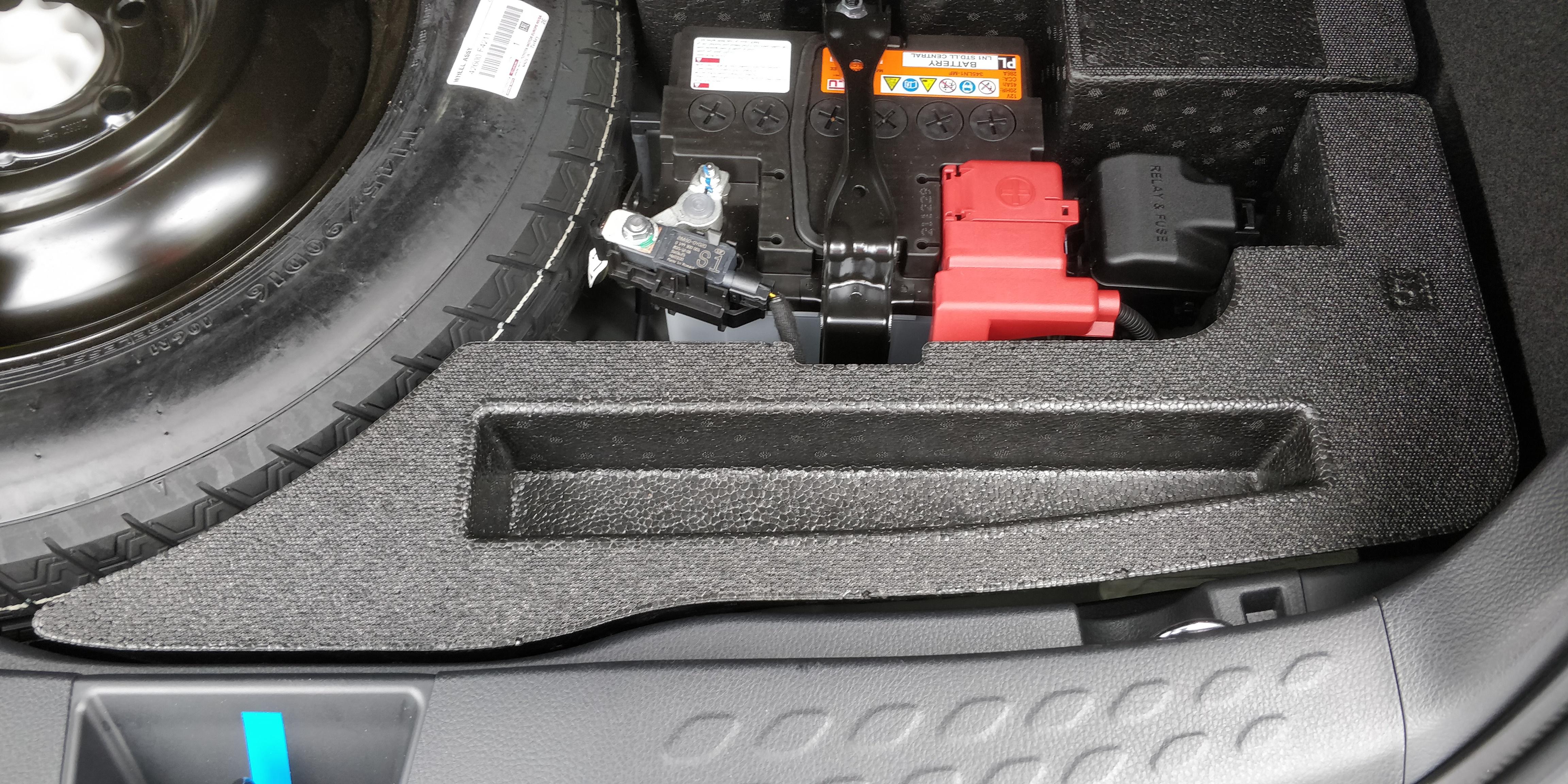

I wanted to ask - this bit of polystyrene trim in the spare wheel set up, is it firm and flush with the rear boot trim of your car? As you can see, mine is not and it wobbles a bit when moved with the hands? Not sure if I have fitted it properly but I see that the two screws in the floor of the car, they do go into the white socket of the polystyrene trim.
Thanks
Sol

Did you find a solution to this ??
Nope, it seems it is designed like that.
Mine does not wobble it is quite firm and secure otherwise the same.
Same here, I checked earlier today.

So the wheel cushion is just placed in there free then, or are people securing it somehow ??
Does a 16 inch space saver wheel sit in the boot well properly so it does not raise the floor height by much. I got a 17 inch one but it does not fit properly
cheers Alex
Ours is a 2.0 so the boot floor is already raised due to it having a Battery in the boot, but the 16" space saver raises the boot floor to the height of the Battery.  Have a read at this thread, where there are some pics.
So is it glued in place, or just rested there with the space saver just on the top of it.
TIA
For mine I just left it loose andfound the best sitting position for it and put the wheel in and screwed the clamp down.
All the foamy pieces sit in place, however there are sort-of screws sticking up from the boot floor at a couple of places, and there are corresponding holes in the bottom of the foamy pieces.

Hi all, before I go heavy handed and break something. How do you get the original 1 piece section out of the car ?? Is it via the back seat section ?? As it seems to wide to come out of the boot aperture !!
Hi David,
When I did mine I lowered the back seats, took out the parcelshelf and the deck board. Then lifted one corner to an angle and eventually the original polystyrene 1 section box came out. Lot easier putting the new in only piece that had me scratching my head was the piece that goes underneth the wheel but eventually placed i where it needed to be. Put the wheel and bits in, putting the original tyre pump and sealant in the right hand cubby, job done!
Hope this helps.
Chris.
