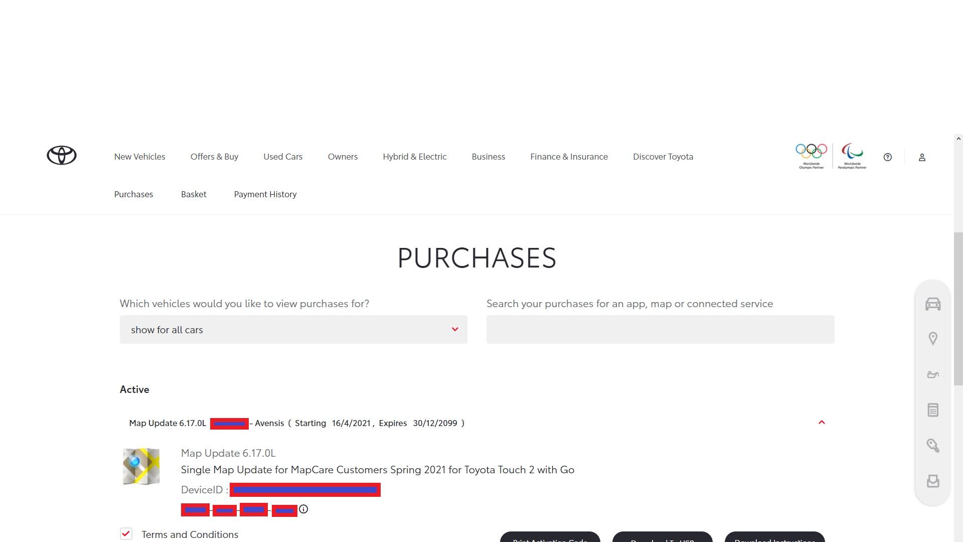

Failing that, if you go to MyToyota on the Toyota website & go the estore, there will be 3 sub headings in a line - purchases, basket, payment history
If you go to purchases you should be able to see the map update, for my last update it shows:
Map Update 6.17.0L
Single Map Update for MapCare Customers Spring 2021 for Toyota Touch 2 with Go
DeviceID : REDACTED
XXXX-YYYY-ZZZZ-AAAA   <This is the activation/authorisation code that you enter into the head unit (I have redacted mine)
Terms and Conditions

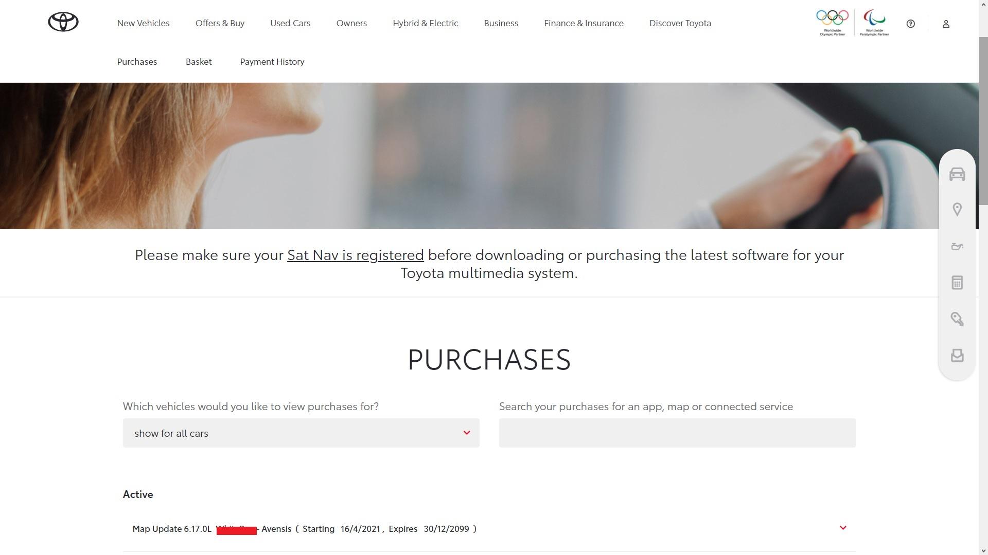

Go to https://www.toyota.co.uk/tme#/my-toyota/eStore.
Login.
Go to the purchases page (in mine because over the years  I have had multiple purchases for multiple cars I get asked to choose which car, I doubt that you  do).
Below that you should see Active, select Map Update & at the rhs of that you will see a red down arrow, click that. You should then be able to see the Device ID & below that the Authorisation Code for that Map Update.

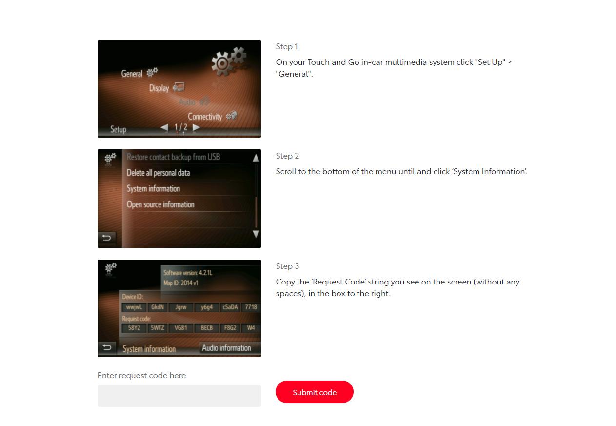

Thanks Scott. The page I'm trying to get to is shown below. I followed and got the Request Code, entrered it as shown on the page but kept getting Code Not Recognised. Now I can't even find the System Information tab.

The photo in my post above was generated via the e-store and at the bottom of the photo it says "Enter Request Code Here".

Just heard back from the Toyota Connectivity team and they said:
The steps to finding your request code is different for our new generation of multimedia systems, you need to follow: Setup > Online > Toyota Online > Map Update
Hope this helps someone else with their map updates.
