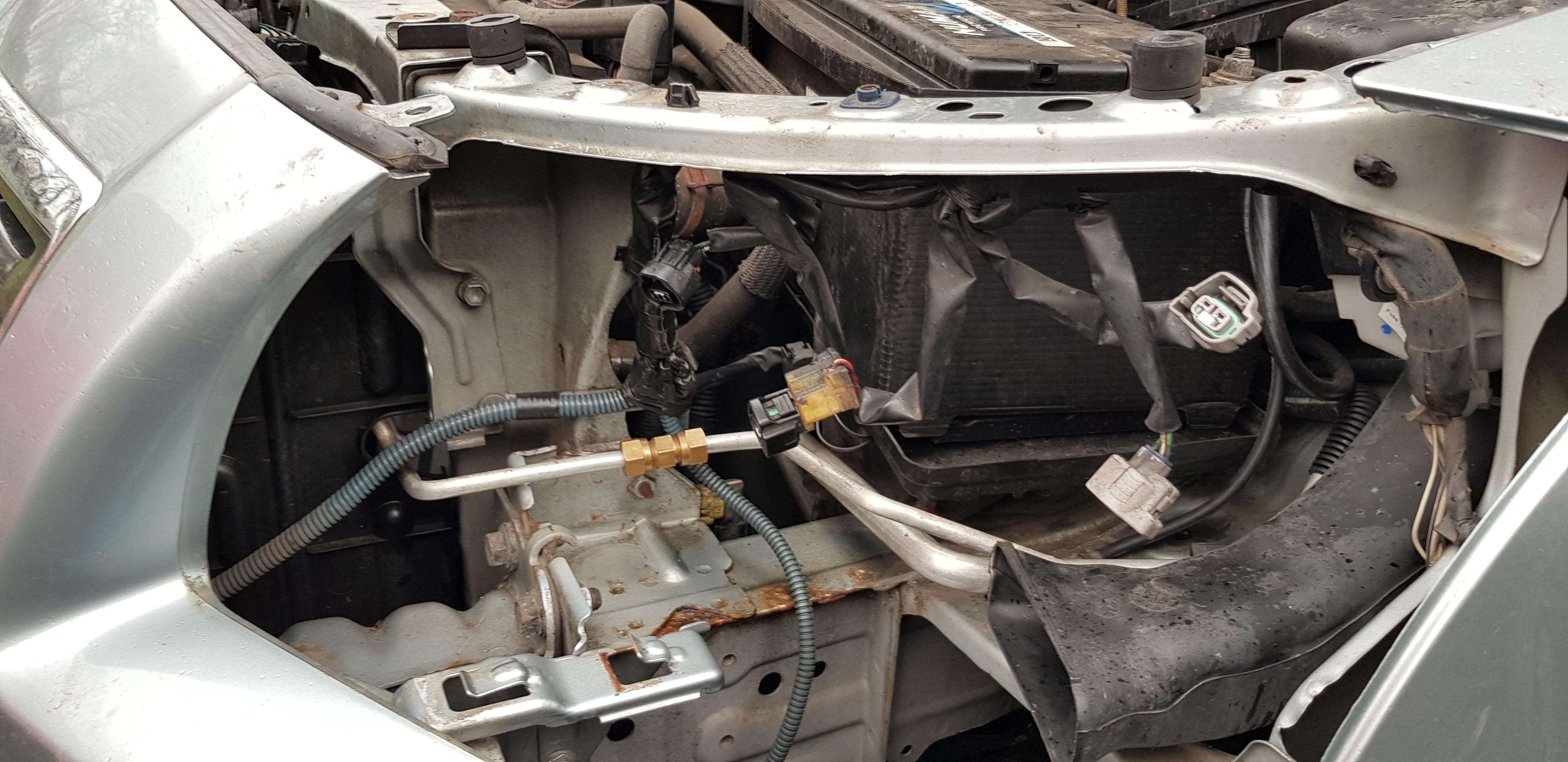

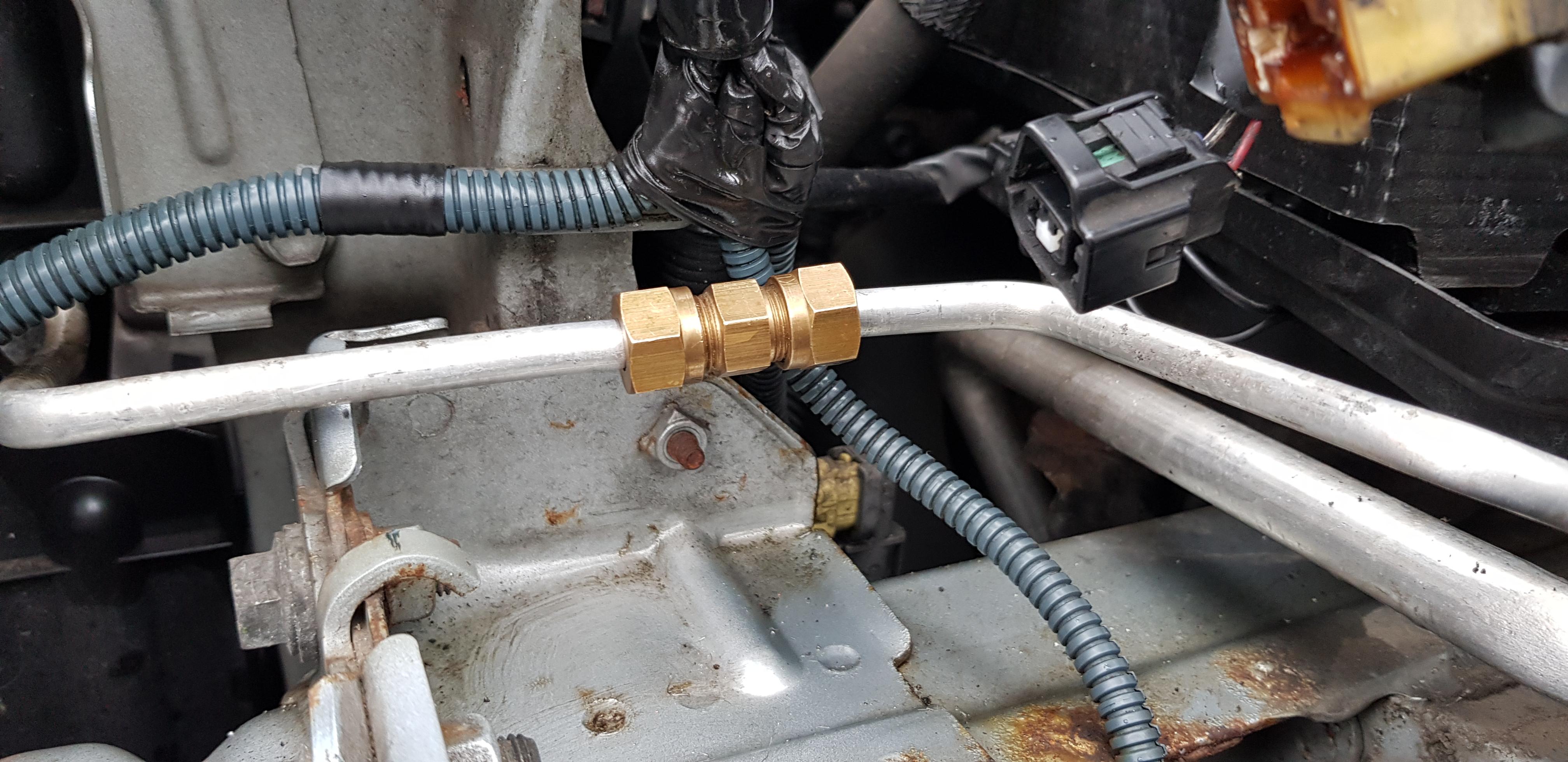

I did this unorthodox repair to my own car in February.  I used a can of gas from Halfords.  The repair is holding up and the air con is freezing.
