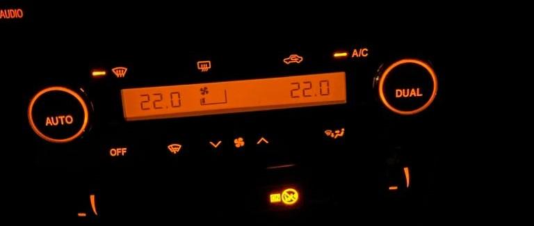

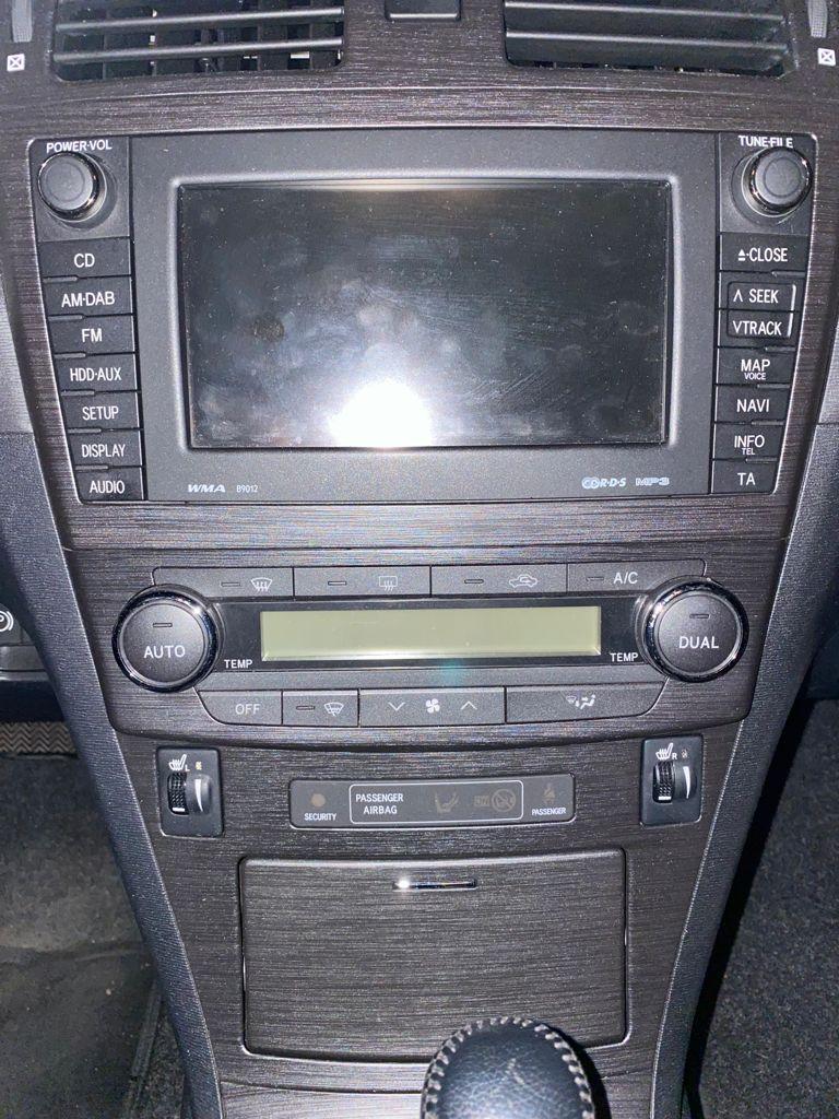

Hi,
Can you run a climate control diagnostic self test on a T27 (Avensis 2011 with keyless push button start)?
I have seen procedures for older models but not for this one.
A couple of photos of the climate control below:
