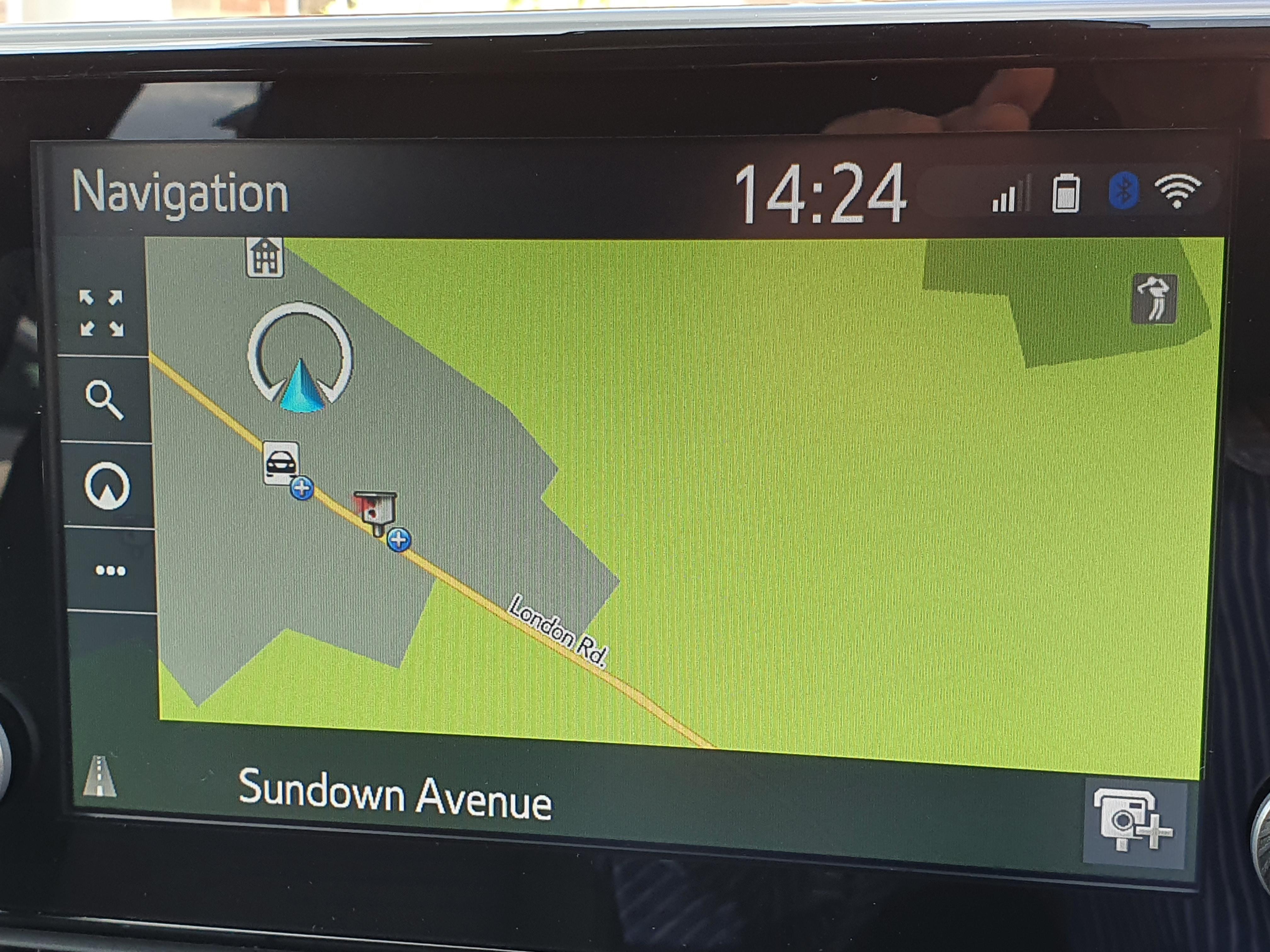

Firstly I went into the Menu, Apps then eStore. You need the car set to use the Toyota Network and downloaded and installed the Coyote app. Open the app and then it said I should register on Toyota.eu.  I was not able to do this, web site dead or not available, tried UK site nothing. After a short while I went out to the car and selected the Coyote app again, this time it said I need to have an active internet connection so I set the phone up to tethered WiFi and tried again (no Android Auto active it will not work) Selected the app and this time it downloaded a load os POI's and saved them locally. Switched to the Map and sure enough just down the road is a camera. It must have automatically registered the app to the car/my account but took a little while to sort.  Poor image but it shows the camera, hope this makes sense?
Ernie I am not convinced. The camera symbol is what I got from new.
I notice also a camera plus symbol bottom right.  This is for adding a camera.  I get it too but only when fiddling with the map and never on the road.

Mine was there from new also and this is what I also got. But it all disappeared and at one point the Coyote app went missing.  I know this is a real cameras it's just down the road from me, in fact I was sitting in my drive when I took this.  Before I went through this process today this camera was not present on the map so something has changed.  I'll test it further over the next few days.

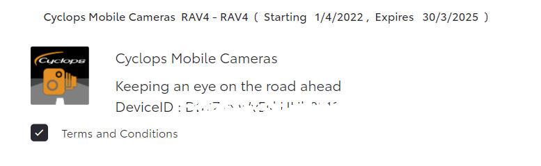

Having  seen this thread I have just started the free trial for Coyote , while doing this I noticed there is an app called Cyclops which is also for mobile cameras, the e-store says it’s loaded and runs for 3 years.
Anyone know if runs in back ground while using the satnav or do you need to be connected to a Hotspot on your iPhone? I can’t see it in the apps on the MID.
Anyone know if runs in back ground while using the satnav or do you need to be connected to a Hotspot on your IPhone? I can’t see it in the apps on the MID.
I think Cyclops is what is referred to as "built in cameras" through this thread. As Ernie says, you get this free for 3 years.
