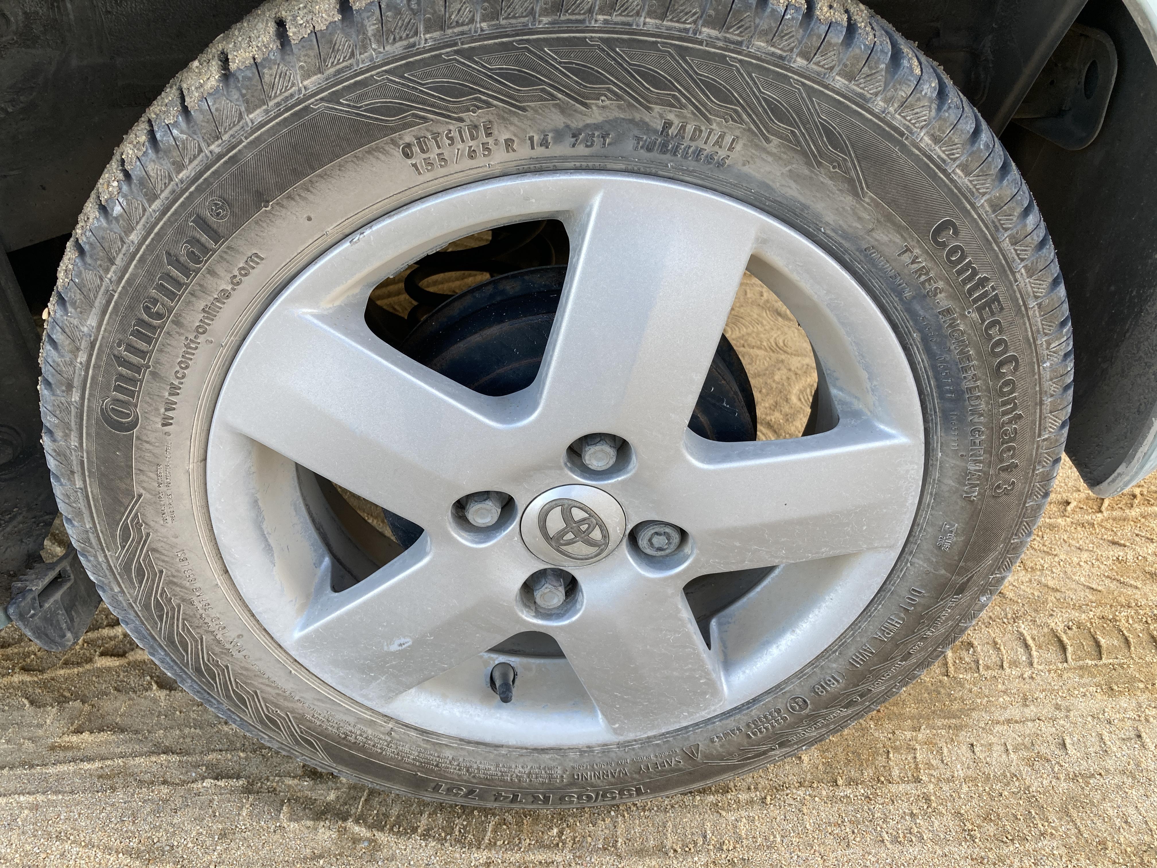

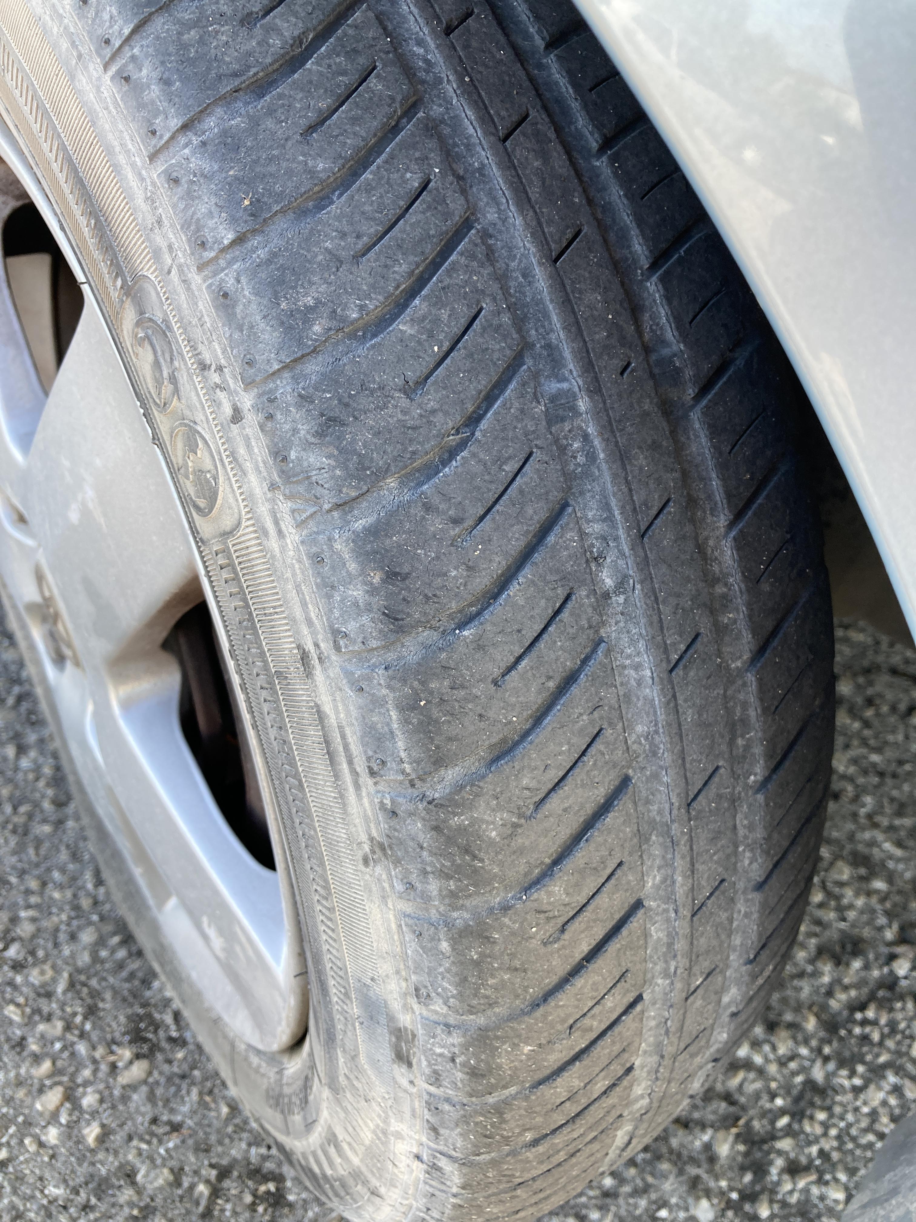

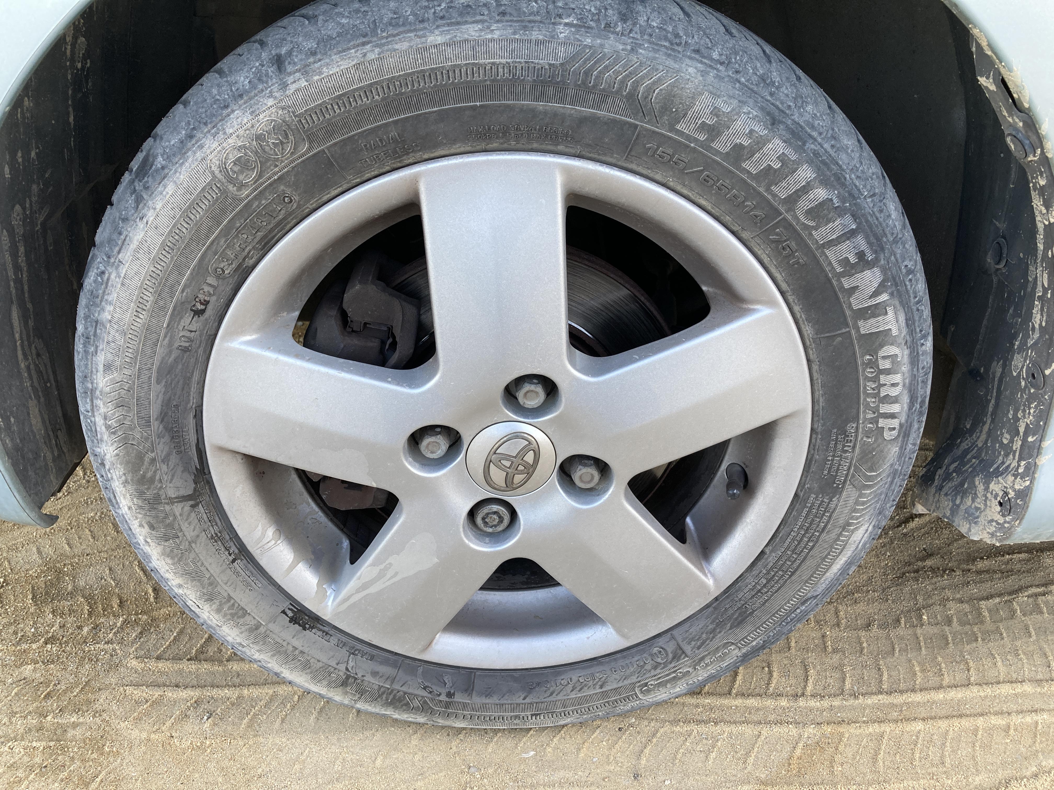

1º image front tyre
2 back tyre

Usually it is not recommended to mix tyres (some countries even illegal) no matter if they all summer, all season or winter tyres, whatever it’s on the front axle should be same on the rear for best performance, safety and comfort. Your rear tyres look good, why not just buy two more exactly the same conties and job done properly and only two tyres paid. Otherwise best to buy all 4 new tyres. No need an all season tyres only because of the rain. Best tyres for rain are those with straight canals for water drainage, not v shaped like most all season tyres , v shape helps in snow, mud and ice traction. The worst scenario is to mix summer with winter or all season as has been mentioned above, the car will behave strangely and even dangerously and in extreme emergency situations you can easily loose control just because of the tyre mix.  Tyres are the most important in the car along with brakes. 👍
i m gonna keep back tyres the are ok but my main concern is the grip and handling because i have the car two weeks but  i dont have any confidence in corners and roundabouts and im looking a tyres with  better grip and handling i dont mind "sacrifice" fuel economy.
tbh if I am reading it right that tyre is 10 years old & it certainly looks worn  - how much tread depth is left?
2014 the tyer was from previous owner, i bought the car 2 weeks ago.
Your rear ones look good and not too old from 2018, just try to find same make and model and buy two new for the front and you will be all set. If not available exactly same model then look for what has replaced them conti 6 or whatever name is just to be as much identical to the ones on the car.
