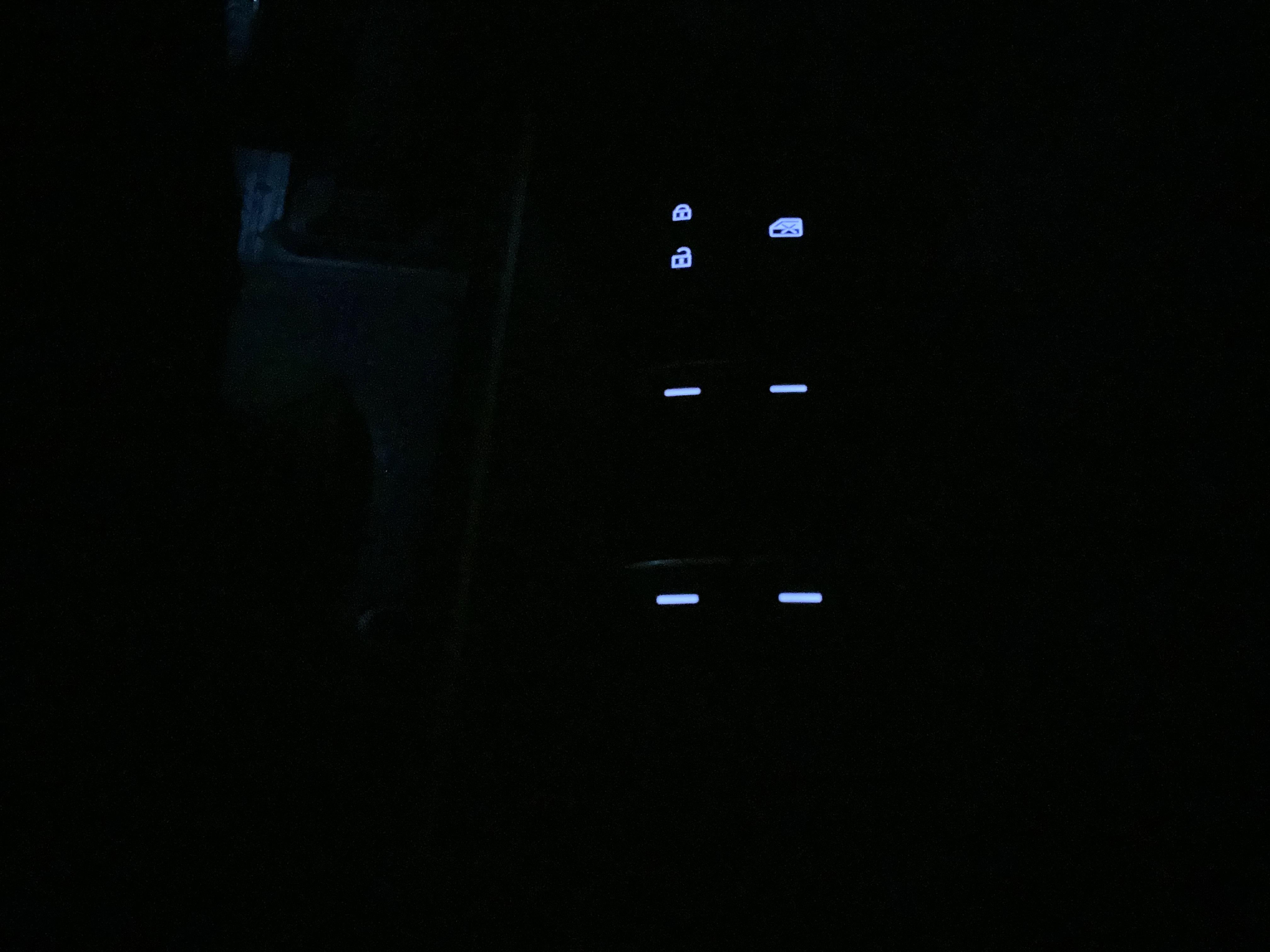

1 hour ago, ernieb said:
Here’s mine, difficult to take a photo but….
That's exactly how they should be. I'll be following you're example ernie.
