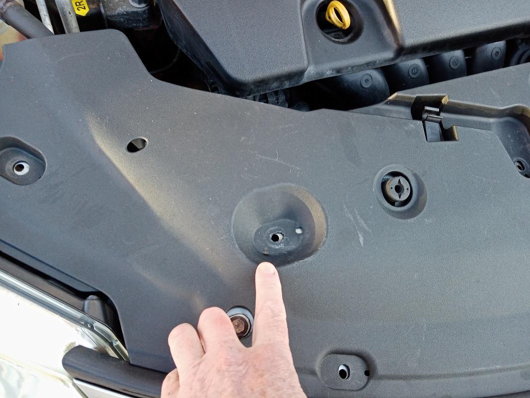

Afternoon all. Strangely, most of the clips (see picture) on this plastic cover under the bonnet are missing. Anyone have a link or similar to get replacements please?

yep i have a 2014 and well as soon as u take that cover off those clips in my opinion are junk i bought a pack of them from eBay as well after taking them off they not worth putting back on as they eill fall off. another thing i did was buy off eBay a special tool for taking those off as maybe that was my problem i was using a flat headed screwdriver
https://www.ebay.co.uk/itm/393052872577
https://www.ebay.co.uk/itm/371220927714
When I first got my car back in 2015, I had to replace missing clips. I got a clip kit with different size and types of clips. The real issue is not have the proper tool to remove the clips and I have a two tools, plus trim removal kits. Even without the proper tools, there is a way of removing clips without forcing and breaking them. The techniques are as follows -
  • Lift the centre of the clip first, then pull the whole clip out.
  • Other designs have a cross indent, so use a crosshead screwdriver (Philips), to turn the centre which pops up.
  • The final type is push the centre in before lifting the main body of the clip out.
Since replacing missing clips, I never have to worry about broken clips.

Clips arrived today, perfect fit, thanks. I think it was the Battery previously had been changed, as there is a recent receipt. Shame they didn't put the clips back!

Those kinda clips are junk I was first to take mine out and we'll put them in and they fell out pure junk those kinda clips one time use those tbh so have plenty incase

official dealers charge an inordinate amount for them i have found and often forget to replace them or charge for them like they do for windscreen topup liquid (even though you can drive into a service with the level at 100%). hasty removal of them risks damaging them also. you can get a bag of them inexpensively on aliexpress. be sure to turn them 90 degrees before removal so the centre part pops free.
