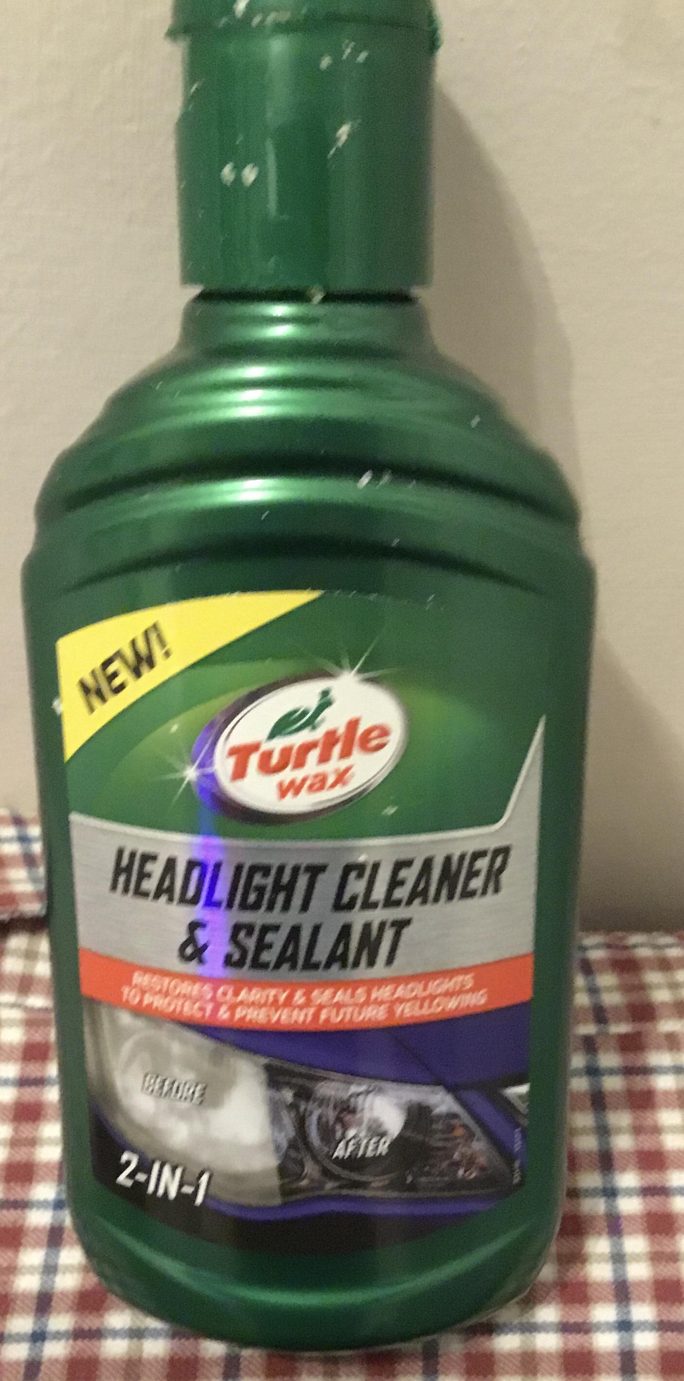

Also check the condition of the lens, if there starting to cloud over that will reduce usable light output - they can be polished clean with the correct product.

Btw Daimler Driver, how long does this seal the lenses for? Most of time i find that in the summer they yellow again quite quickly after using a polish as i don't know what to protect them with.
Obviously due to uv exposure
