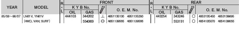

Based on the info given - 1987 LN61 (2.4 diesel ?)
Fronts - 48511-39575
Rears - 48541-39045
having a look at Australia where these cars are more common
Click to enlarge - note the 2 different types top ones are gas, the lower are adjustable
Standard oil shocks front 444103 - £35 each, Rear 443254 - £40 each
