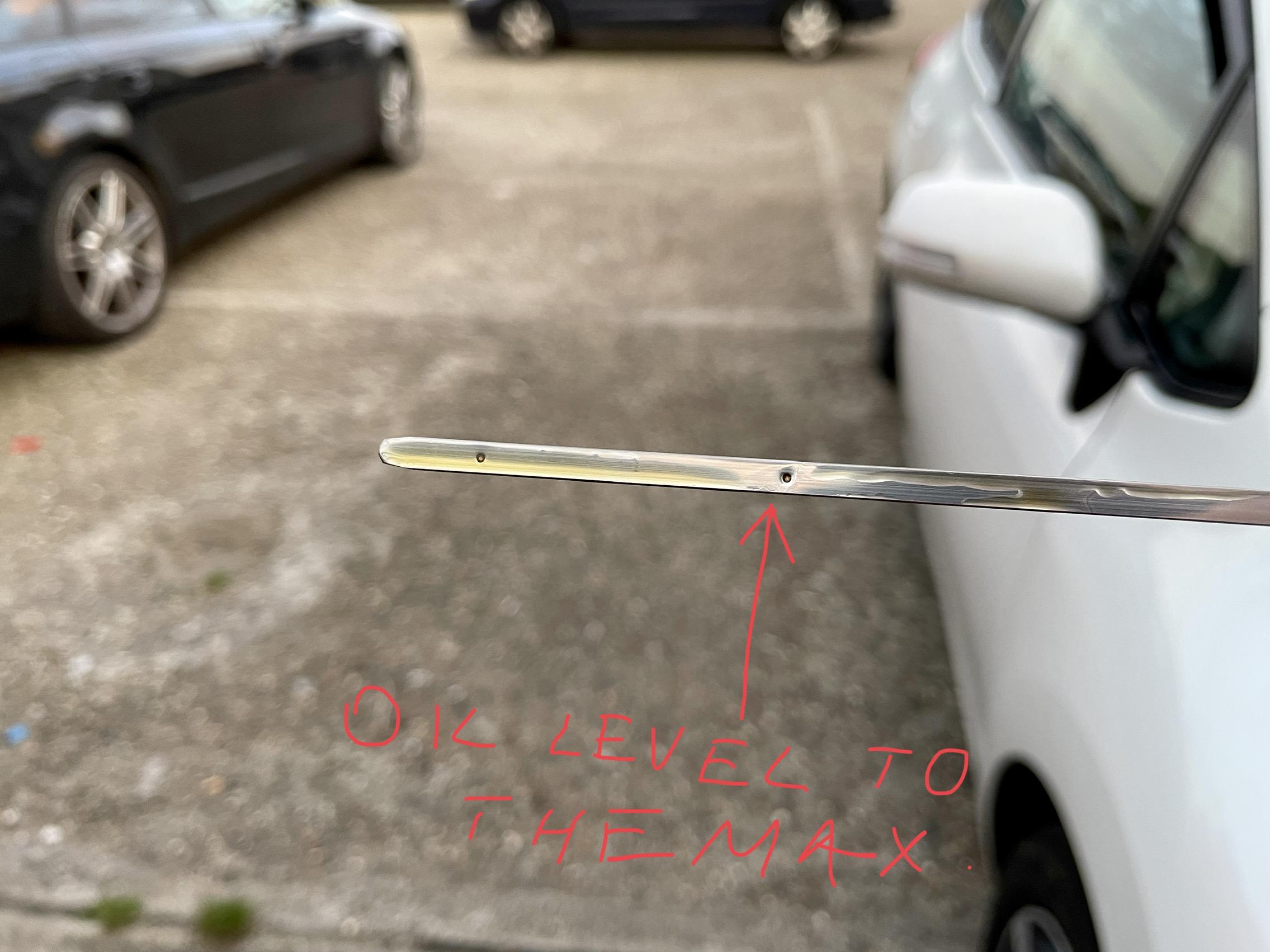

Same here, but I learned that when you re checking you need to look for one continuing oil mark on the dipstick and where it ends there is your correct oil level, anything above is just residual marks from the tube. For cleanest oil level readings, best to park at level ground if possible and check your oil level next day, just pull out the dipstick and read straight away without wiping it first. 👍
Thanks all, glad it isn't just me. Whilst I am an (enthusiastic) amateur mechanic, I have serviced all my cars, all my life (in my mid 50's now), so have a pretty good grasp on the basics. I have had, literally, dozens of cars over the years and have never come across this before, to this extent. My previous car was a 2.0d Jaguar X type and you had to dip, wipe, dip, wipe (no sniggering in the back there!) over and over again, but, eventually, when the tube cleared, you could get a good, honest reading. I tried and tried yesterday, to the point that my neighbours must have thought "he's lost it (again)". No joy. Tried again today, again, no joy. As mentioned above, the oil is now so clean you can hardly see it on there in any case. Hey ho, live and learn!
