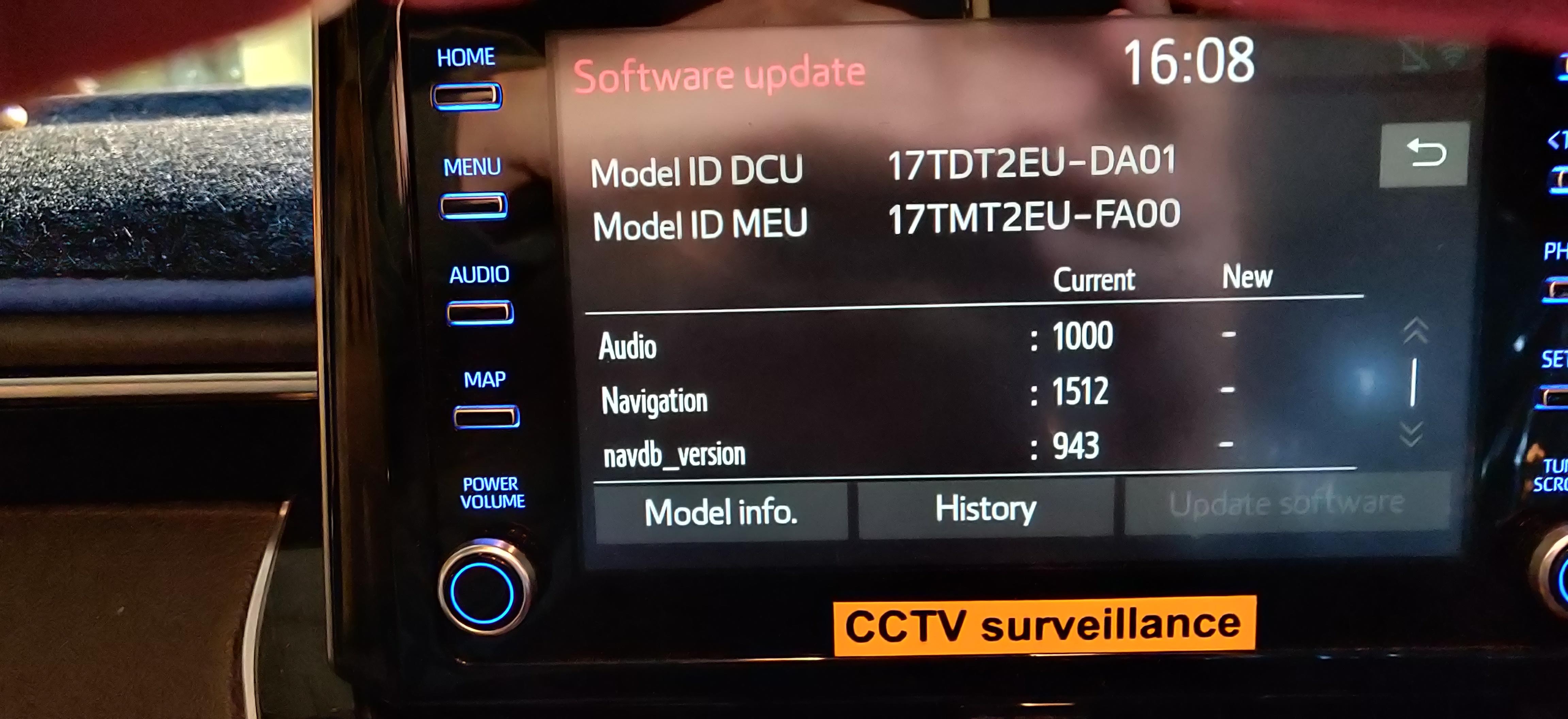

I have the unit with navigation no Android Auto or Carplay. I like to find someone to guide me how to do the update step by step and what files I need. I searched many forums and  more I dig the more I get confused. Here in Malta Toyota doesn't know that the update exists..  so i need some tips how to do it properly.

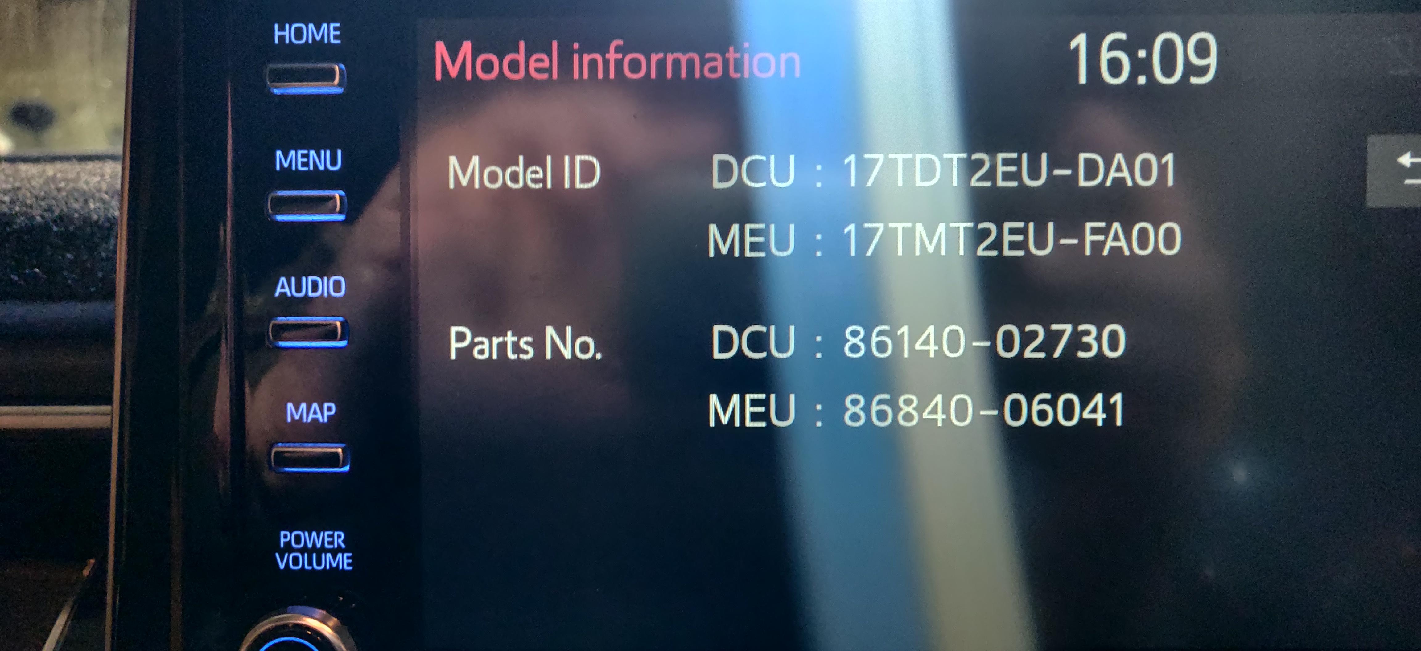

Model ID : DCU:17TDT2EU-DA01
                  MEU:17TMT2EU-FA00
Parts No. DCU:816140-02730
                 MEU:86840-06041
Audio : 1000
Navigation : 1512
Navdb_version : 943

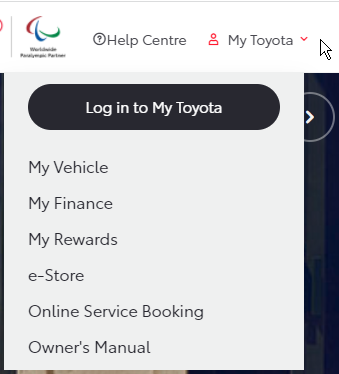

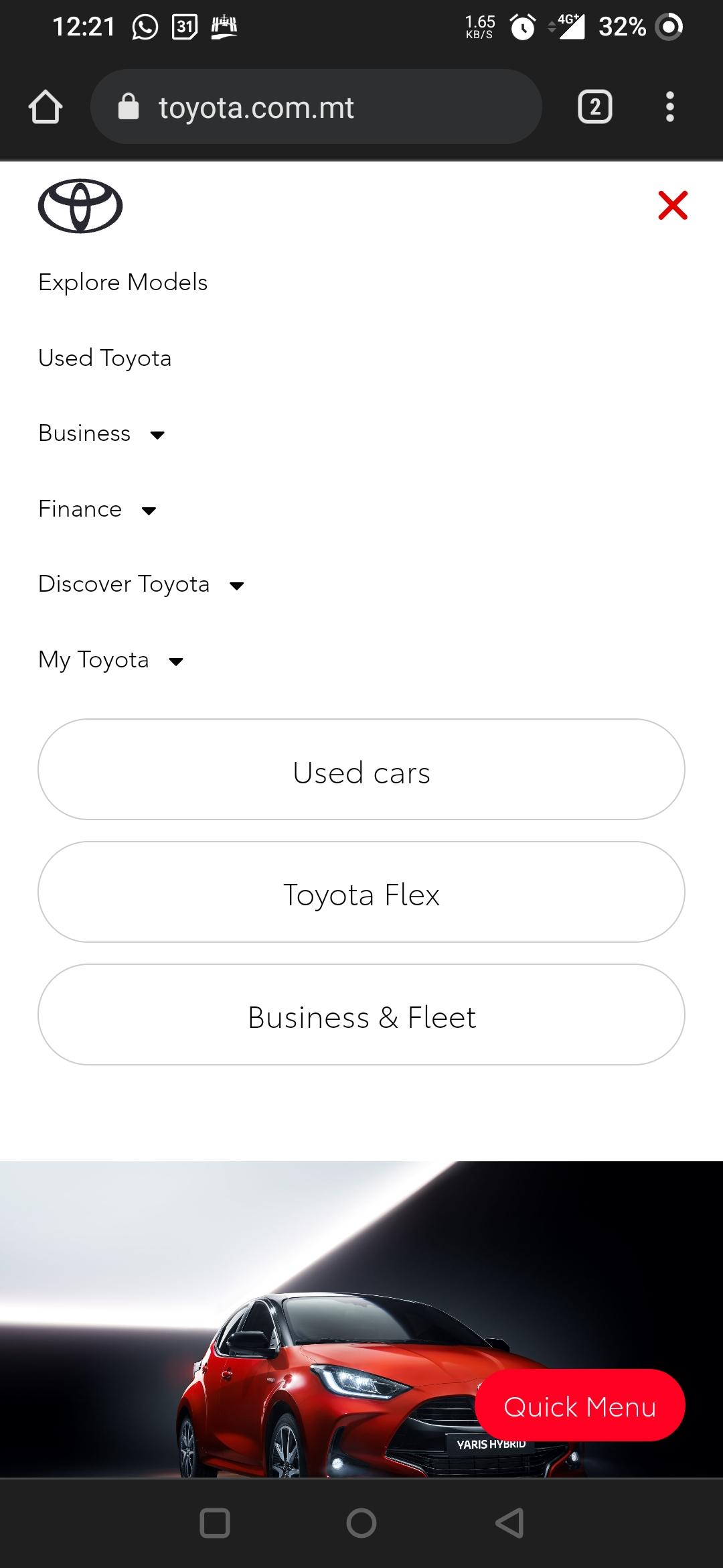

On www.toyota.com.mt, on the top right is "MyToyota" - I see no way to log in (which may be regional issues) - do you have a way to log in there? The info you need as well as the code to upgrade/unlock the licence can be obtained through there. Also guessing no option to update over the air via cell/mobile internet?
Second image I attached shows what I see on toyota UK's website. Once logged in I can download the software which is correct for my car and access the code needed. OR if I have my mobile phone (or if close enough, Home WiFi) connected, I can download/upgrade "over the air". Unfortunately if you cannot get the code you won't be able to use the USB stick method, but may be able to use over the air.

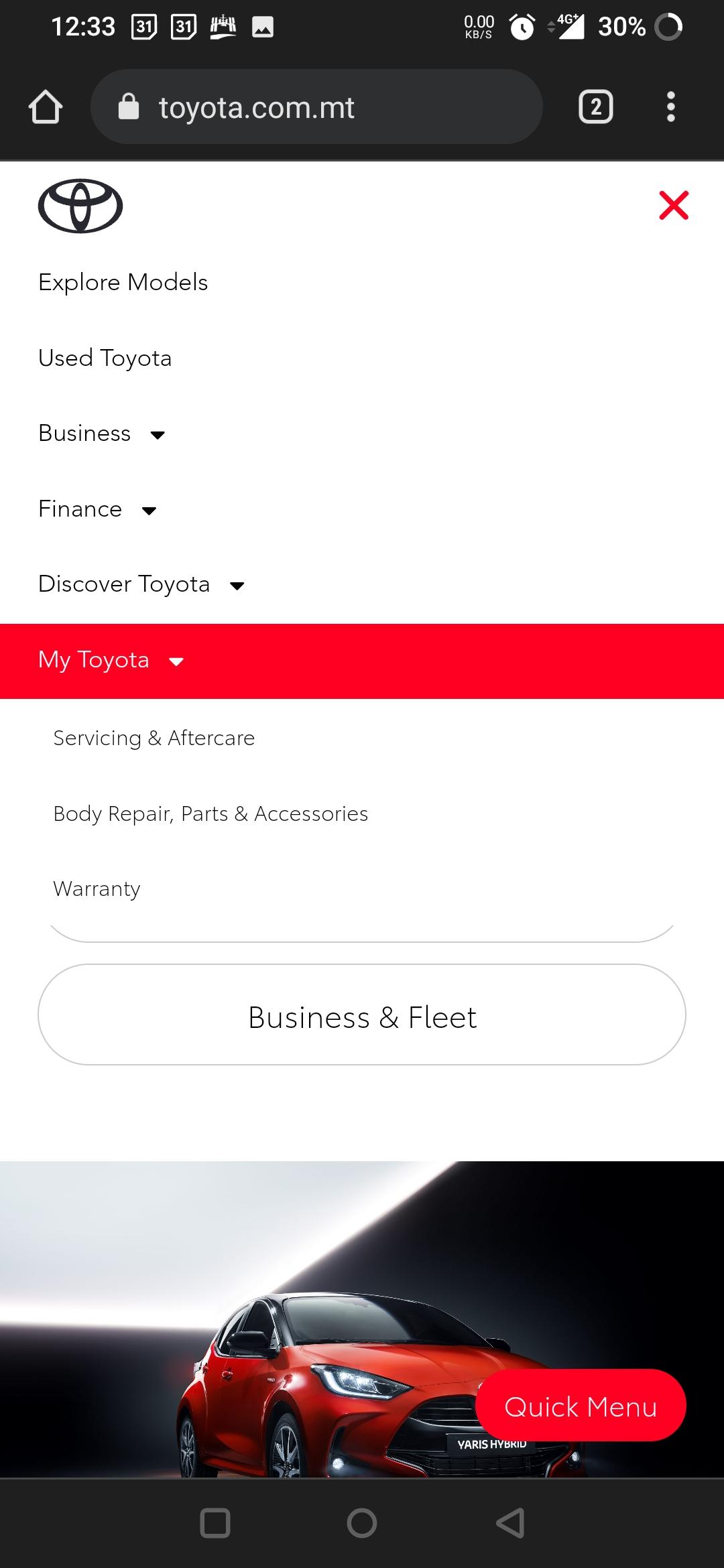

Ok i checked on toyota.com.mt and this was the result as you can see only 3 options we have nothing more. I dont know if i can download it from the uk site

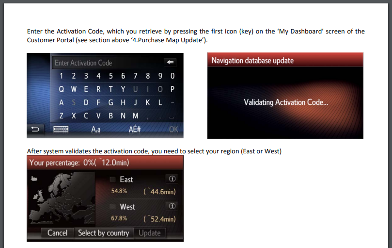

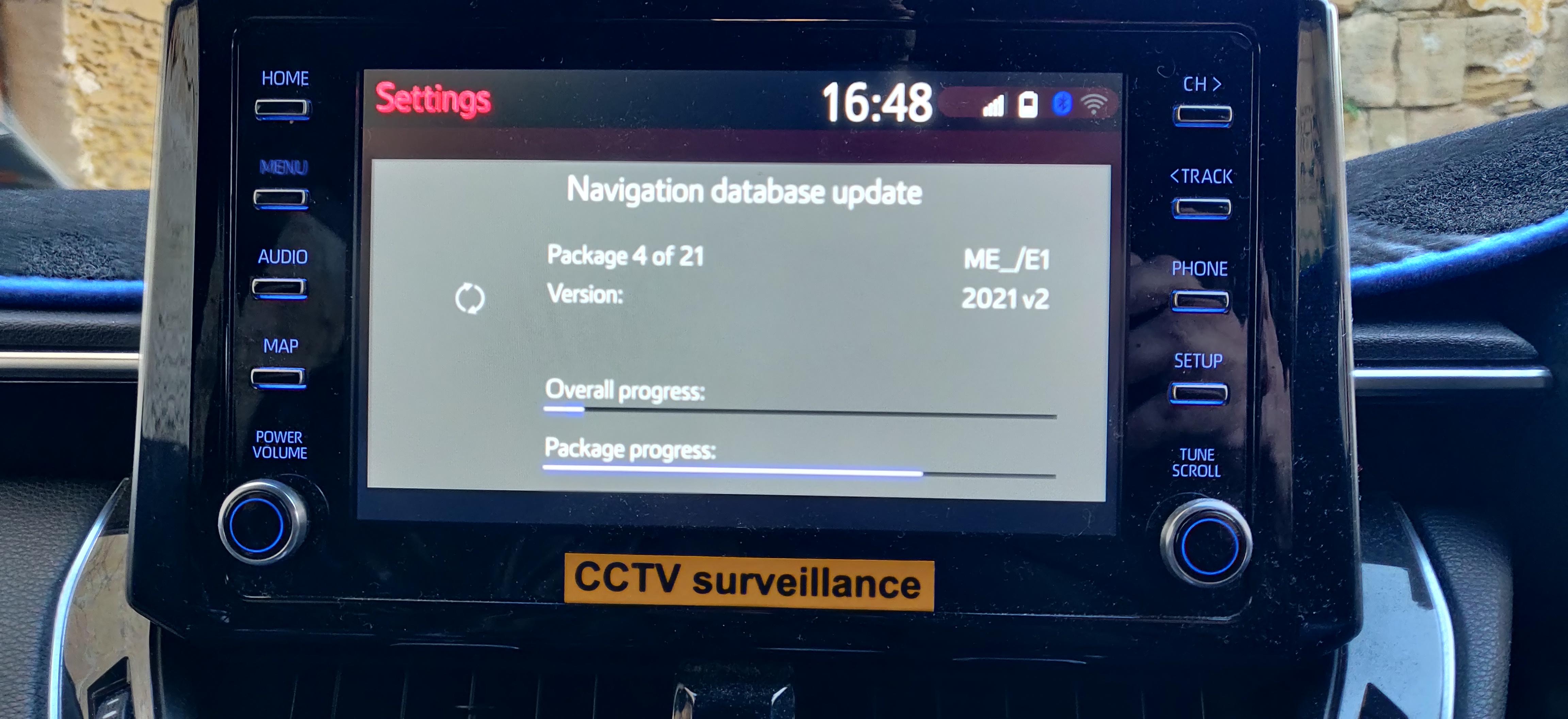

Ok i managed to go trough the site, conneted the car witm MyT app, registered the car and downloaded a .zip file that contains a 4 .iso files. Now, i need to get the code and the site says insert usb in the car to get the code. So i assume that i copy and paste the file with contents on the usb, insert in the car and get the code?
Open the zip file and copy it exactly as it is (from memory it's one folder). Don't open the folder and copy just the files, just copy the root of the zip to the USB.

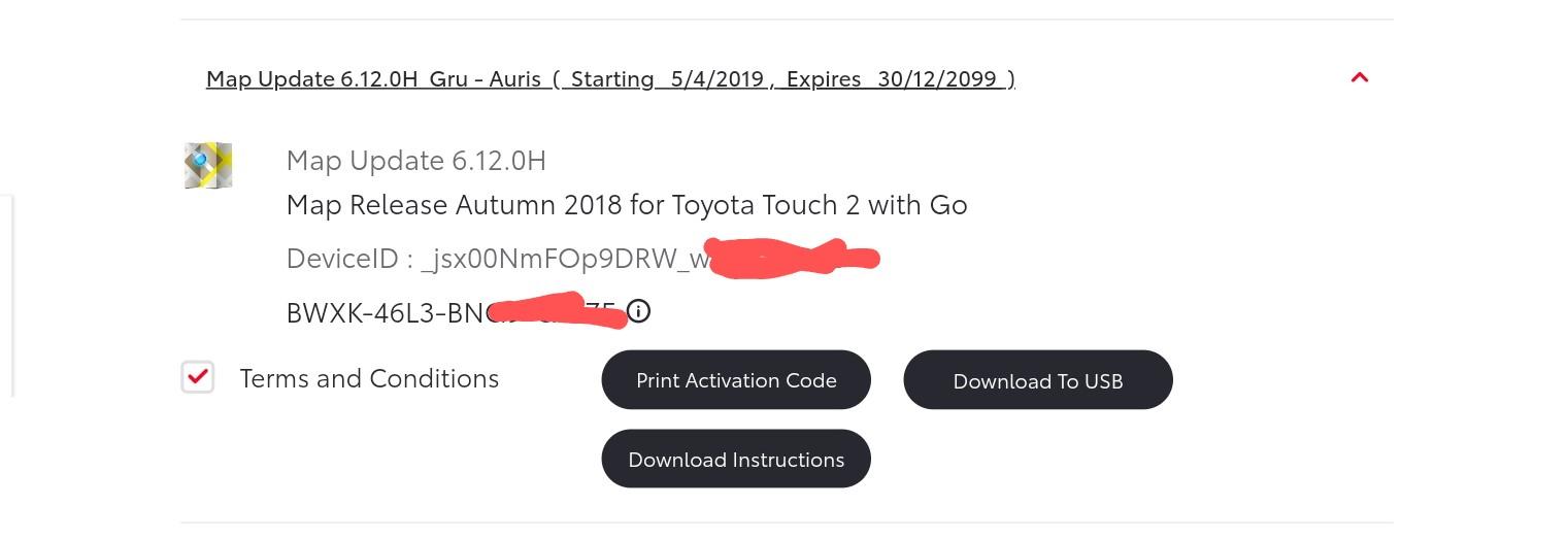

If you managed to download the file, it should have the code on the purchase history (even if free)
15 hours ago, trashman1965 said:
Purchases tab example:

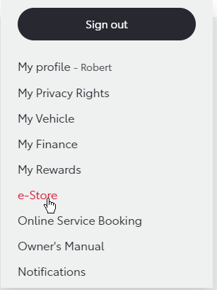

No Problem - sign in to MyToyota, then click on your name icon top right:
Click on e-store

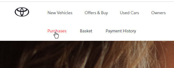

and once that page loads click "Purchases"
All "Active" (software/maps are perpetual) will then have any list of software/apps etc with link to download and the activation code
Thanks alot for your help, im updating it now but its only maps. Better than nothing. Now the software i need to be complete for the AA 😁😁 thanks again
