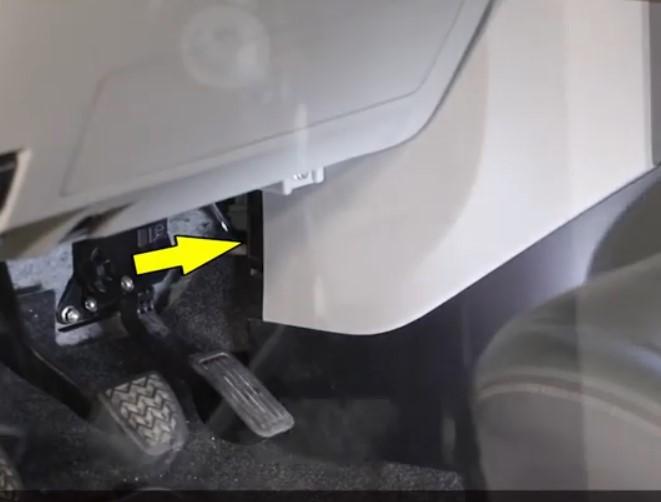

Dose the UK IQ have a pollen filter or cabin filter as some call it,  Reason i ask is i looked on you tube & there are vids on how to change it & where it is located etc but on looking at my 2011 IQ3 there is no box for it where it is on the vids!  (Drivers side pedal)  Confused!!

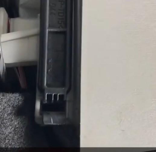

This shows the cabin filter on a LHD car, but it's in the same location on RHD (passenger side footwell)

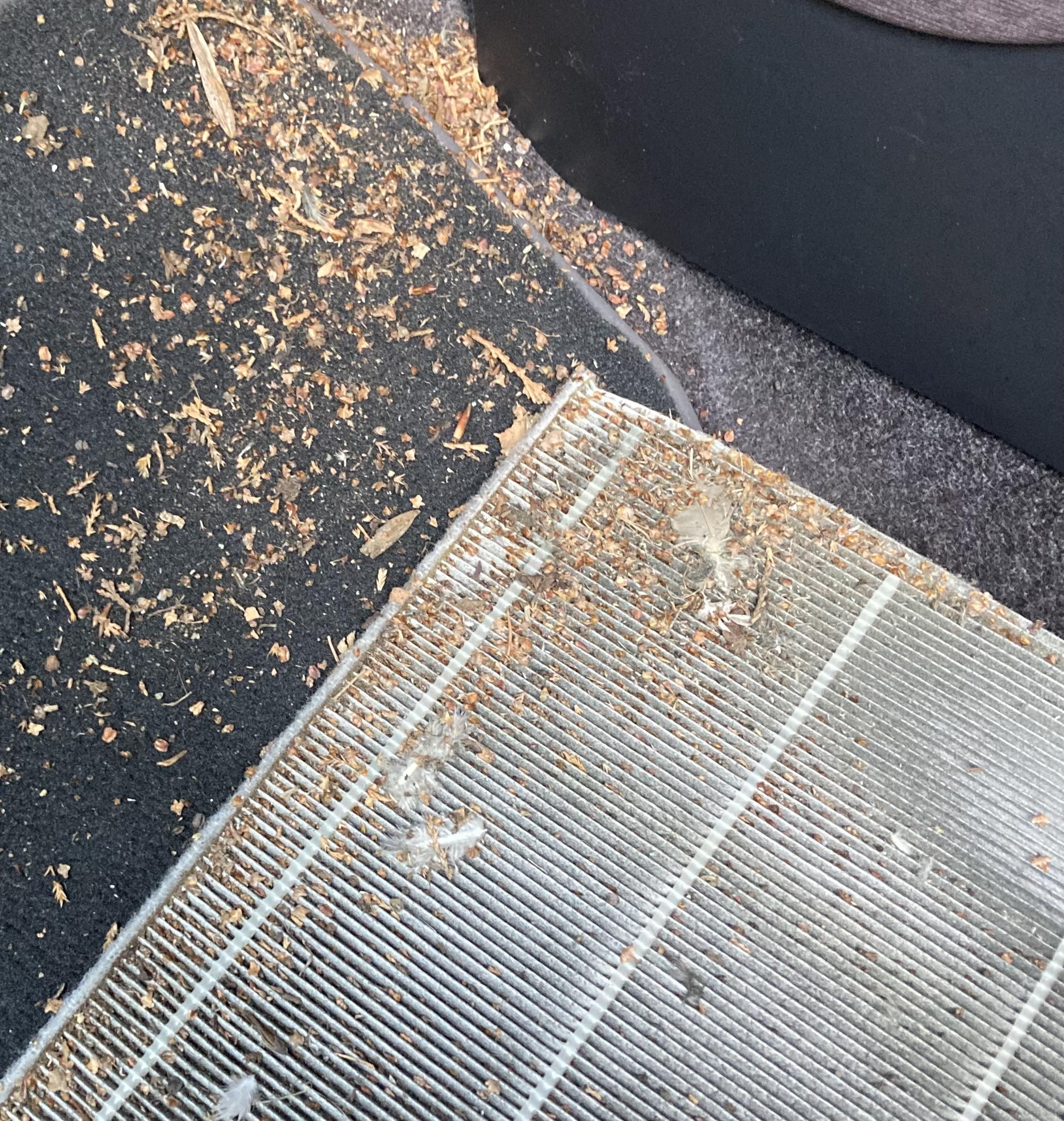

I have found it, Passenger side (RHD) on the bottom right, It was hidden behind the carpet, Pulled it out & a trees worth of small leafs came out with it lol. Thanks for the reply's.

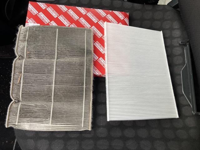

Update: Having bought a new pollen filter I got the chance today to fit it...
It's hard to tell but, in case you're wondering, the new one is to the right of the photo😉
