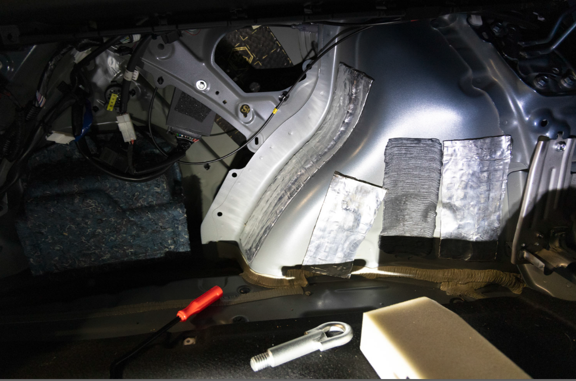

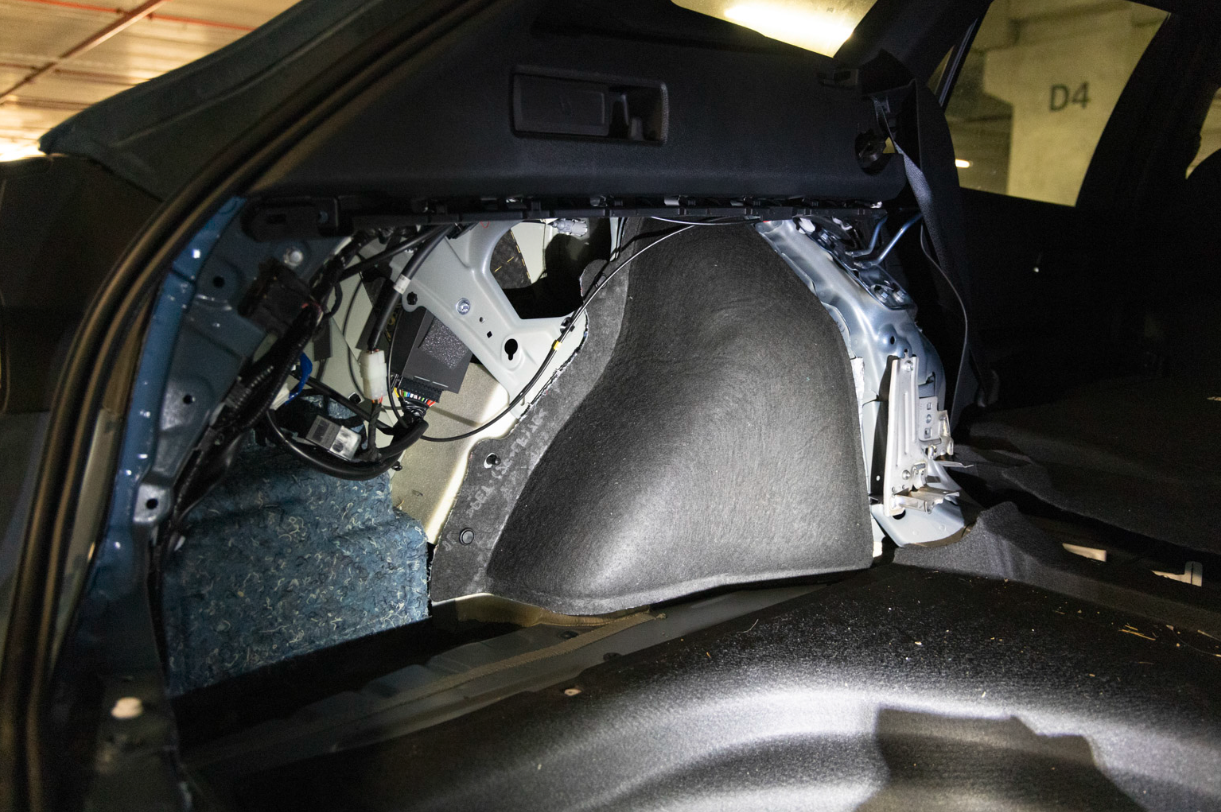

I am slowly getting into this project. During the weekend, I had some time (and two butyl sound deadening samples), so I took the plunge and remove left side of the boot trim in my TS. This is how it looks like:
Wheel arch is covered by cca 5mm foam/felt type sound absorbing material. There is also a sound absorbing "sponge" located behind a rear wheel arch. And sound absorbing felt is covering the ventilation holes.
I put some sound deadening material on the rear quarter panel and also on the rear wheel arches. Quarter panel does definitely now sound more dead, but for the wheel arch the difference was not that big. If you taped it before, it did have some resonance, but it is fairly high frequency. After I added sound deadening material, the difference was not that big. It looks like the factory spray on material does a fairly good job at managing lower frequency resonances.

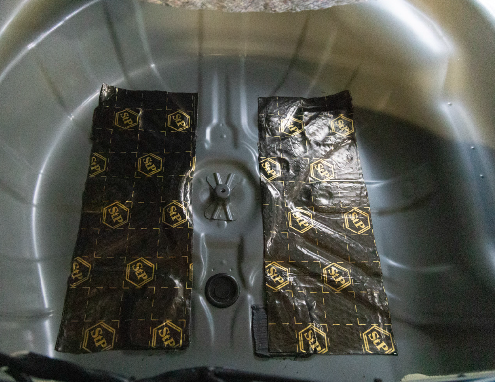

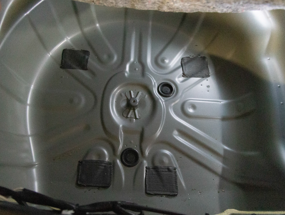

I also put butyl mats in the spare wheel opening:
before:
after:
With a knock test, this part now feels noticeably more damped, but if it will actually translate to quieter ride, we will see. I hope that it will at least reduce a bit the loud "ping" noise, when you ride over a dilatation on the motorway. It is quite intrusive.

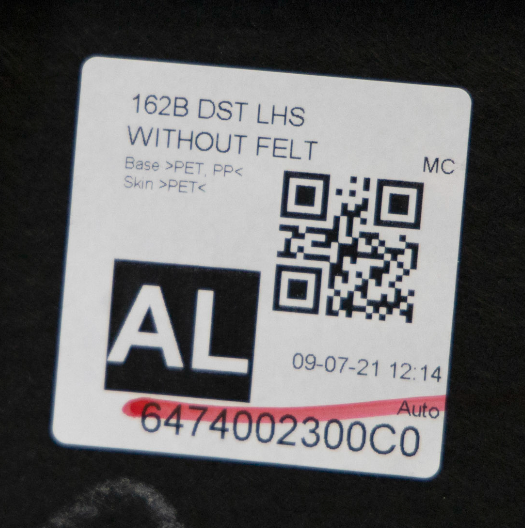

When I removed this part of the trim, it had a sticker on it:
It would imply, that the same part with the felt exists and probably for a reason. But due to reducing cost and weight, some cars don't have it (maybe all?). Next step is to get some sound deadening foam, felt or maybe eve sound absorbing thinsulate and better insulate this part of the car. I will probably stuff something behind the quarter panel, stick some felt on the trim and also try to put some material in the vicinity of the vent, to absorb as much sound as possible. The good thing is, that sound absorption material is usually not as heavy as a sound deadening or sound blocking material.  🙂
