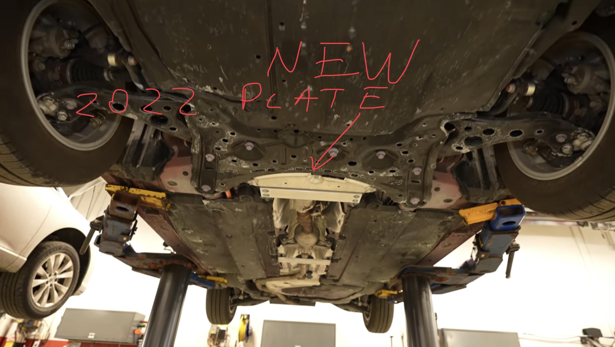

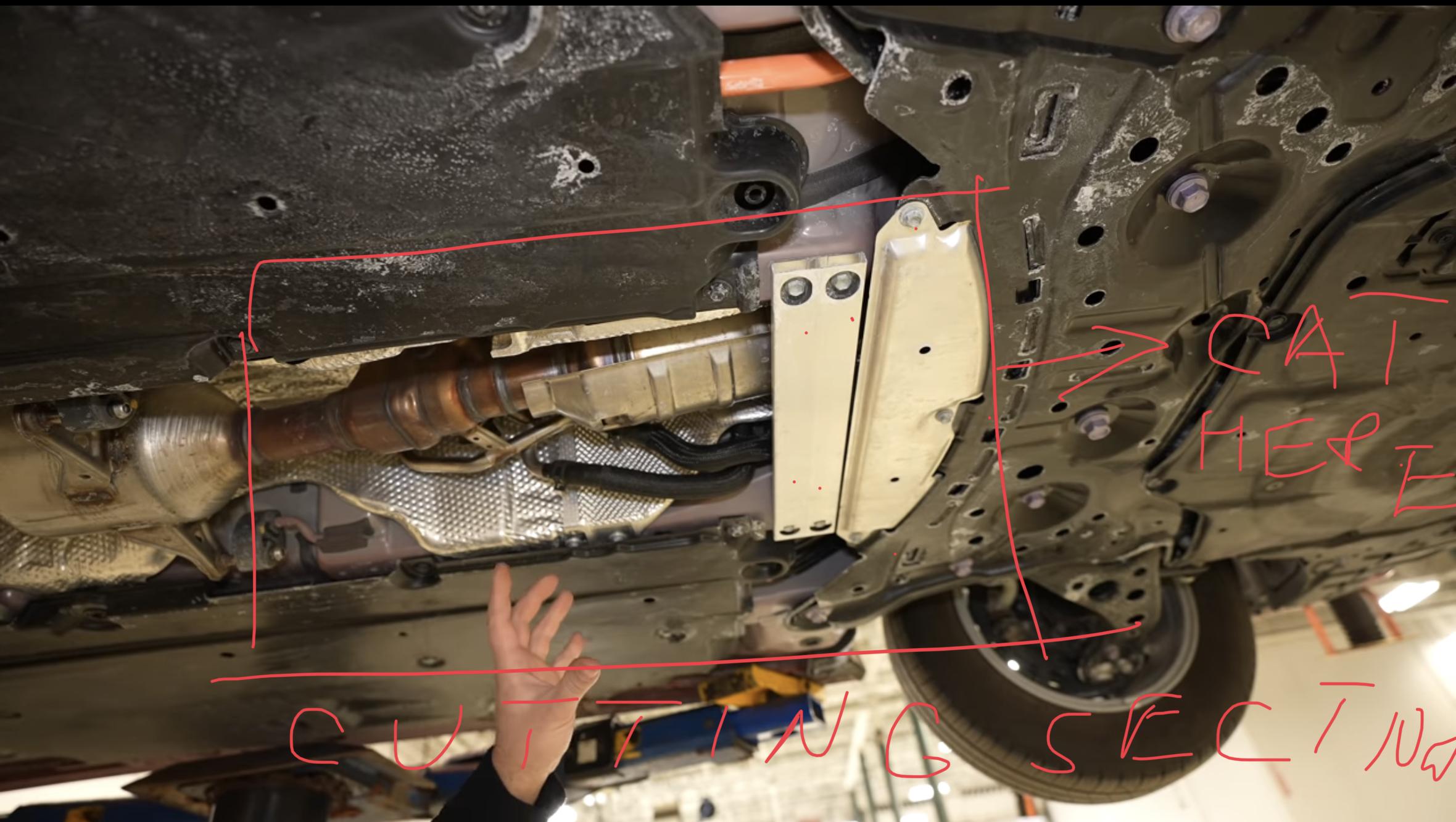

Ok, the cat’s  on Corolla 2019-> onwards are placed close to the engine and are indeed part of the exhaust manifold, more difficult to cut and take away, however there is a second cat just under the car similar to Auris and Prius from 2010 and so thieves still cutting those, it may not worth to them anything but the problem they will create to the car owners is exactly the same as if any of the exhaust pipes and cats been cut off the car the entire exhaust needs to be replaced no matter if the cat is still attached to the engine.! In general there is decline in cat thefts, plus Toyota now adds on a thicker metal plate on the opening under the cats but it is not as big as should be and it is attached with 4 bolts, easily undo. Also newer Toyota comes without hybrid badges. Anyway, there is always a risk of getting your cat stolen if you are an owner of Toyota hybrid, however it is not as bad as before, and newer cars are less affected. We had a case reported in the forum on brand new Toyota Corolla hybrid second cat stolen , I have picture from the posts but finding a posts here is difficult, if you would like to research you may find the post and read through. 👍 Toyota hybrids are the best choice for cars with ice currently and cat thefts should not stop any new customers of getting one.
Regards
Both engines are exactly the same exhaust set ups. Either of these can be targeted for the second cat as the picture shows above, getting 2.0 it’s not an insurance against thefts. 👍

I remember that post
didnt they end up taking the silencer by mistake

No, it’s the second cat right after the main catalytic converter, this second one is more like particulate filter (ppf) but the thing is that whatever they cut the replacement is the entire unit that include exhaust manifold and catalytic converter, second cat and middle silencer, around £1500 bill., the rear silencer its a separate part and doesn’t need replacement but anything on the front comes as one peace and obviously the higher cost.
