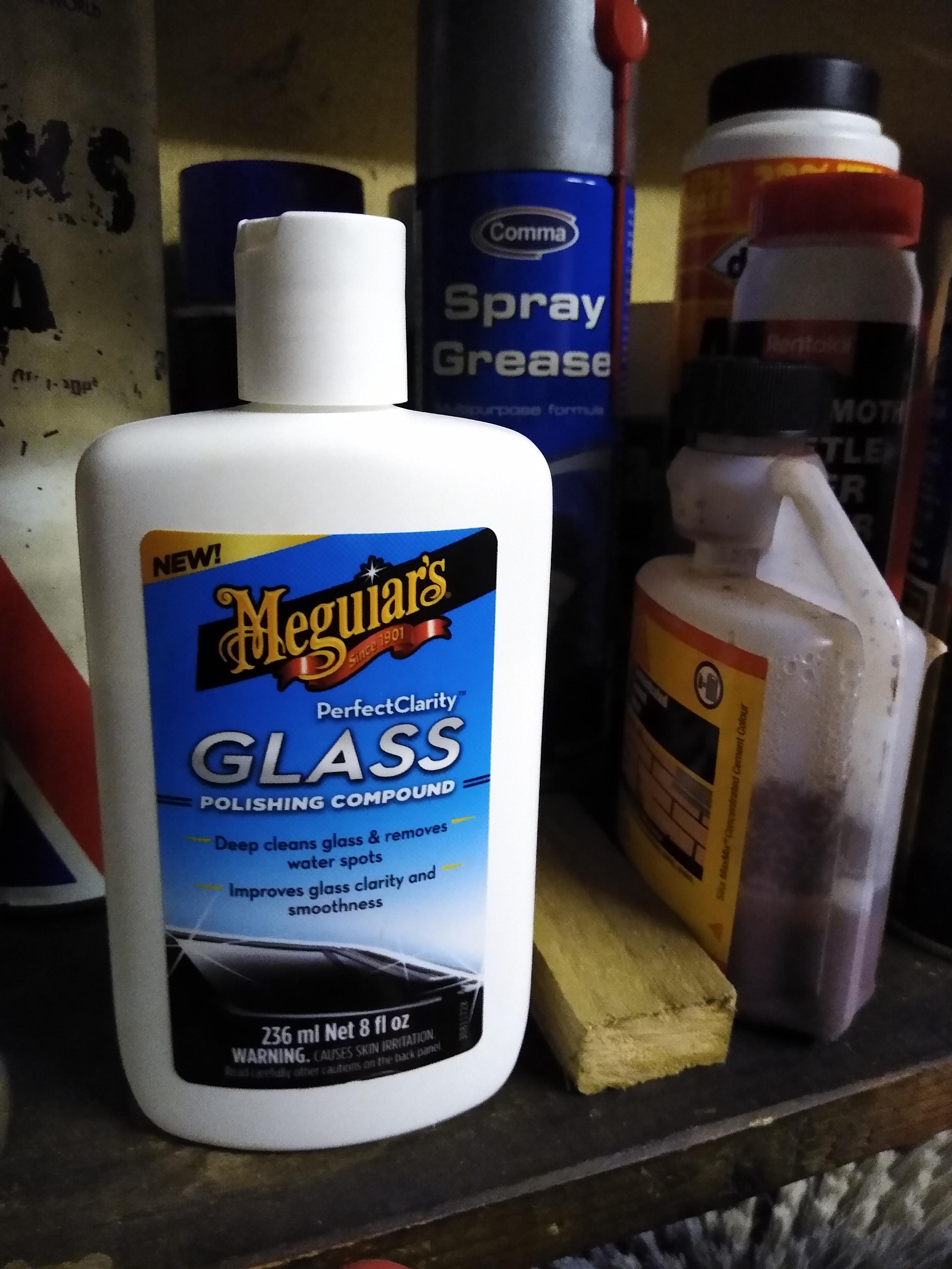

I bought this glass cleaner from Halfords the other day, not cheap at £16, but as I had tried practically everything else with no luck I thought I would give it a shot.
Guess what, it worked !!
Would certainly recommend 👍
Iain
