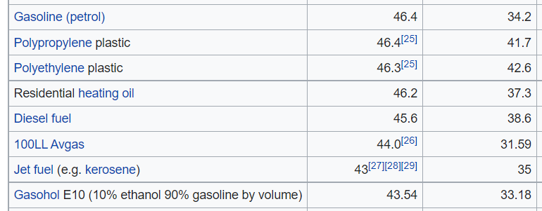

To be honest, I think the huge improvement or drop in mpg are a sort of placebe effect.
We want our car to be the very best, and putting in more expensive fuel, it better just work!!
The image shows energy content in various type of fuels. First colum is MJ pr. kg, and the second colum is MJ pr. litre.
Notice the difference between raw gasoline and E10. E5 must be right in the middle, with a estimated value of 33,7 MJ/litre, a 0,5 MJ drop compared to pure gasoline.

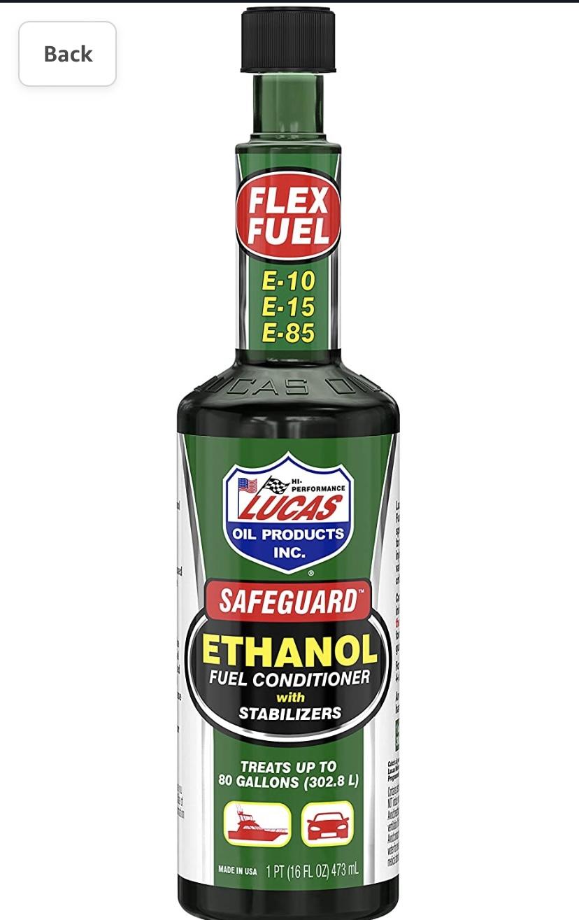

Hi Iain , yes agree upto say mid December was against e10 then prices started to increase and roughy same time I noticed this fuel treatment I researched it and gave a few bottles ago and like a say I’ve not noticed any difference in max range per tank . I get around 6 tanks out of a bottle at £7 per bottle so I’m thinking it’s cheaper

E5 is better fuel for the engine👌. No additives can make E10 as good as E5, however can improve a bit and most importantly make it safer for cars that use of E10 is questionable. A good quality E10 with additive can come close to E5 99 as consumption figures and performance but not exactly the same and I will prefer to use E5 99 over E10 95 where possible and price is similar.  In the UK at some garages like Tesco , Costco, E5 is the same or similar price to E10 from other places like Shell or BP. What have happened to diesel cars will most likely happen to electric cars since been pushed a lot by the governments., the time will show us. 👍

The Lucas additive treats approx. 300 litres so the cost is way below the difference between E5  and E10.
