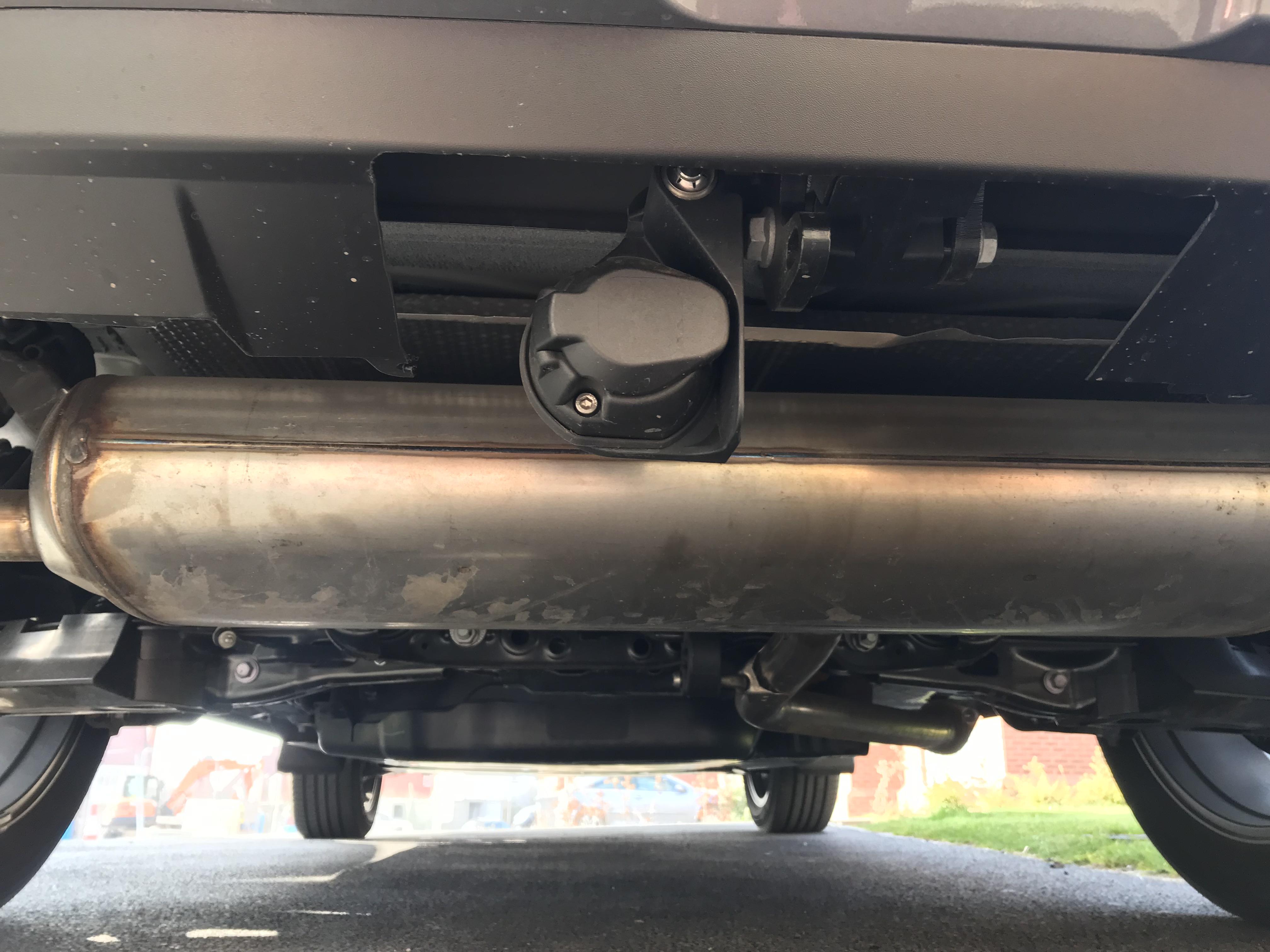

My Rav4 is leased and the towbar was part of the deal and installed during PDI. Here how it looks for vertical removable towbar

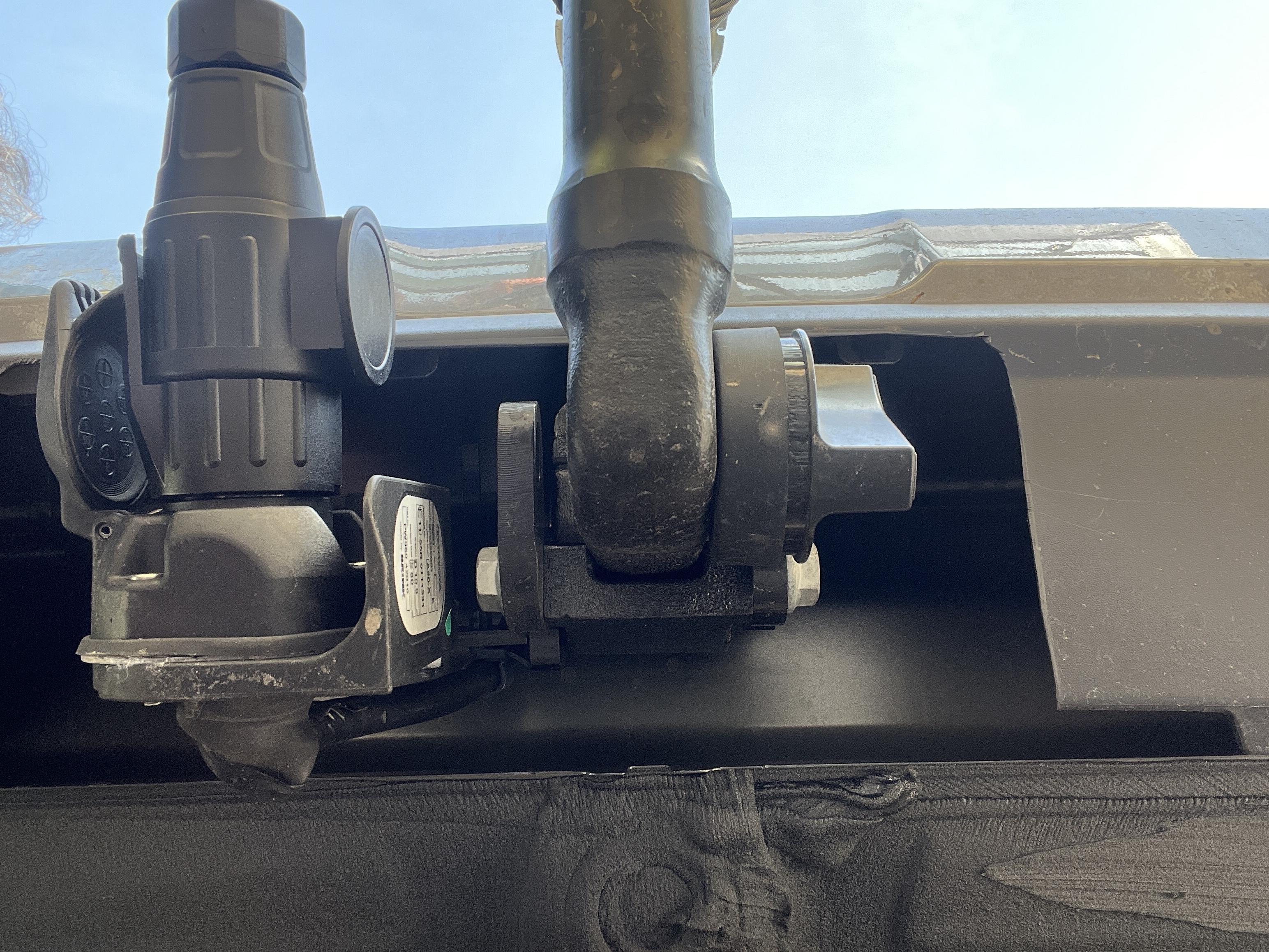

Here’s a view from the floor of my factory fitted removable vertical Toyota (Brink) towball showing the bumper cut out. The cut out is not visible unless you lie down.
