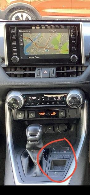

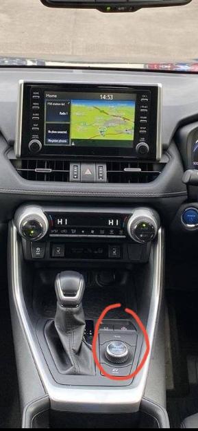

I believe that on 4WD models there is a drive mode selection wheel next to the gear stick and on 2WD models there are buttons and no whee.

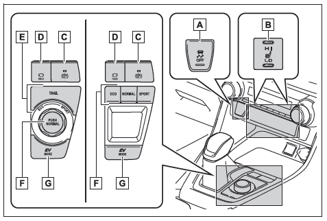

Note also that the AWD has Trail mode and the associated selector button. Trail mode is not available on the FWD.
The different layouts of the 'mode' selector buttons adjacent to the gear selector - AWD on the left; FWD on the right:
