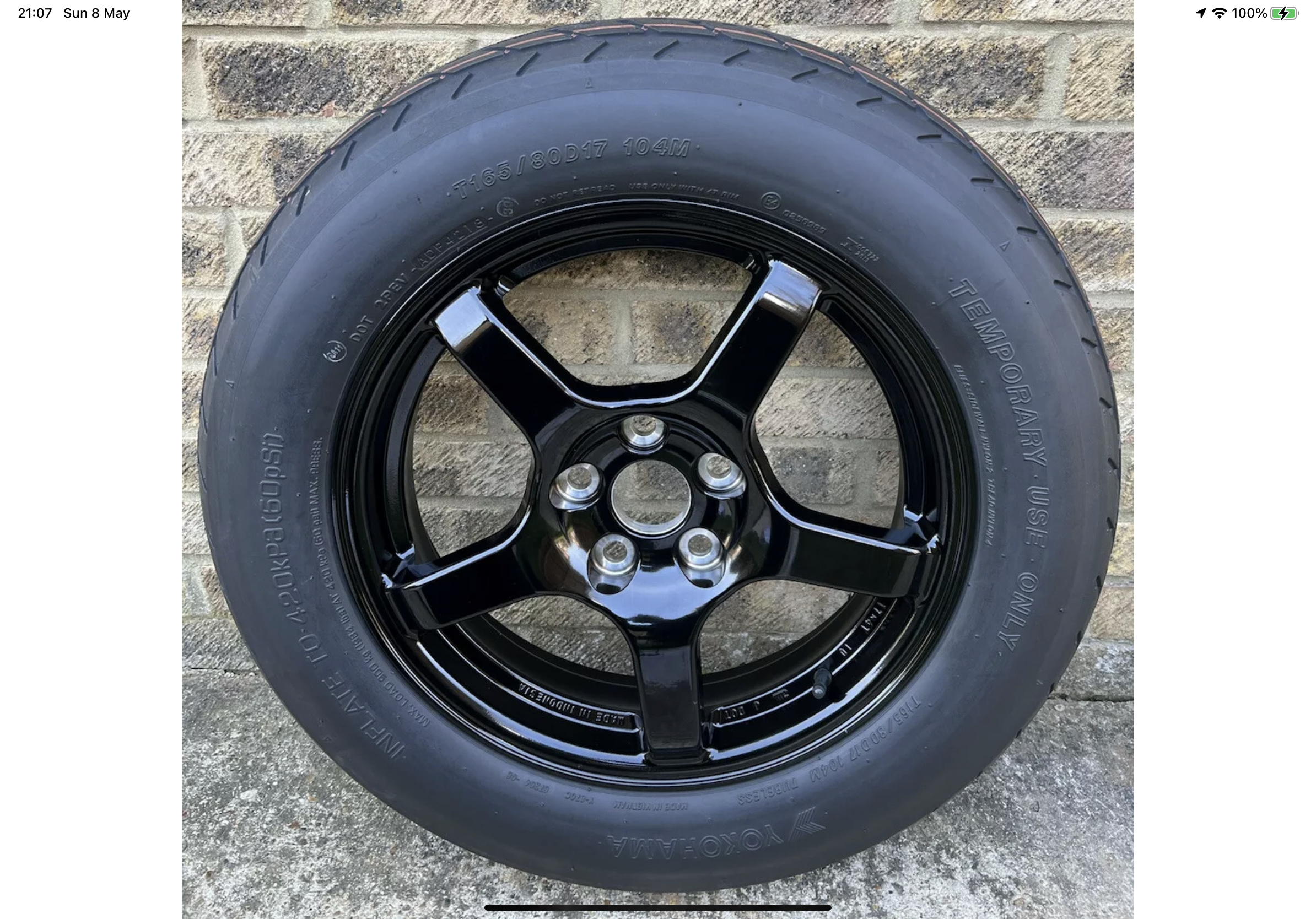

Having just passed a Mini owner trying to reflate a flat tyre with the gunk and compressor a thought occurred to me.
Whilst I, like many, have sourced a space saver (well it saves some space over a full size wheel I suppose) it occurred to me are the wheel bolts for the alloys compatible with the steel wheel.
Any one confirm this?
Cheers

My Road Hero space saver (for my PHEV) came with it's own set of bolts. Was told by the vendor they were needed. Don't know about Toyota supplied space savers as not available for the PHEV.
My space saver is a genuine Toyota part, this is also an alloy wheel so I would think my bolts should be ok, unless anyone knows any different.

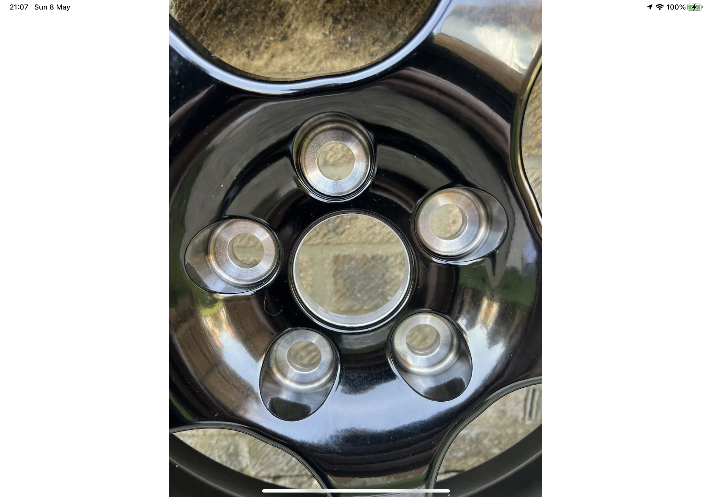

The nuts for my regular wheels have a conical base, and the face that the nuts sit against on the space saver is also conical, so without reading specifically about them… they're good to go.

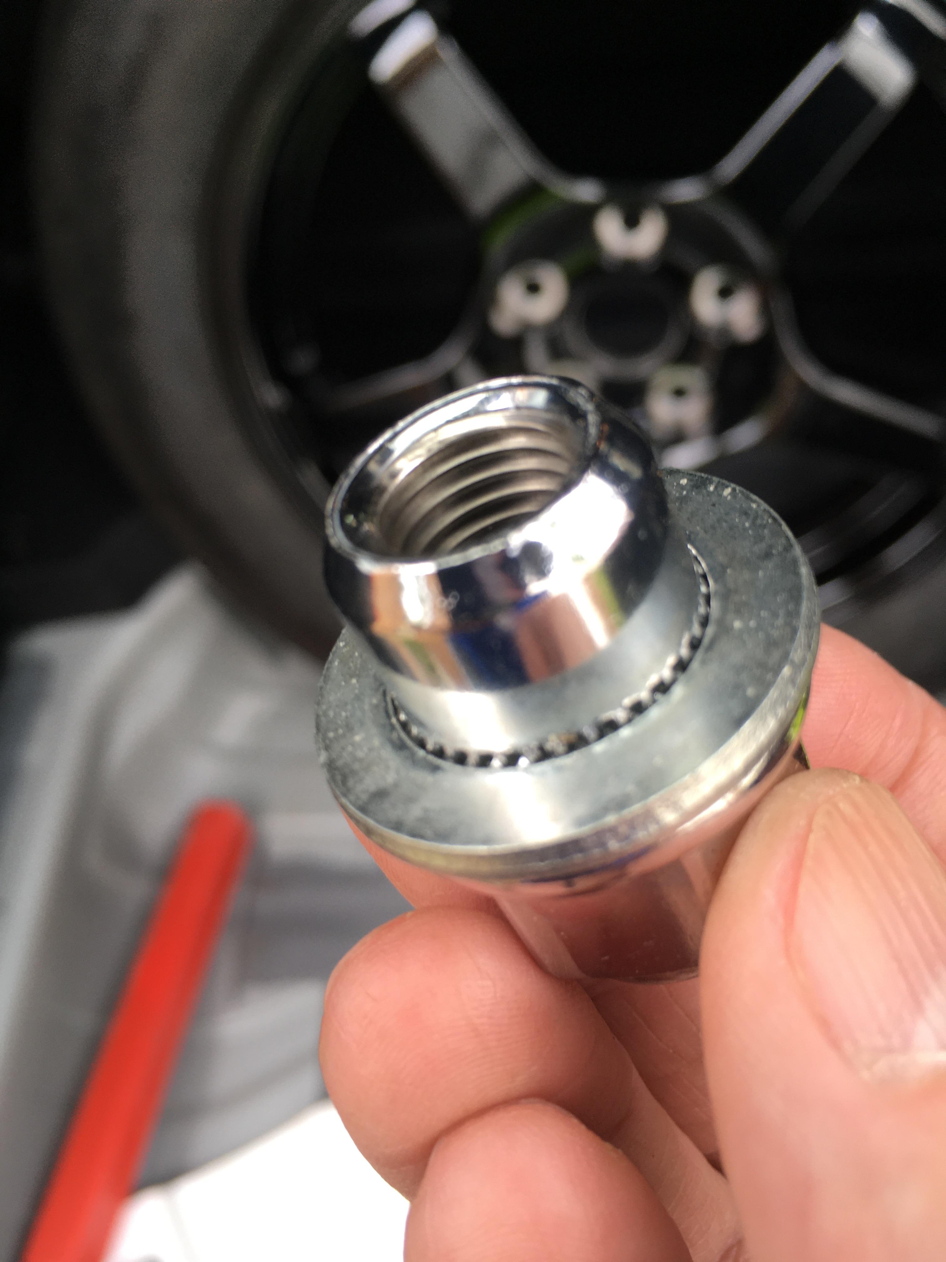

I would imagine that the steel wheel has a conical shape for the nut to seat in.
The Toyota alloys (including the genuine alloy space saver) have a flat machined mating surface and the nuts have a loose flat washer attached to prevent damage when tightening.
The nut also has a conical seat, that passes through the hole in the alloy, this may well seat correctly on a steel wheel, worth checking if you have a steel wheel before you’re stuck at the side of the road.
