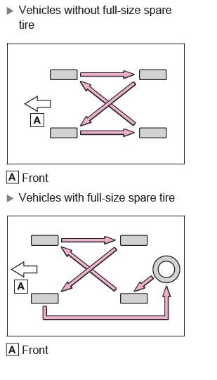

This is the recommended rotation procedure...
... which is absolutely fine for non-directional tyres.
To do this for directional tyres, one would need to remove the tyres from the rear rims and refit them the other way around. Or, as Ernie suggests, simply swap front to rear keeping the wheels on the same side of the car.
