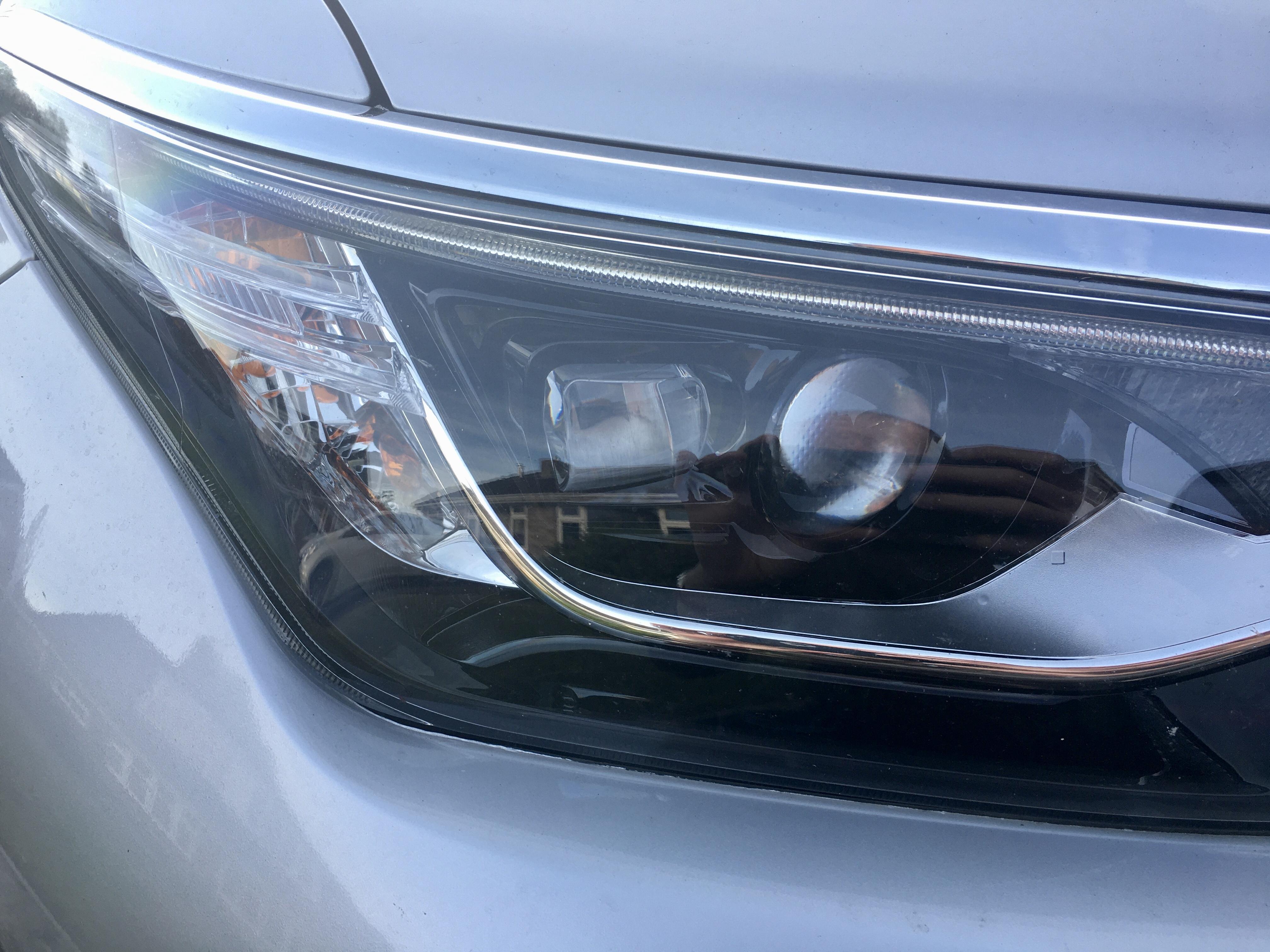

My 2016 Auris Excel hybrid hatchback has the full LED headlight system. It’s stonkingly good. Sealed units and LED’s that can’t be replaced AFAIK. Maybe worth looking into switching the whole lamp assemblies? Not sure on the wiring harnesses mods though.

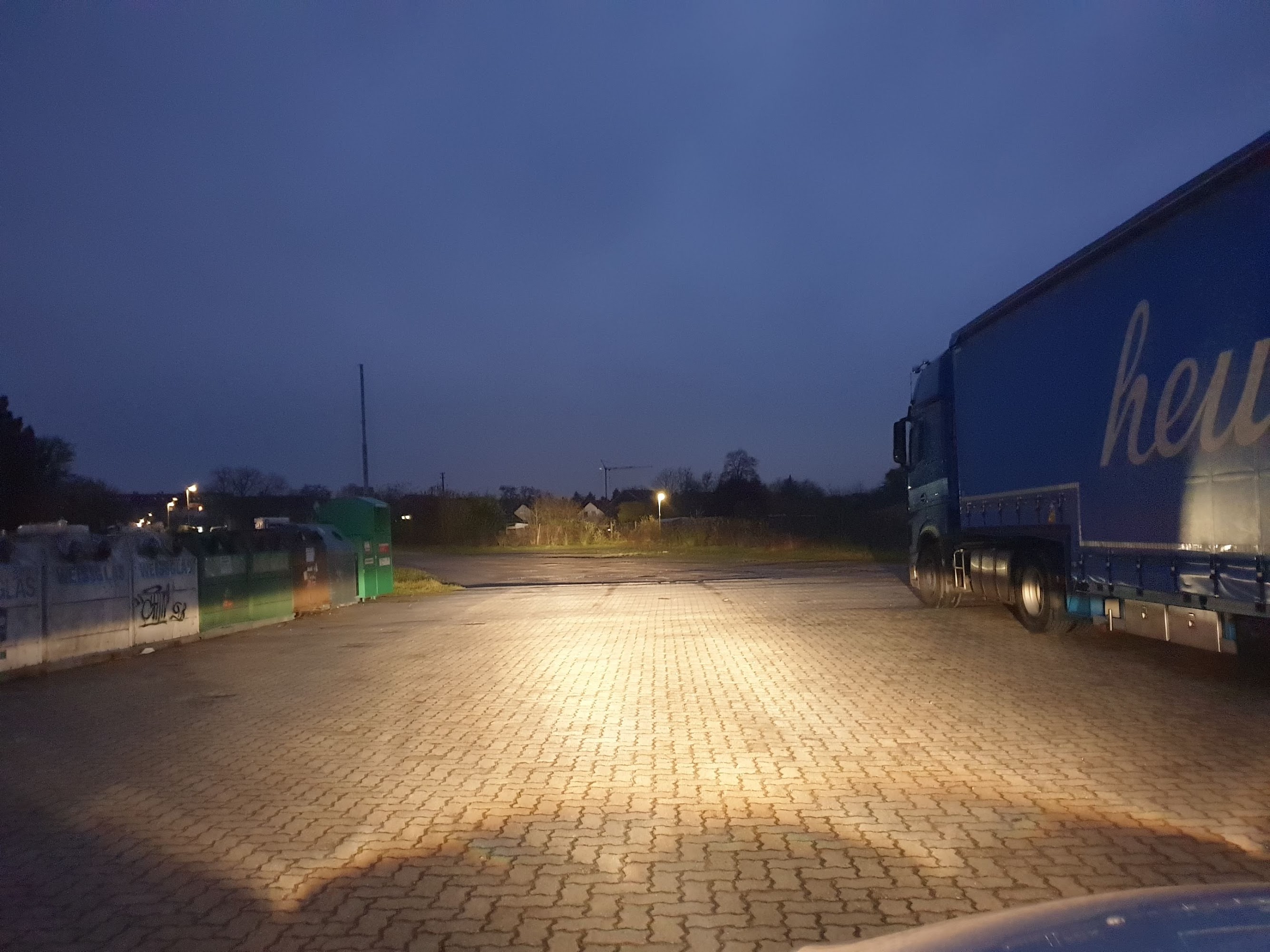

I have exactly the same model as you - albeit a 2018 version.  I fitted a pair of LED bulbs back in December 2021.  Made a vast difference to driving at night. I chose these because of a relatively modest price and a three year warranty. If you click on the 'Review' tab, you'll see my comments - I'm 'Andrew'.
autobulbsdirect.co.uk/twenty20-compact-led-bulbs-HIR2
But, bear in mind that if you fit any form LED lights, the car will technically be illegal. (It won't be 'street legal'.) It was 'E' marked with halogens, and only with halogens will it be legal. However, being pragmatic, the MoT tester didn't notice and no-one has complained or 'flashed' me because I was dazzling them.  Anyway, I recommend them!
