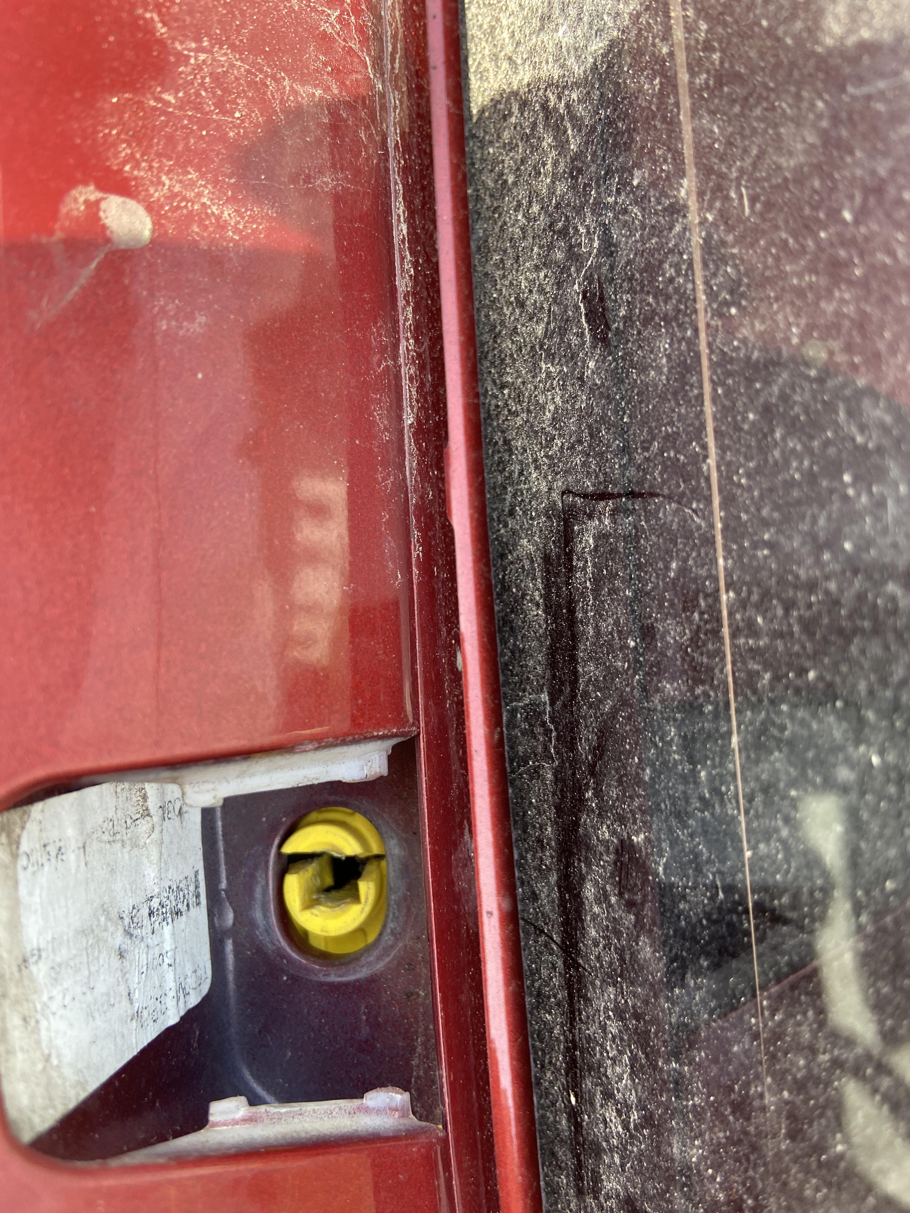

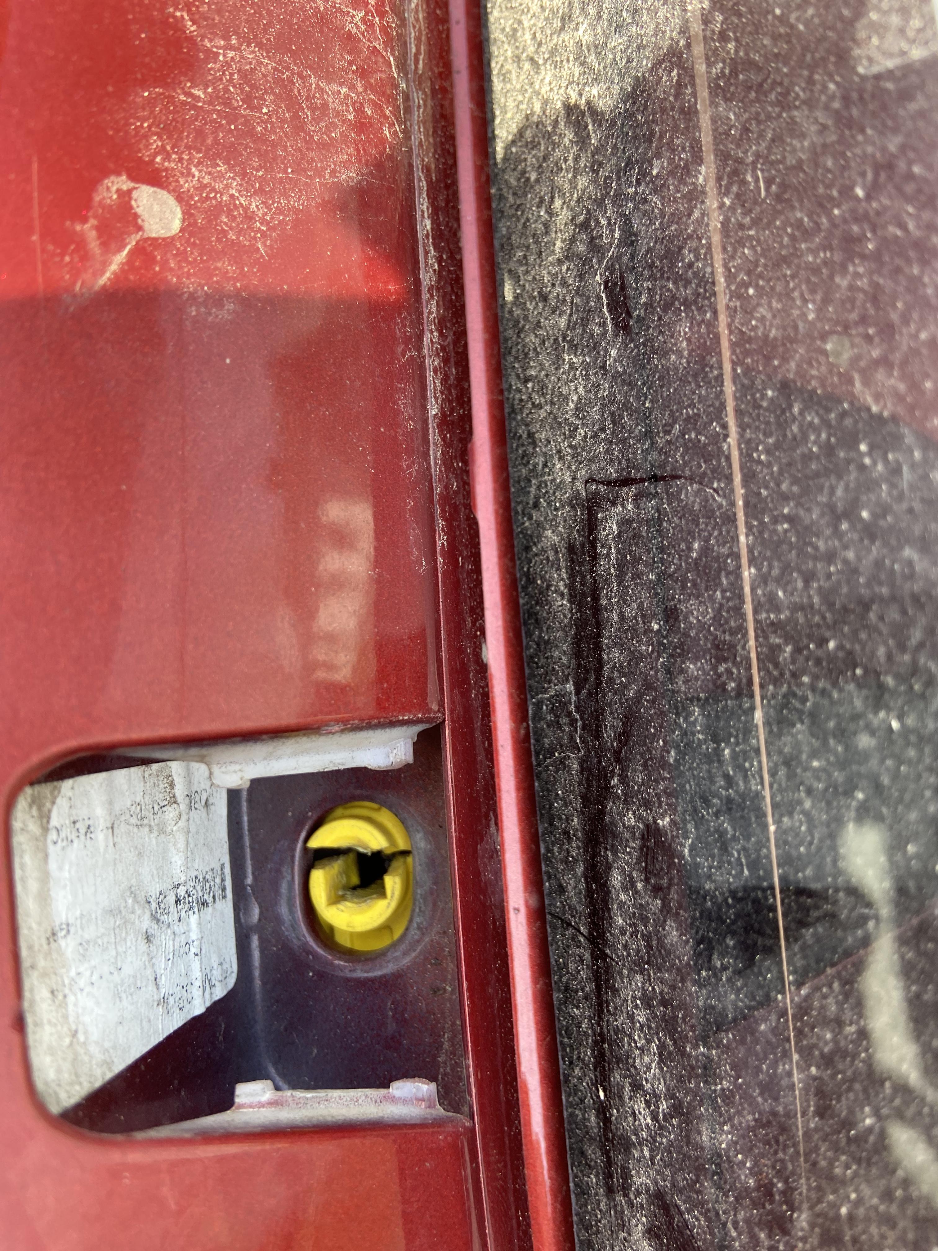

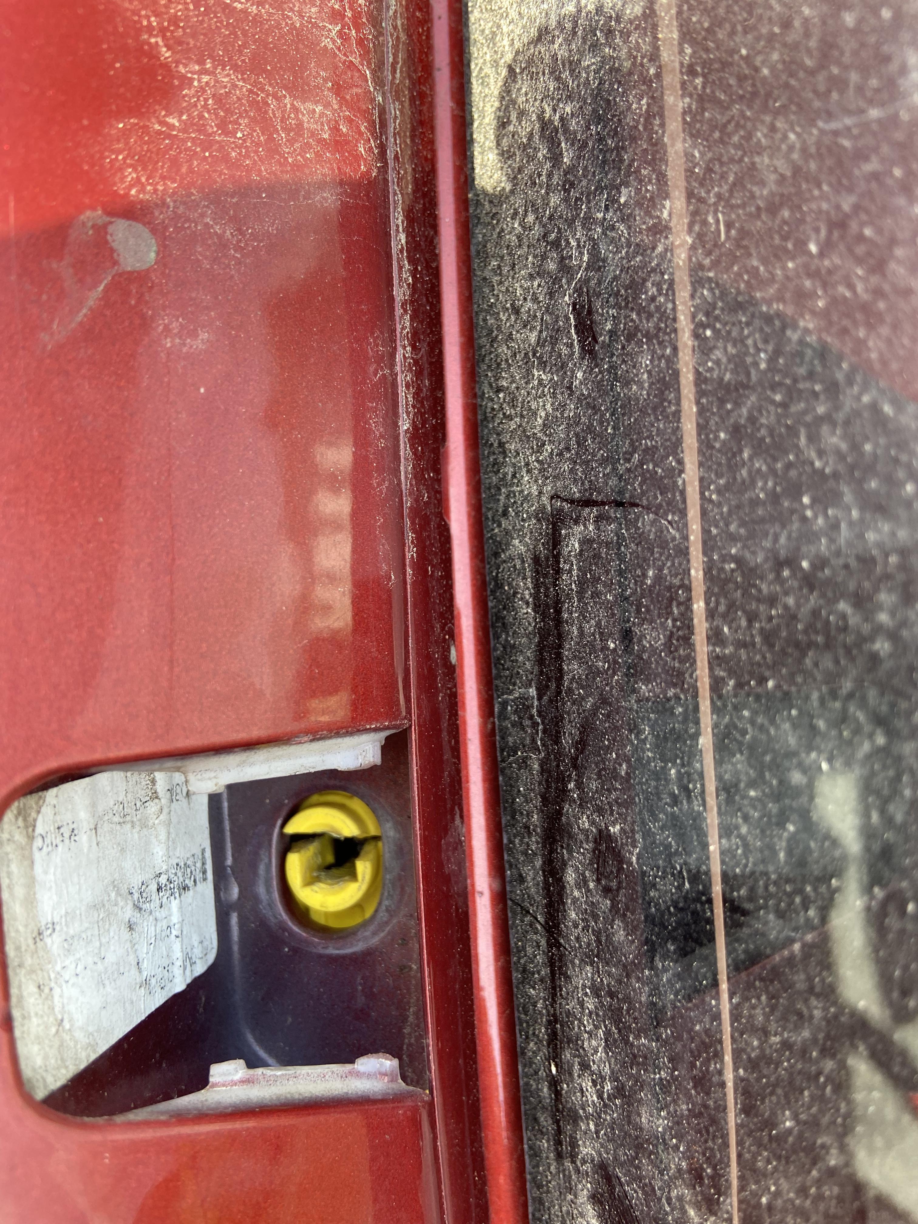

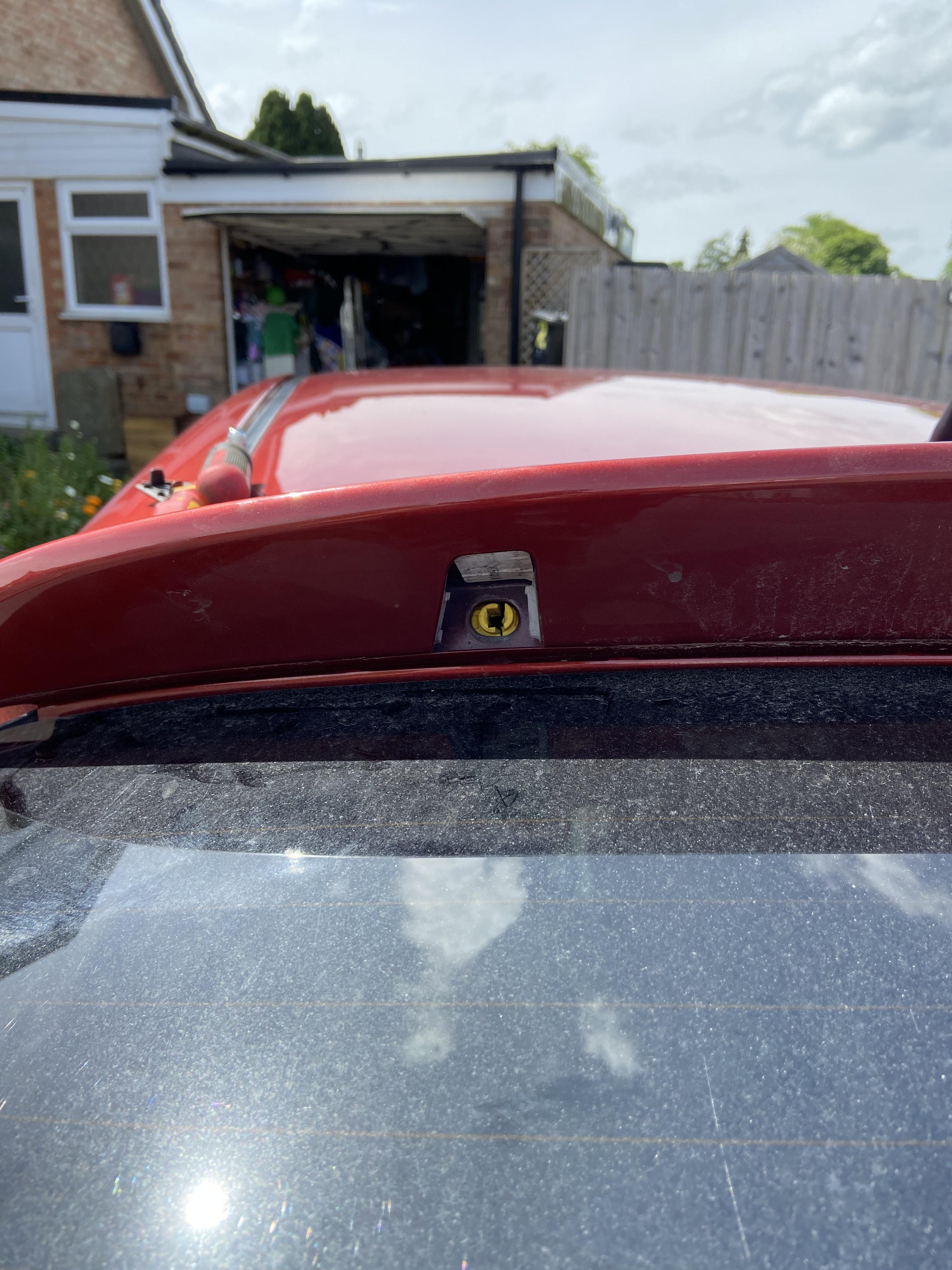

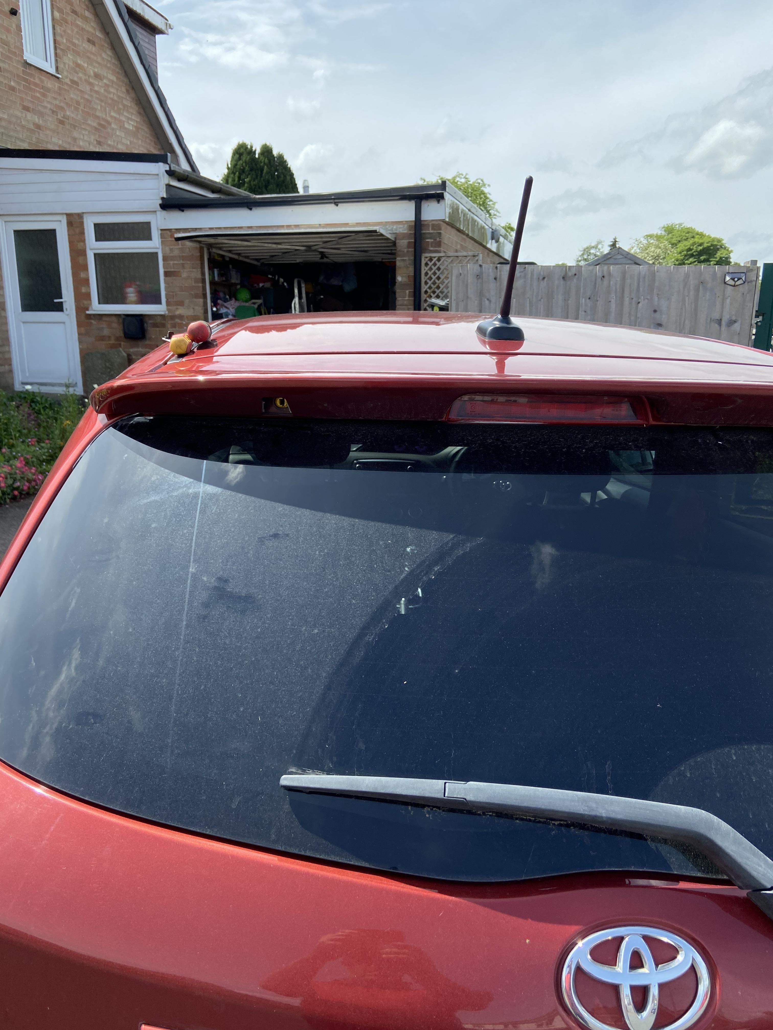

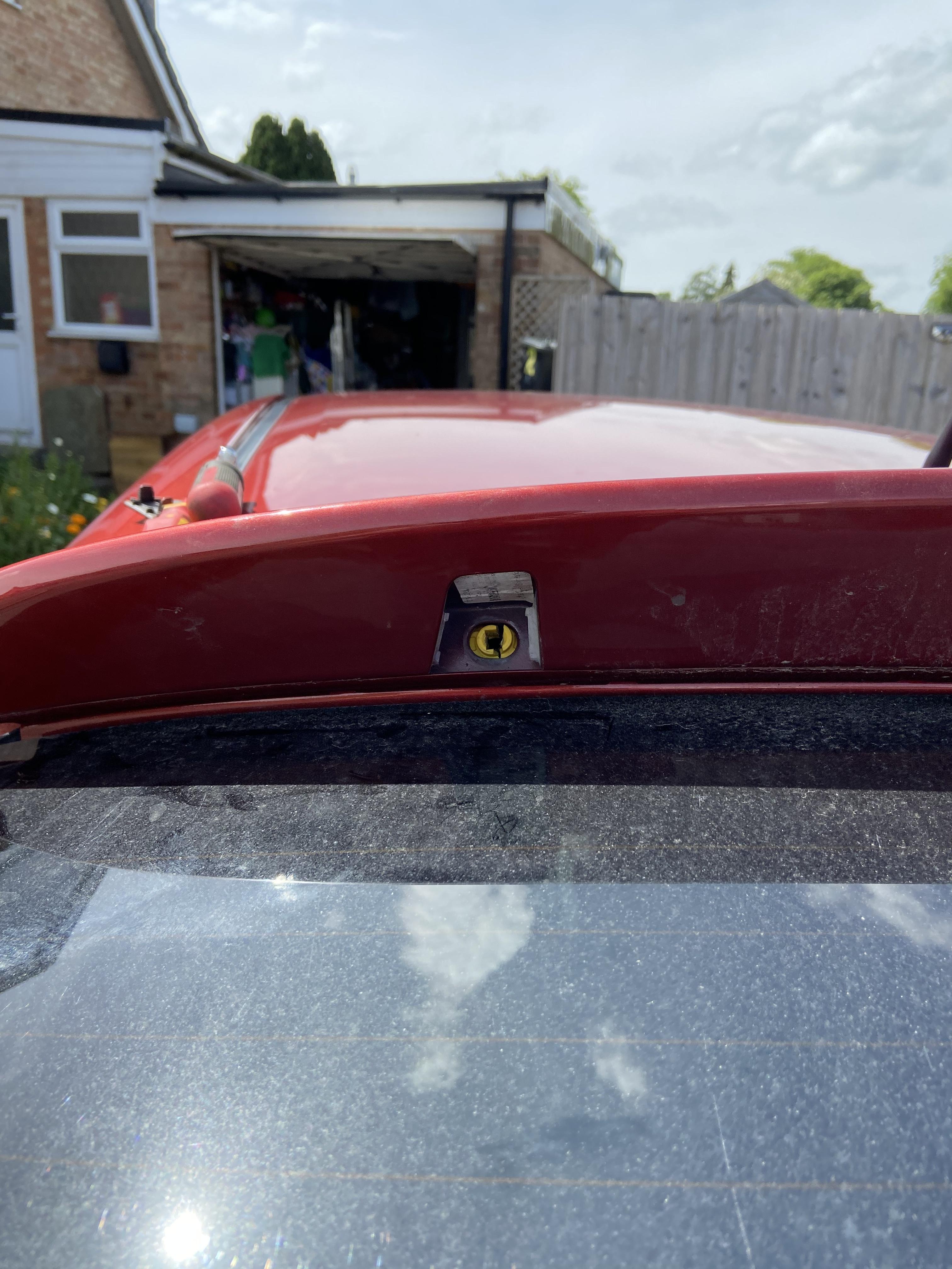

Good afternoon all. I’m new on here so please bear with me. One side of my spoiler on my Yaris sport (2014 reg)seemed to be a little loose so I had a little look at it and this is what I found when I took the screw out. The yellow clip that the screw goes into was broken. I was wondering if you can replace the clip, how to replace it and where can I get a replacement one from. The spoiler looks factory fitted.
The spoiler has been off at some point (blocked washer jet) it should be held down with 3M VHB foam tape as well as the clips and screws, take it off clean it up (sticky stuff remover and/or a Carmel wheel aka stripe removal wheel)
spoiler clip 76879-0D080
Mount 76865-0D030
That's just the plug, It's just been overtightened at some point, i take it you have the screw cover these go very brittle and the clip snaps
Mount 76865-0D030
It's a trip to the main dealer or mail order from a dealer
