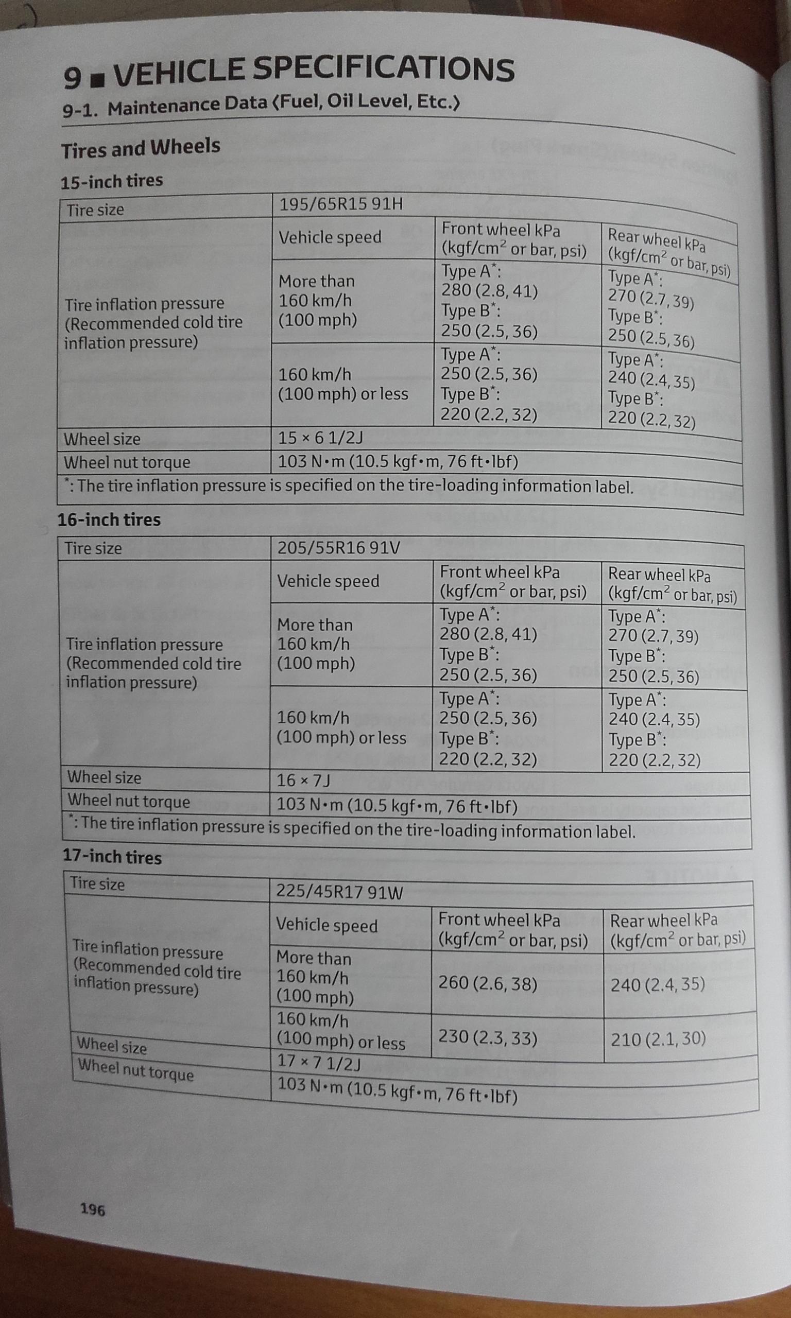

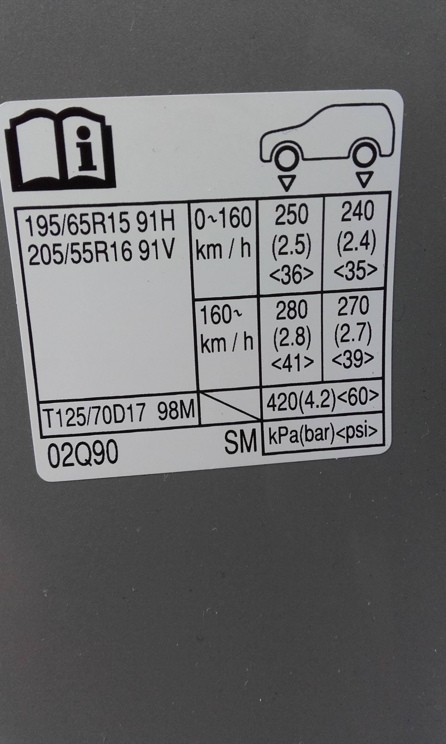

I have just got a 2020 1.8 Corolla hatchback on 16" wheels.
Tyres fitted are Continental Eco Contact 6 (205/55R16).  The owners handbook says tyre pressures should be 32/32 psi but the sticker on the door pillar says 36 front/35 rear.
Which is correct.

I've had a new 2.0 Icon Tech TS for a few months now and decided, somewhat belatedly perhaps, to check the tyre pressures. Using a digital gauge they've all come out at 40.5 whereas the door panel suggests 36 and 35 psi respectively for front/rear (up to 160mph - not sure why there's a separate suggestion for 160km/h +??!). Given the car was brand new I assume the dealer would have set the pressure correctly. My concern is that if I reduce the pressure to reflect the door panel figures, will this then trigger a low pressure warning as I assume this would have been calibrated by the dealer (or does low pressure warning only kick in at really low pressure)?

I can confirm that there are different pressures values in handbook and on the sticker. What is even more confusing, in handbook you have different tire pressure for tire type A and type B. I was trying to find what does it mean, since the handbook does not give any explanation but even Google didn't help. Any idea anybody?

Thanks for all your replies.
Attached are photos of sticker in car and handbook page. The handbook page shows two sets of figures for type A & type B tyres (or wheels ?) I have no idea what type A and type B is.
I am running my tyres on 32 psi front and rear and the ride is quite comfortable.
Thanks for the pictures. I think type A is above 100mph driving speeds and type B is below 100mph. You can play with both settings and see what works best for you. My car ( similar t9 yours but 100kg heavier) with same size tyres I set front at 2.35 and rear 2.25 bar on cold 33/32psi. Drives great , very smooth and quiet. 👍

I have just corrected mine. On the door side it was stating Front 33 and Rear 30 if speed 0-160 so I have now set mine to this.

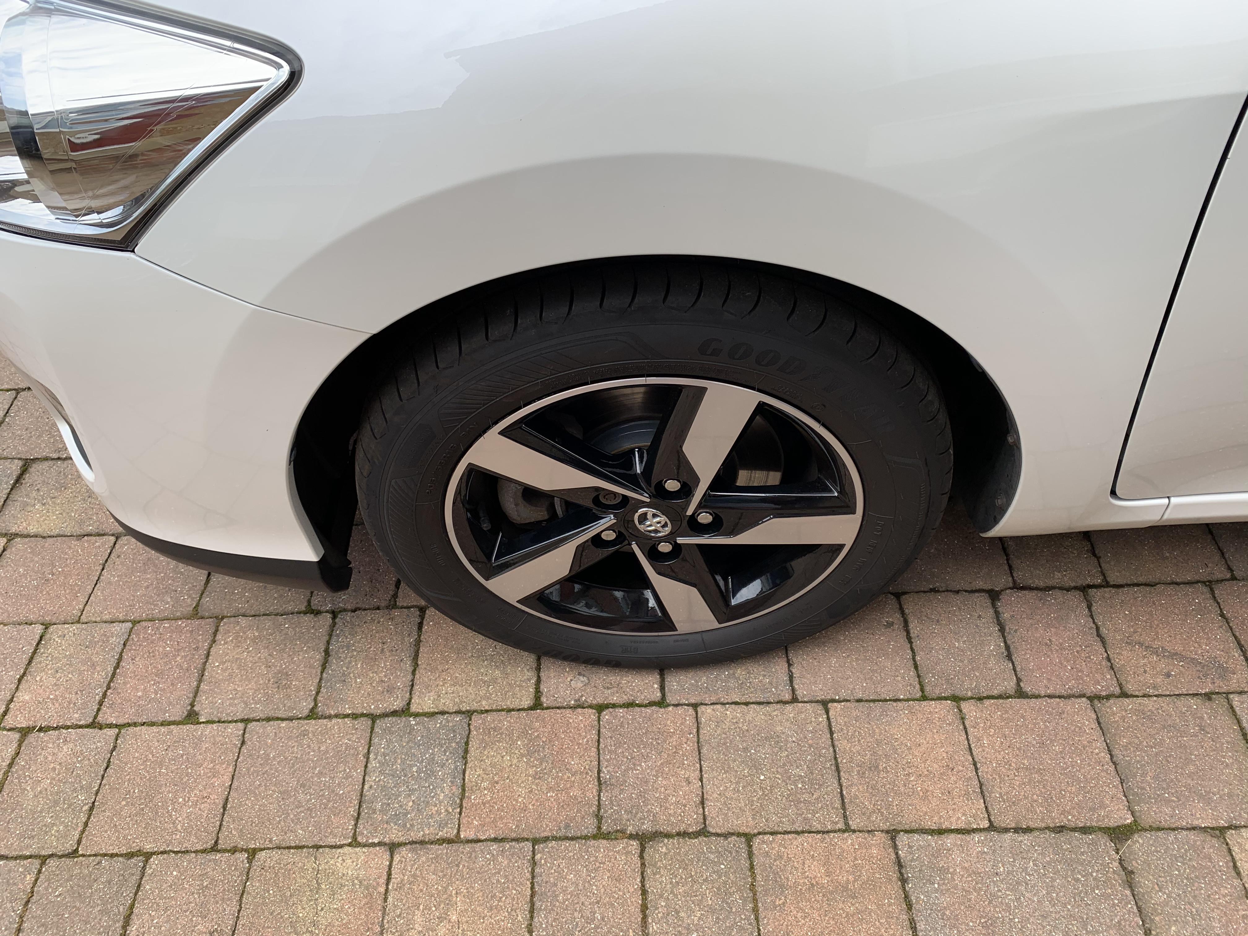

Interesting thing about the tyres, pressures and air temperatures. All of these  are constantly changing and here what I noticed on my car equipped with Goodyear efficient grip performance 2 size 205/55 16 .
I do measure and adjust pressure front 2.35 bar and rear 2.25 bar , early morning with air temperature around 12C°
The car stay parked all day on the driveway under direct sunlight, air temperature goes up to 22C° tyres perhaps to 36C° as of the sunshine ☀️.
In the evening 19:00 if I measure the pressures again they show front 2.45 bar and rear 2.35 bar, way more than what was set in the morning, however the tyres are ultra soft not only the side walls but the protector too, you can literally squeeze with fingers, the drive is very smooth, quiet and comfortable.
Later in the night 03:00 hrs the air temperature goes down to 8C° , the tyre pressure goes down to front 2.33 bar and rear 2.23 bar, the tyres look and feel similar soft on the walls but the protector now is much harder, the ride is bumpier and there is just a tiny bit more road noise.
That’s my experience from monitoring my car tyres and pressure and how they behave in different temperatures.

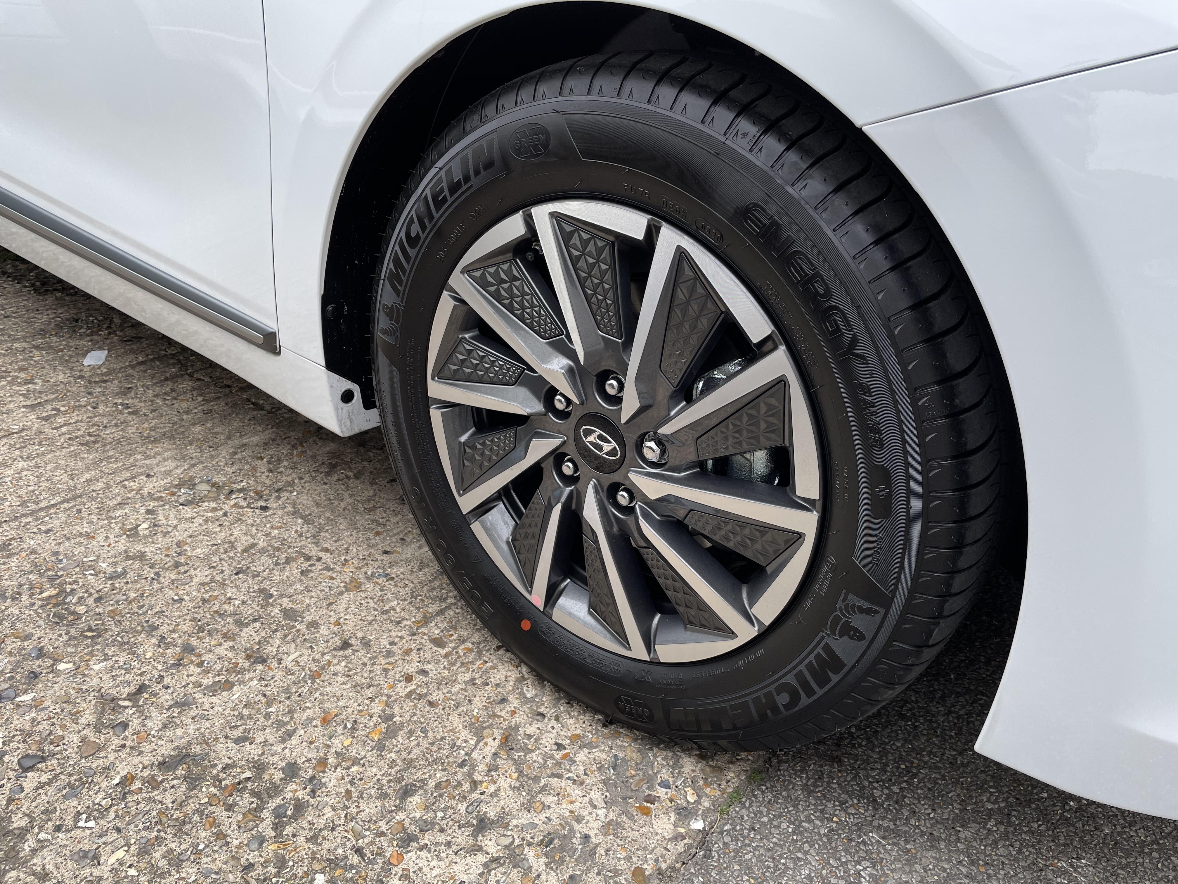

Performance remains unaffected, these tyres are very good indeed. Comparison to my gf car Michelin energy e+ size 205/60 16 my car wins for noise levels from the tyres. 🛞👌
