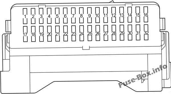

2 blown fuses , Number 5 (20 amp) and number 9 (10 amp)
I don't know whose idea it was to put the fusebox under the glovebox but what a PITA to get to
Did you drill the rivets out ? You may have hit the loom in the door not knowing it - something you need to check before any moisture gets in
5. 20 amp door lock power
9. 10 amp Back door lock power
https://knigaproavto.ru/shemy/en/toyota/corolla/527-2013-2018-toyota-corolla-and-auris-fuse-box-diagram.html

Loom doesn't pass behind the rivets so luckily no drilled wires.
If you look at the post above yours you'll see I fixed it and it was both those fuses you mention
