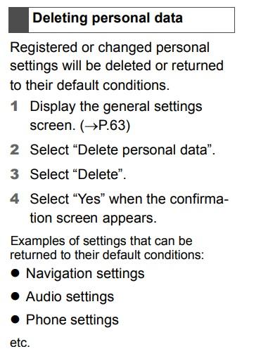

In settings, there is an option to delete user details.
Does deleting allow you to only remove certain items or does it wipe everything?

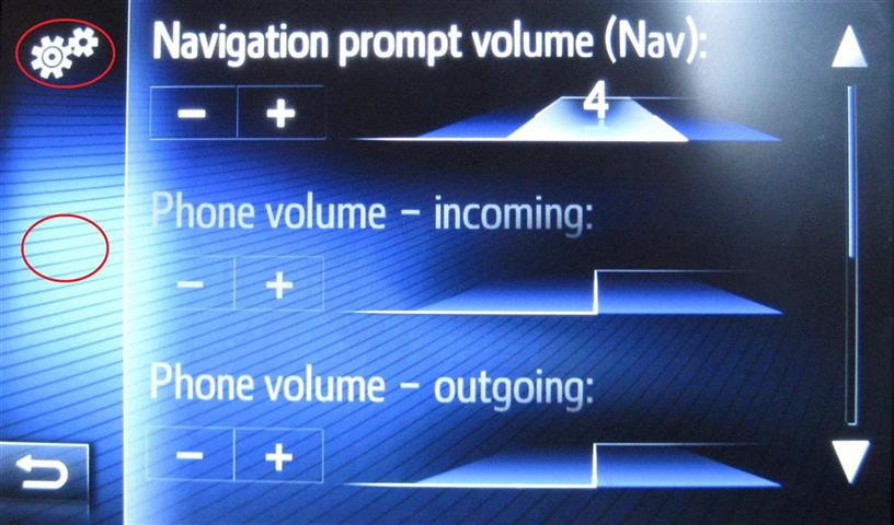

if you want to reset and remove all the previous owner's information from the nav you need to go into the 2nd hidden service menu
Access to the nav service menu.
Settings (button) - General - Volume
Press middle - top, middle - top, middle - middle, top  *as circled*
tap System commands - Set Factory Defaults

Top as in where the cogs are or another spot?
