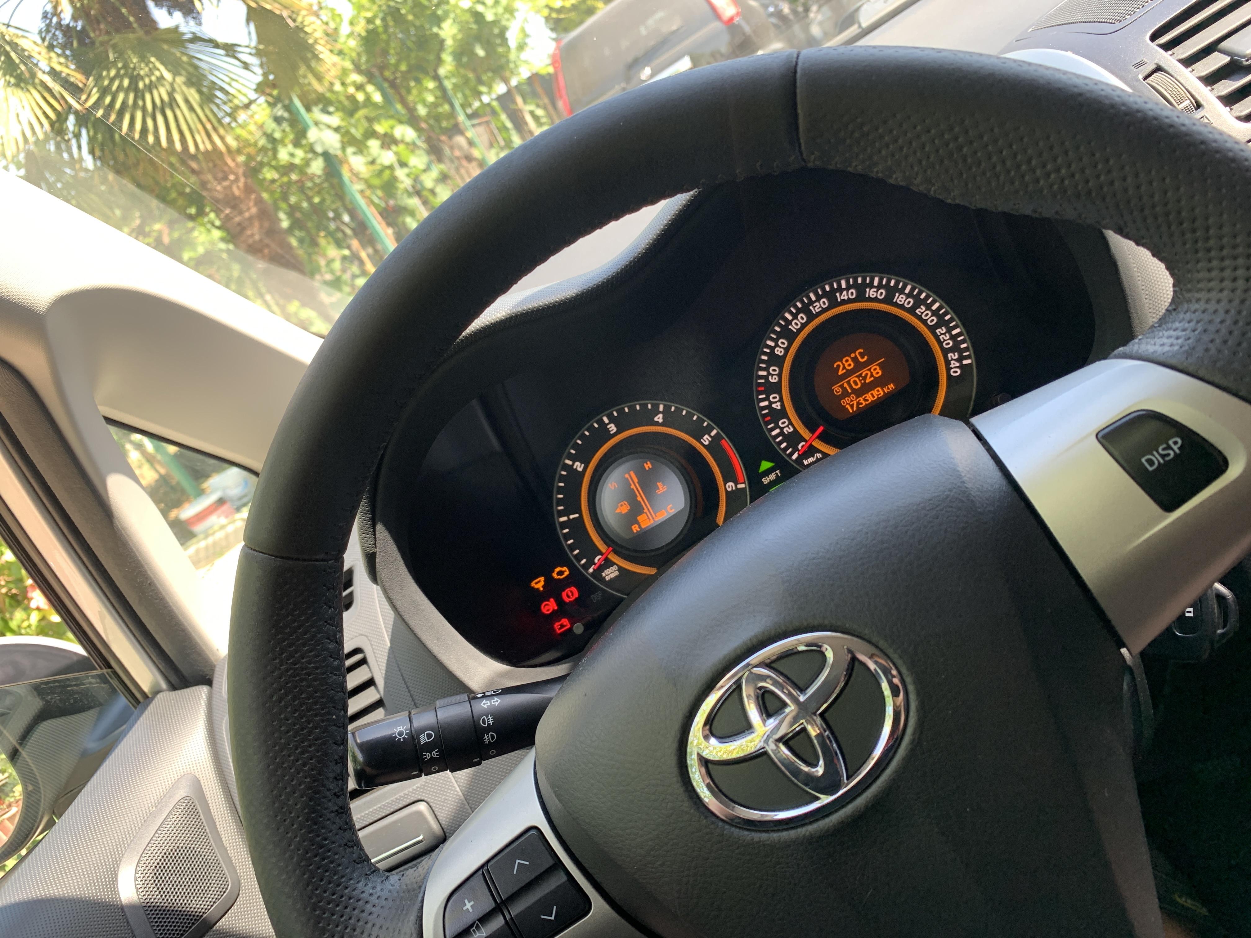

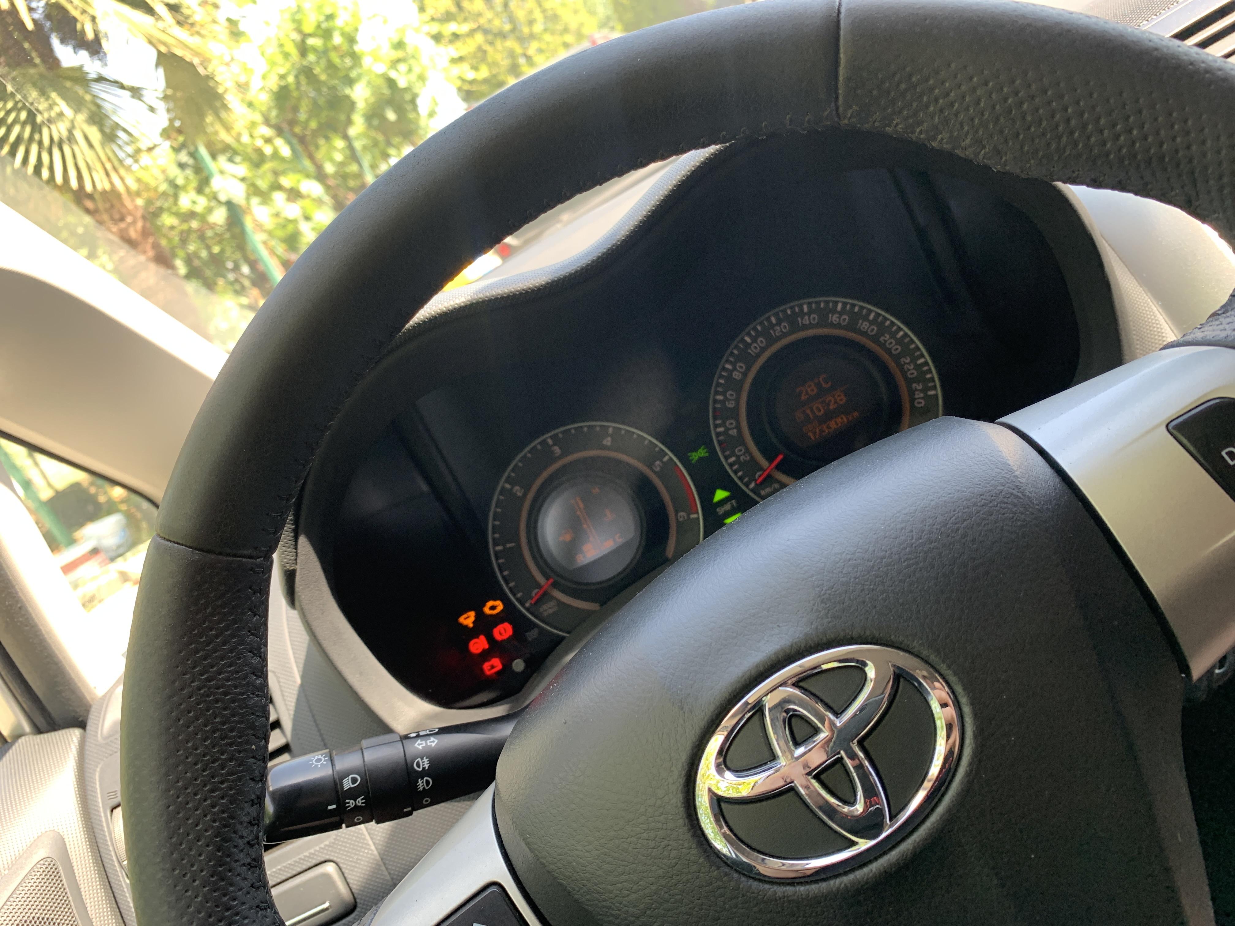

I recently had my 2010 Toyota Auris 1.4 D4D detailed by a proffesional. But now when the lights are off the Display is very bright, but when i turn on the lights (headlamps) the brightness on the display drops very low. When i got my car back the date and time were reset which means they must have unplugged and plugged back the Battery. I have also attached 2 pictures for you to understand what I mean. What causes this? Is this an option in the toyota for the brightness to go down or is there something wrong with the Battery and I need to check it ? Thank you for your time
The dash lights will be dimmable but only when the lights are on, it seems yours has been set too dim for you.  You need to find that setting and change it to how you like it.  Im not familiar with your particular car but I’m sure the owners book will tell you how.  Hope this helps 🙂
As Alan suggests, look in your driver's handbook. Whether it's the same as a 2010 D4D Yaris I owned, no idea?
On that, can't fully remember, lights on and display brightness was adjustable using one of the pushes protruding throught the display cover. i.e. clock adjust, trip adjust?

Are there two instrument brightness settings? One for lights off and one for lights on? Mine does. I can set them independently.
That’s interesting, I think Auris mk1 might have been the same as yours. Once set up with lights off as you like and then repeat with lights on as you like. Thanks for the tip 👍👌
The first generation Auris (2007-2012) is different to the second generation (2012-2018).
With the headlight switch turned on, press the button to the right hand of the instrument cluster until you see a graphic showing an illuminated bulb and one or more bars. Pressing and holding the button will scroll through a series of bars (1-5 increasing in height) - release when the desired brightness is achieved. The higher the bar the brighter the instrument illumination).
Yeah it's really clunky how to set the brightness on a lot of Toyotas from that era! Thankfully you usually only have to do it once!
It should default to max bright with the side/headlights off and minimum with them on, but that might vary between different cars; Was the case with my Mk1 and Mk2...
